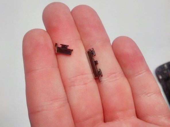

    • Take note that once the inner back cover is removed the volume and power buttons on the side can easily fall out or be removed.
  5. Motorola Moto G 1st Generation Power and Volume Buttons Replacement, Locating the Buttons: crwdns2935265:05crwdnd2935265:01crwdnd2935265:01crwdne2935265:0
    • The buttons are extremely easy to replace and may fall out when opening the phone.
    • They are located on the left side when the front plate is facing down.
  6. Motorola Moto G 1st Generation Power and Volume Buttons Replacement, Removing the Buttons: crwdns2935265:06crwdnd2935265:01crwdnd2935265:02crwdne2935265:0 Motorola Moto G 1st Generation Power and Volume Buttons Replacement, Removing the Buttons: crwdns2935265:06crwdnd2935265:02crwdnd2935265:02crwdne2935265:0
    • Use a tool or your fingers to gently lift the button out of its socket.
    • To replace, line the new button up in the socket and press down.
    • The buttons are not secured in anyway, so securing the back inner cover before turning the device over or jostling the device is a good idea. This will ensure buttons stay in place.
