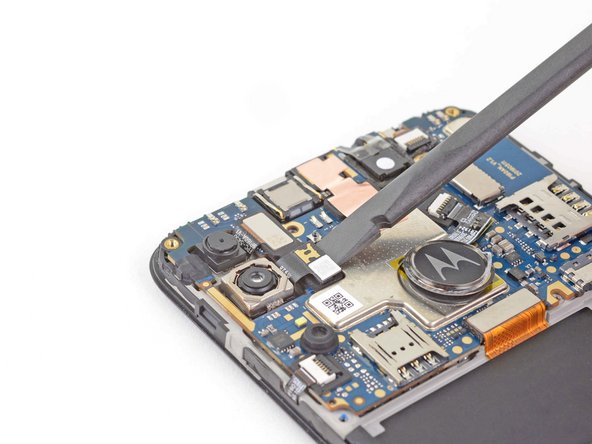

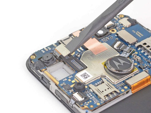

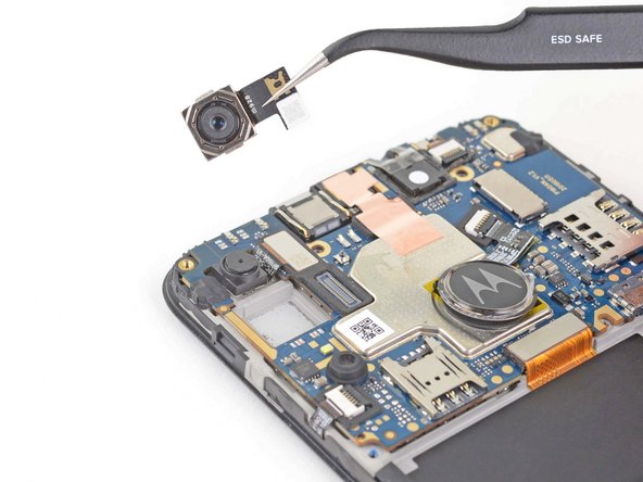

  18. Motorola Moto E6 Plus Rear Cameras Replacement, Remove the rear cameras: crwdns2935265:018crwdnd2935265:01crwdnd2935265:03crwdne2935265:0 Motorola Moto E6 Plus Rear Cameras Replacement, Remove the rear cameras: crwdns2935265:018crwdnd2935265:02crwdnd2935265:03crwdne2935265:0 Motorola Moto E6 Plus Rear Cameras Replacement, Remove the rear cameras: crwdns2935265:018crwdnd2935265:03crwdnd2935265:03crwdne2935265:0
    • Use the flat end of a spudger to disconnect the rear camera from the motherboard by lifting straight up on the press connector.
    • Remove the rear camera.

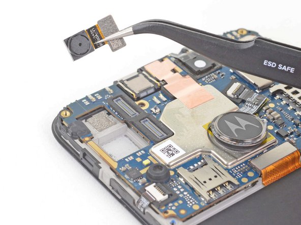

  19. Motorola Moto E6 Plus Rear Cameras Replacement: crwdns2935265:019crwdnd2935265:01crwdnd2935265:03crwdne2935265:0 Motorola Moto E6 Plus Rear Cameras Replacement: crwdns2935265:019crwdnd2935265:02crwdnd2935265:03crwdne2935265:0 Motorola Moto E6 Plus Rear Cameras Replacement: crwdns2935265:019crwdnd2935265:03crwdnd2935265:03crwdne2935265:0
    • Use the flat end of a spudger to disconnect the depth information camera from the motherboard by lifting straight up on the press connector.
    • Remove the depth information camera.
