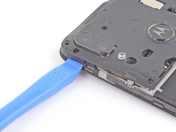

  1. Motorola Moto E6 Plus Motherboard Replacement, Unclip the back cover: crwdns2935265:01crwdnd2935265:01crwdnd2935265:02crwdne2935265:0 Motorola Moto E6 Plus Motherboard Replacement, Unclip the back cover: crwdns2935265:01crwdnd2935265:02crwdnd2935265:02crwdne2935265:0
    • Use an opening tool or your fingernail to pry the back cover away from the frame using the notch at the bottom right corner.

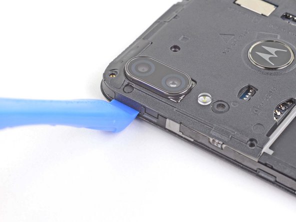

  2. Motorola Moto E6 Plus Motherboard Replacement, Unclip the right edge: crwdns2935265:02crwdnd2935265:01crwdnd2935265:03crwdne2935265:0 Motorola Moto E6 Plus Motherboard Replacement, Unclip the right edge: crwdns2935265:02crwdnd2935265:02crwdnd2935265:03crwdne2935265:0 Motorola Moto E6 Plus Motherboard Replacement, Unclip the right edge: crwdns2935265:02crwdnd2935265:03crwdnd2935265:03crwdne2935265:0
    • Use an opening tool or your fingernail to release the clips on the right edge by sliding up and around the top right corner.
  3. Motorola Moto E6 Plus Motherboard Replacement, Unclip the top edge: crwdns2935265:03crwdnd2935265:01crwdnd2935265:02crwdne2935265:0 Motorola Moto E6 Plus Motherboard Replacement, Unclip the top edge: crwdns2935265:03crwdnd2935265:02crwdnd2935265:02crwdne2935265:0
    • Continue to slide the opening tool or your fingernail across the top edge to release the clips securing the back cover to the frame.

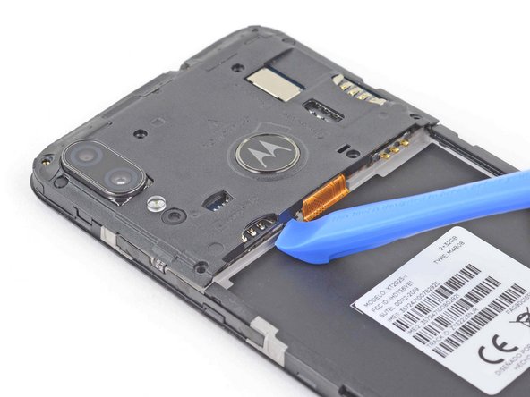

  4. Motorola Moto E6 Plus Motherboard Replacement, Unclip the left edge: crwdns2935265:04crwdnd2935265:01crwdnd2935265:02crwdne2935265:0 Motorola Moto E6 Plus Motherboard Replacement, Unclip the left edge: crwdns2935265:04crwdnd2935265:02crwdnd2935265:02crwdne2935265:0
    • Continue to slide the opening tool or your fingernail down the left edge to release the clips.

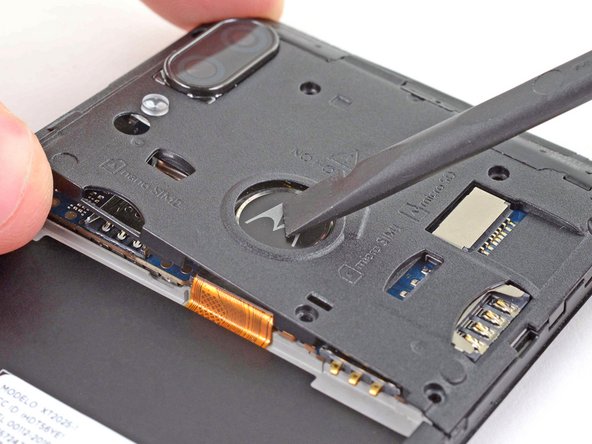

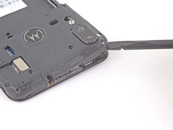

  5. Motorola Moto E6 Plus Motherboard Replacement, Remove the back cover: crwdns2935265:05crwdnd2935265:01crwdnd2935265:03crwdne2935265:0 Motorola Moto E6 Plus Motherboard Replacement, Remove the back cover: crwdns2935265:05crwdnd2935265:02crwdnd2935265:03crwdne2935265:0 Motorola Moto E6 Plus Motherboard Replacement, Remove the back cover: crwdns2935265:05crwdnd2935265:03crwdnd2935265:03crwdne2935265:0
    • Remove the back cover.

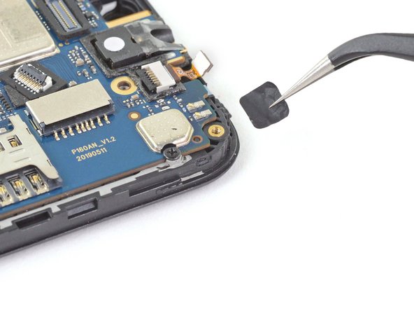

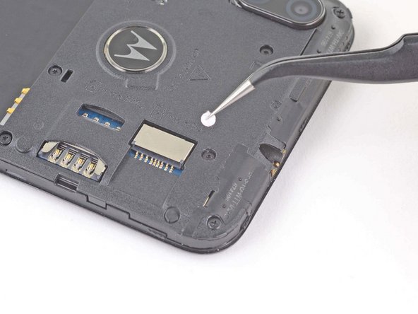

  7. Motorola Moto E6 Plus Motherboard Replacement, Remove the white sticker: crwdns2935265:07crwdnd2935265:01crwdnd2935265:02crwdne2935265:0 Motorola Moto E6 Plus Motherboard Replacement, Remove the white sticker: crwdns2935265:07crwdnd2935265:02crwdnd2935265:02crwdne2935265:0
    • Use a pair of tweezers to remove the sticker covering the screw below the audio jack port.

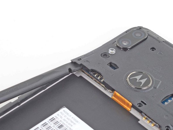

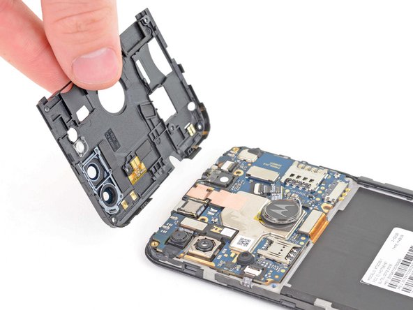

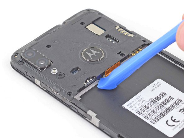

  10. Motorola Moto E6 Plus Motherboard Replacement, Pry up the motherboard cover: crwdns2935265:010crwdnd2935265:01crwdnd2935265:03crwdne2935265:0 Motorola Moto E6 Plus Motherboard Replacement, Pry up the motherboard cover: crwdns2935265:010crwdnd2935265:02crwdnd2935265:03crwdne2935265:0 Motorola Moto E6 Plus Motherboard Replacement, Pry up the motherboard cover: crwdns2935265:010crwdnd2935265:03crwdnd2935265:03crwdne2935265:0
    • Use an opening tool to release the clip to the left of the motherboard flex cable.
  11. Motorola Moto E6 Plus Motherboard Replacement: crwdns2935265:011crwdnd2935265:01crwdnd2935265:02crwdne2935265:0 Motorola Moto E6 Plus Motherboard Replacement: crwdns2935265:011crwdnd2935265:02crwdnd2935265:02crwdne2935265:0
    • Insert a spudger along the left edge of the motherboard cover to loosen the clips.

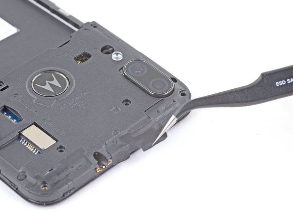

  12. Motorola Moto E6 Plus Motherboard Replacement, Pry up the motherboard cover: crwdns2935265:012crwdnd2935265:01crwdnd2935265:03crwdne2935265:0 Motorola Moto E6 Plus Motherboard Replacement, Pry up the motherboard cover: crwdns2935265:012crwdnd2935265:02crwdnd2935265:03crwdne2935265:0 Motorola Moto E6 Plus Motherboard Replacement, Pry up the motherboard cover: crwdns2935265:012crwdnd2935265:03crwdnd2935265:03crwdne2935265:0
    • Use an opening tool to release the clip next to the rear cameras.

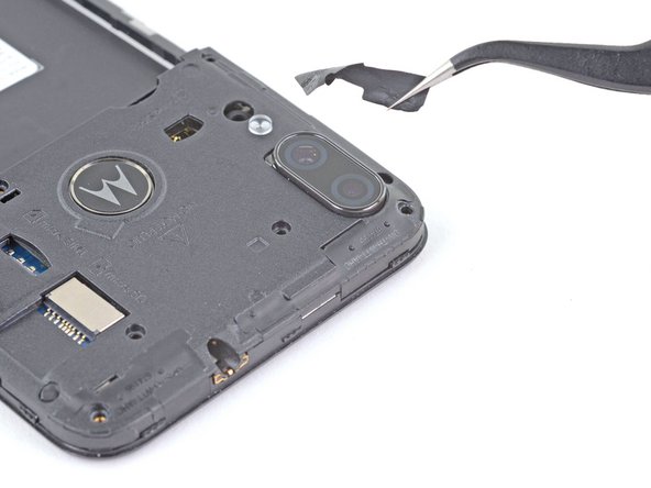

  13. Motorola Moto E6 Plus Motherboard Replacement: crwdns2935265:013crwdnd2935265:01crwdnd2935265:03crwdne2935265:0 Motorola Moto E6 Plus Motherboard Replacement: crwdns2935265:013crwdnd2935265:02crwdnd2935265:03crwdne2935265:0 Motorola Moto E6 Plus Motherboard Replacement: crwdns2935265:013crwdnd2935265:03crwdnd2935265:03crwdne2935265:0

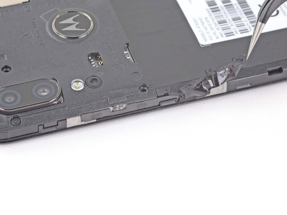

    • Use a pair of tweezers to peel off the sticker on the top edge of the motherboard cover.

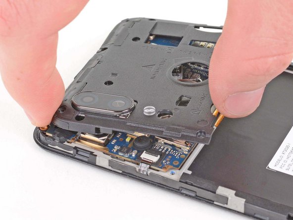

  14. Motorola Moto E6 Plus Motherboard Replacement, Pry up the motherboard cover: crwdns2935265:014crwdnd2935265:01crwdnd2935265:02crwdne2935265:0 Motorola Moto E6 Plus Motherboard Replacement, Pry up the motherboard cover: crwdns2935265:014crwdnd2935265:02crwdnd2935265:02crwdne2935265:0
    • Use a spudger to lift up the left edge of the motherboard cover to loosen the clips.
  15. Motorola Moto E6 Plus Motherboard Replacement, Dislodge the fingerprint sensor: crwdns2935265:015crwdnd2935265:01crwdnd2935265:02crwdne2935265:0 Motorola Moto E6 Plus Motherboard Replacement, Dislodge the fingerprint sensor: crwdns2935265:015crwdnd2935265:02crwdnd2935265:02crwdne2935265:0
    • Use a spudger to push and dislodge the fingerprint sensor off of the motherboard cover.
    • The fingerprint sensor is secured to the underside of the motherboard cover with some light adhesive.

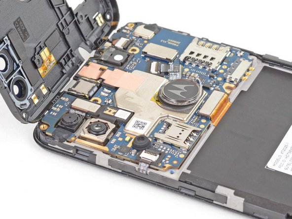

  16. Motorola Moto E6 Plus Motherboard Replacement, Remove the motherboard cover: crwdns2935265:016crwdnd2935265:01crwdnd2935265:03crwdne2935265:0 Motorola Moto E6 Plus Motherboard Replacement, Remove the motherboard cover: crwdns2935265:016crwdnd2935265:02crwdnd2935265:03crwdne2935265:0 Motorola Moto E6 Plus Motherboard Replacement, Remove the motherboard cover: crwdns2935265:016crwdnd2935265:03crwdnd2935265:03crwdne2935265:0
    • Use your fingers to twist the motherboard cover counterclockwise to release the clips securing the motherboard cover.
  17. Motorola Moto E6 Plus Motherboard Replacement: crwdns2935265:017crwdnd2935265:01crwdnd2935265:02crwdne2935265:0 Motorola Moto E6 Plus Motherboard Replacement: crwdns2935265:017crwdnd2935265:02crwdnd2935265:02crwdne2935265:0
    • Remove the motherboard cover.

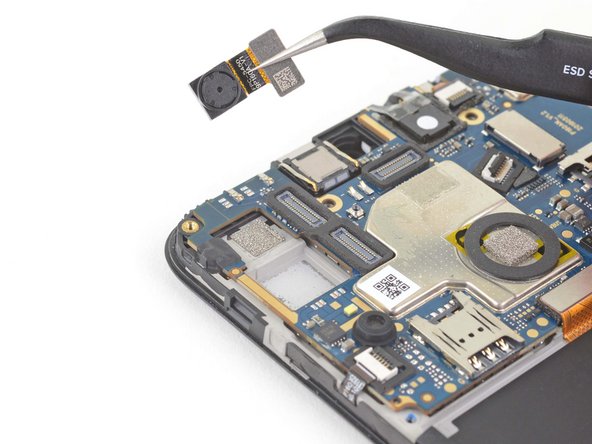

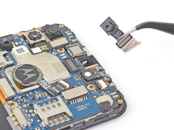

  18. Motorola Moto E6 Plus Motherboard Replacement, Peel back the tape: crwdns2935265:018crwdnd2935265:01crwdnd2935265:02crwdne2935265:0 Motorola Moto E6 Plus Motherboard Replacement, Peel back the tape: crwdns2935265:018crwdnd2935265:02crwdnd2935265:02crwdne2935265:0
    • Use a pair of tweezers to peel back the tape securing the front camera to the motherboard.
  19. Motorola Moto E6 Plus Motherboard Replacement, Remove the front camera: crwdns2935265:019crwdnd2935265:01crwdnd2935265:03crwdne2935265:0 Motorola Moto E6 Plus Motherboard Replacement, Remove the front camera: crwdns2935265:019crwdnd2935265:02crwdnd2935265:03crwdne2935265:0 Motorola Moto E6 Plus Motherboard Replacement, Remove the front camera: crwdns2935265:019crwdnd2935265:03crwdnd2935265:03crwdne2935265:0
    • Use the flat end of a spudger to lift the front camera's press connector straight up to disconnect it from the motherboard.
    • Remove the front camera.

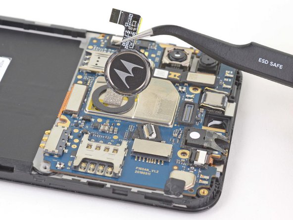

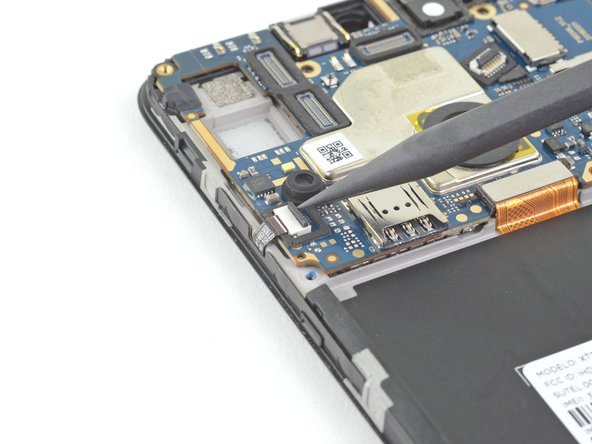

  20. Motorola Moto E6 Plus Motherboard Replacement, Remove the fingerprint sensor: crwdns2935265:020crwdnd2935265:01crwdnd2935265:03crwdne2935265:0 Motorola Moto E6 Plus Motherboard Replacement, Remove the fingerprint sensor: crwdns2935265:020crwdnd2935265:02crwdnd2935265:03crwdne2935265:0 Motorola Moto E6 Plus Motherboard Replacement, Remove the fingerprint sensor: crwdns2935265:020crwdnd2935265:03crwdnd2935265:03crwdne2935265:0
    • Use the tip of a spudger, an opening tool, or your fingernail to flip up the small, hinged locking flap on the fingerprint sensor ZIF connector.
    • Pull the fingerprint sensor ribbon cable straight out of the connector to remove it.
    • Remove the fingerprint sensor.

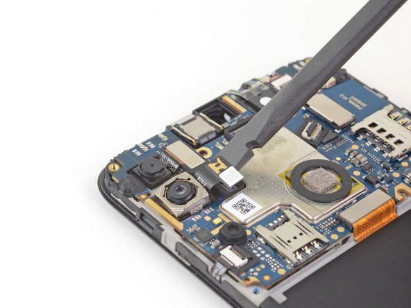

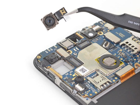

  21. Motorola Moto E6 Plus Motherboard Replacement, Remove the rear cameras: crwdns2935265:021crwdnd2935265:01crwdnd2935265:03crwdne2935265:0 Motorola Moto E6 Plus Motherboard Replacement, Remove the rear cameras: crwdns2935265:021crwdnd2935265:02crwdnd2935265:03crwdne2935265:0 Motorola Moto E6 Plus Motherboard Replacement, Remove the rear cameras: crwdns2935265:021crwdnd2935265:03crwdnd2935265:03crwdne2935265:0
    • Use the flat end of a spudger to disconnect the rear camera from the motherboard by lifting straight up on the press connector.
    • Remove the rear camera.

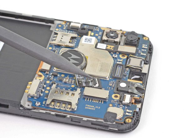

  23. Motorola Moto E6 Plus Motherboard Replacement: crwdns2935265:023crwdnd2935265:01crwdnd2935265:03crwdne2935265:0 Motorola Moto E6 Plus Motherboard Replacement: crwdns2935265:023crwdnd2935265:02crwdnd2935265:03crwdne2935265:0 Motorola Moto E6 Plus Motherboard Replacement: crwdns2935265:023crwdnd2935265:03crwdnd2935265:03crwdne2935265:0
    • Use the tip of a spudger, an opening tool, or your fingernail to flip up the small, hinged locking flap on the button ZIF connector.
    • Use a pair of tweezers to pull the button ribbon cable straight out of the connector.

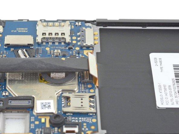

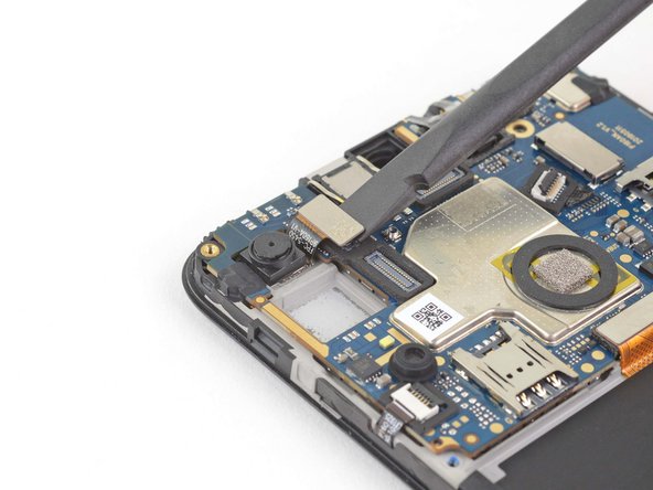

  24. Motorola Moto E6 Plus Motherboard Replacement, Disconnect the motherboard flex cable: crwdns2935265:024crwdnd2935265:01crwdnd2935265:02crwdne2935265:0 Motorola Moto E6 Plus Motherboard Replacement, Disconnect the motherboard flex cable: crwdns2935265:024crwdnd2935265:02crwdnd2935265:02crwdne2935265:0
    • Use the flat end of a spudger to disconnect the motherboard flex cable by lifting straight up on the press connector.

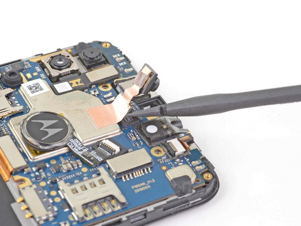

    • Use the pointed end of a spudger to pry the IR sensor out of the frame.
    • Remove the IR sensor gasket from the frame.

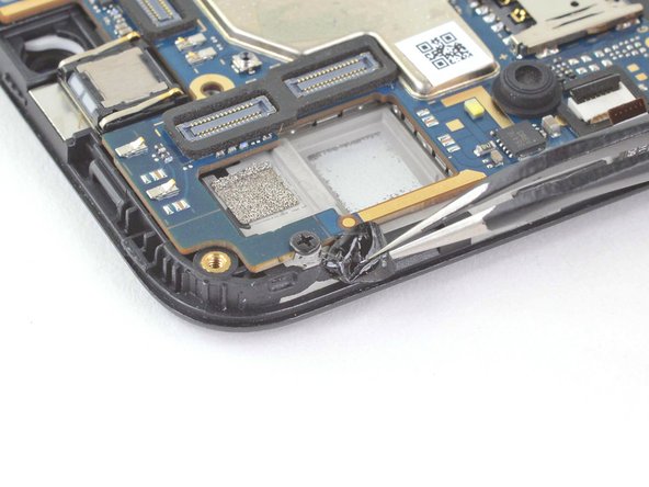

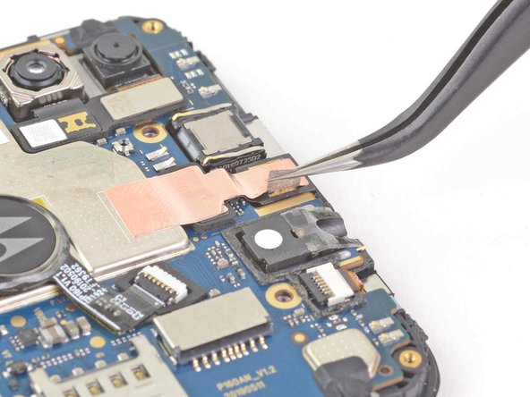

  26. Motorola Moto E6 Plus Motherboard Replacement, Remove the stickers: crwdns2935265:026crwdnd2935265:01crwdnd2935265:02crwdne2935265:0 Motorola Moto E6 Plus Motherboard Replacement, Remove the stickers: crwdns2935265:026crwdnd2935265:02crwdnd2935265:02crwdne2935265:0
    • Use a pair of tweezers to peel off the tape covering the right motherboard screw.

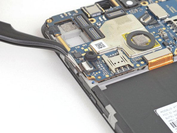

  27. Motorola Moto E6 Plus Motherboard Replacement: crwdns2935265:027crwdnd2935265:01crwdnd2935265:02crwdne2935265:0 Motorola Moto E6 Plus Motherboard Replacement: crwdns2935265:027crwdnd2935265:02crwdnd2935265:02crwdne2935265:0
    • Use a pair of tweezers to peel off the tape covering the left motherboard screw.

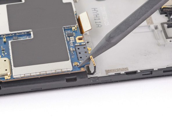

    • Use the pointed end of a spudger to disconnect the coaxial cable by prying up on the cable as close to the connector as possible.

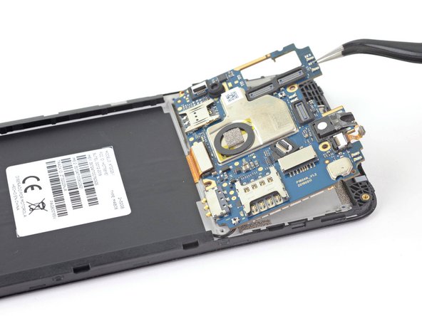

  31. Motorola Moto E6 Plus Motherboard Replacement: crwdns2935265:031crwdnd2935265:01crwdnd2935265:01crwdne2935265:0

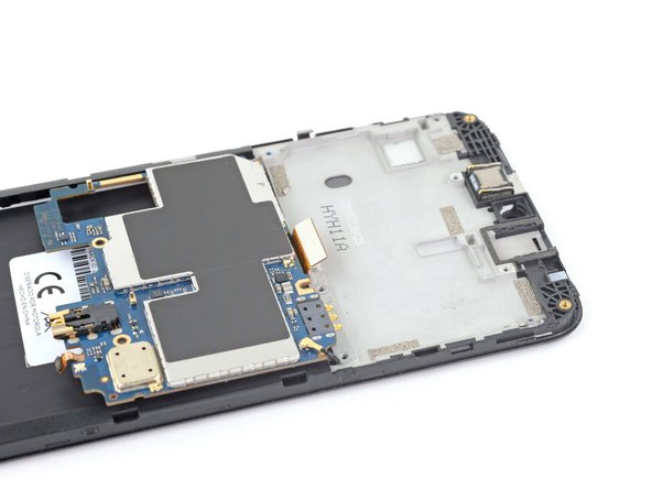

    • Remove the motherboard.

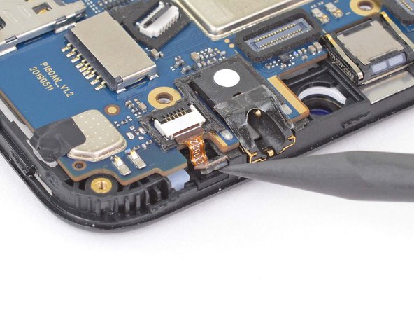

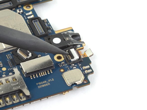

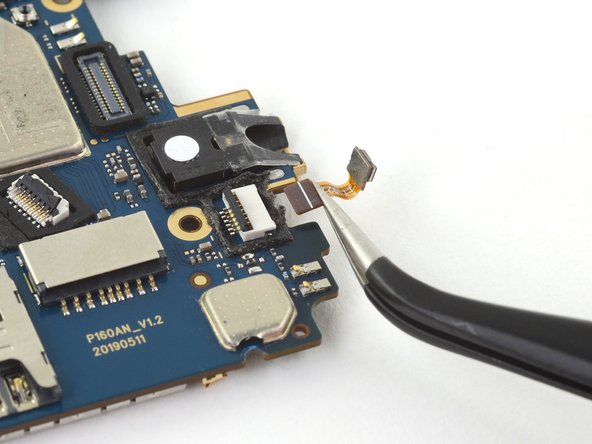

  32. Motorola Moto E6 Plus Motherboard Replacement, Remove the IR sensor: crwdns2935265:032crwdnd2935265:01crwdnd2935265:02crwdne2935265:0 Motorola Moto E6 Plus Motherboard Replacement, Remove the IR sensor: crwdns2935265:032crwdnd2935265:02crwdnd2935265:02crwdne2935265:0
    • Use the tip of a spudger, an opening tool, or your fingernail to flip up the small, hinged locking flap on the IR sensor ZIF connector.
  33. Motorola Moto E6 Plus Motherboard Replacement: crwdns2935265:033crwdnd2935265:01crwdnd2935265:02crwdne2935265:0 Motorola Moto E6 Plus Motherboard Replacement: crwdns2935265:033crwdnd2935265:02crwdnd2935265:02crwdne2935265:0
    • Use a pair of tweezers to pull the IR sensor ribbon cable straight out of the connector.
    • Only the motherboard remains.
