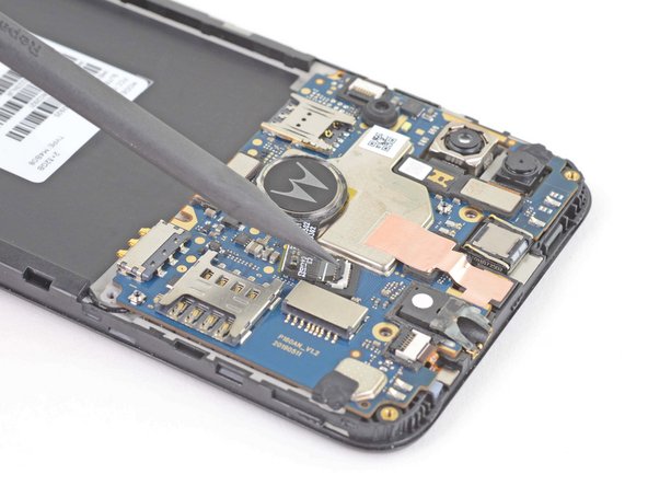

  15. Motorola Moto E6 Plus Fingerprint Sensor Replacement, Dislodge the fingerprint sensor: crwdns2935265:015crwdnd2935265:01crwdnd2935265:02crwdne2935265:0 Motorola Moto E6 Plus Fingerprint Sensor Replacement, Dislodge the fingerprint sensor: crwdns2935265:015crwdnd2935265:02crwdnd2935265:02crwdne2935265:0
    • Use a spudger to push and dislodge the fingerprint sensor off of the motherboard cover.
    • The fingerprint sensor is secured to the underside of the motherboard cover with some light adhesive.

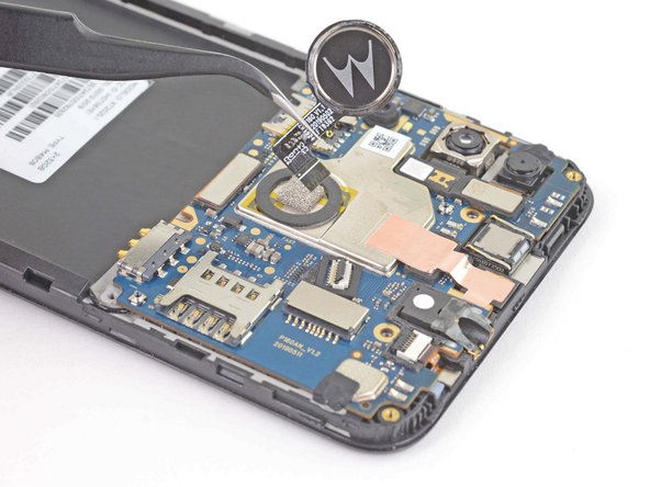

  18. Motorola Moto E6 Plus Fingerprint Sensor Replacement, Remove the fingerprint sensor: crwdns2935265:018crwdnd2935265:01crwdnd2935265:03crwdne2935265:0 Motorola Moto E6 Plus Fingerprint Sensor Replacement, Remove the fingerprint sensor: crwdns2935265:018crwdnd2935265:02crwdnd2935265:03crwdne2935265:0 Motorola Moto E6 Plus Fingerprint Sensor Replacement, Remove the fingerprint sensor: crwdns2935265:018crwdnd2935265:03crwdnd2935265:03crwdne2935265:0
    • Use the tip of a spudger, an opening tool, or your fingernail to flip up the small, hinged locking flap on the fingerprint sensor ZIF connector.
    • Pull the fingerprint sensor ribbon cable straight out of the connector to remove it.
    • Remove the fingerprint sensor.
