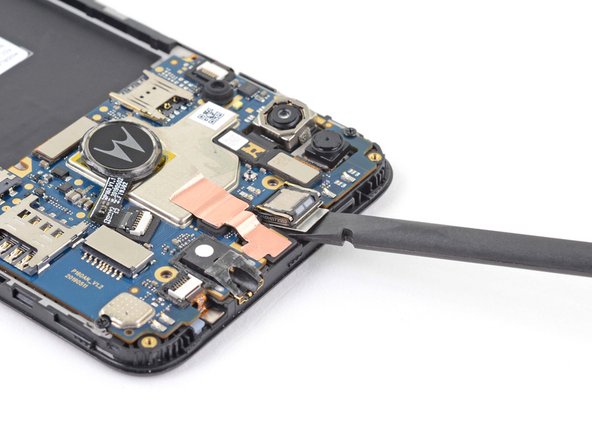

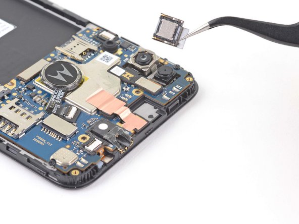

  18. Motorola Moto E6 Plus Earpiece Speaker Replacement, Remove the earpiece speaker: crwdns2935265:018crwdnd2935265:01crwdnd2935265:03crwdne2935265:0 Motorola Moto E6 Plus Earpiece Speaker Replacement, Remove the earpiece speaker: crwdns2935265:018crwdnd2935265:02crwdnd2935265:03crwdne2935265:0 Motorola Moto E6 Plus Earpiece Speaker Replacement, Remove the earpiece speaker: crwdns2935265:018crwdnd2935265:03crwdnd2935265:03crwdne2935265:0
    • Insert the flat end of a spudger underneath the earpiece speaker to peel it off the frame.
    • Remove the earpiece speaker.
