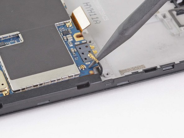

  11. Motorola Moto E6 Plus Display Replacement, Disconnect the coaxial cable: crwdns2935265:011crwdnd2935265:01crwdnd2935265:02crwdne2935265:0 Motorola Moto E6 Plus Display Replacement, Disconnect the coaxial cable: crwdns2935265:011crwdnd2935265:02crwdnd2935265:02crwdne2935265:0
    • Use the pointed end of a spudger to disconnect the coaxial cable by lifting straight up as close to the connector as possible.

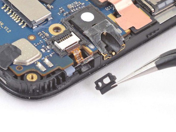

  13. Motorola Moto E6 Plus Display Replacement, Loosen the adhesive: crwdns2935265:013crwdnd2935265:01crwdnd2935265:02crwdne2935265:0 Motorola Moto E6 Plus Display Replacement, Loosen the adhesive: crwdns2935265:013crwdnd2935265:02crwdnd2935265:02crwdne2935265:0
    • Heat an iOpener and apply it to the bottom edge of the screen for 30 seconds.
    • A hair dryer, heat gun, or hot plate may also be used, but be careful not to overheat the phone—the display and internal battery are both susceptible to heat damage.
    • Apply a few drops of high concentration (over 90%) isopropyl alcohol underneath the vibration motor to loosen the adhesive securing it to the frame.
    • Tilt your phone to allow the isopropyl alcohol to flow underneath the vibration motor.

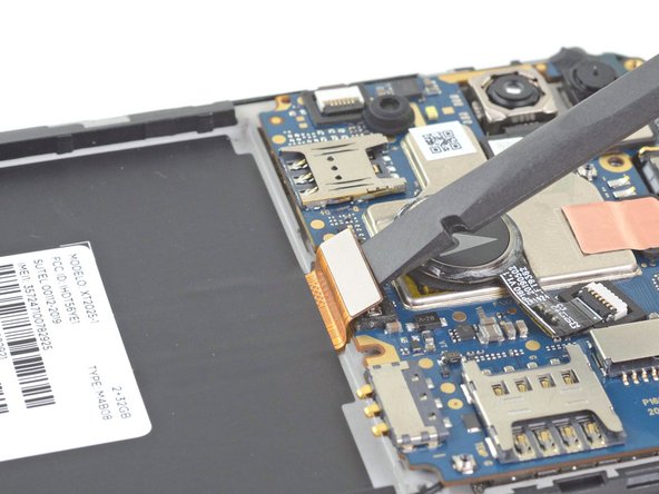

  29. Motorola Moto E6 Plus Display Replacement, Disconnect the motherboard flex cable: crwdns2935265:029crwdnd2935265:01crwdnd2935265:02crwdne2935265:0 Motorola Moto E6 Plus Display Replacement, Disconnect the motherboard flex cable: crwdns2935265:029crwdnd2935265:02crwdnd2935265:02crwdne2935265:0
    • Use the flat end of a spudger to disconnect the motherboard flex cable by lifting straight up on the press connector.

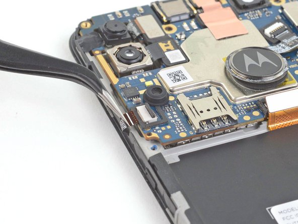

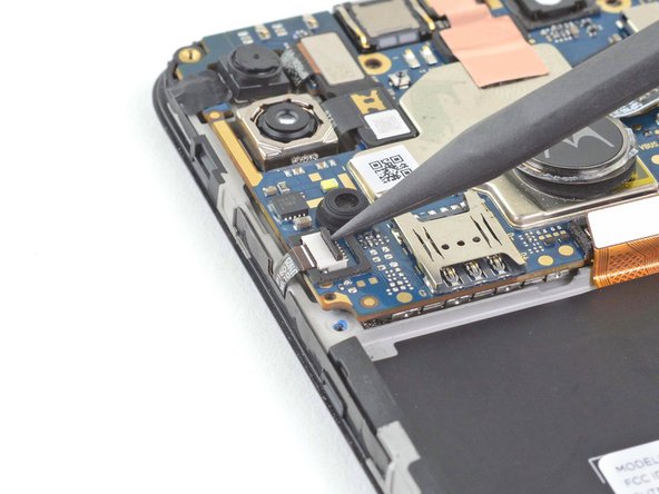

  30. Motorola Moto E6 Plus Display Replacement, Disconnect the button ribbon cable: crwdns2935265:030crwdnd2935265:01crwdnd2935265:03crwdne2935265:0 Motorola Moto E6 Plus Display Replacement, Disconnect the button ribbon cable: crwdns2935265:030crwdnd2935265:02crwdnd2935265:03crwdne2935265:0 Motorola Moto E6 Plus Display Replacement, Disconnect the button ribbon cable: crwdns2935265:030crwdnd2935265:03crwdnd2935265:03crwdne2935265:0
    • Use the tip of a spudger, an opening tool, or your fingernail to flip up the small, hinged locking flap on the button ZIF connector.
    • Use a pair of tweezers to pull the button ribbon cable straight out of the connector.

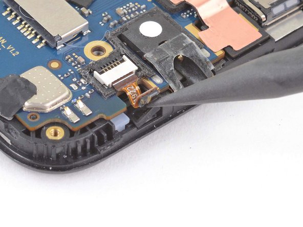

  31. Motorola Moto E6 Plus Display Replacement, Disconnect the IR sensor: crwdns2935265:031crwdnd2935265:01crwdnd2935265:03crwdne2935265:0 Motorola Moto E6 Plus Display Replacement, Disconnect the IR sensor: crwdns2935265:031crwdnd2935265:02crwdnd2935265:03crwdne2935265:0 Motorola Moto E6 Plus Display Replacement, Disconnect the IR sensor: crwdns2935265:031crwdnd2935265:03crwdnd2935265:03crwdne2935265:0
    • Use the pointed end of a spudger to pry the IR sensor out of the frame.
    • Remove the IR sensor gasket from the frame.

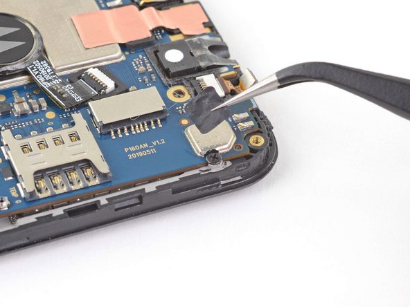

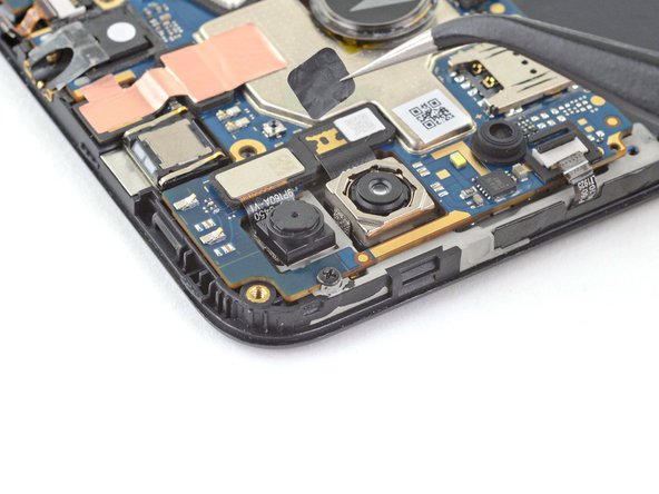

  32. Motorola Moto E6 Plus Display Replacement, Remove the stickers: crwdns2935265:032crwdnd2935265:01crwdnd2935265:02crwdne2935265:0 Motorola Moto E6 Plus Display Replacement, Remove the stickers: crwdns2935265:032crwdnd2935265:02crwdnd2935265:02crwdne2935265:0
    • Use a pair of tweezers to peel off the tape covering the right motherboard screw.
  33. Motorola Moto E6 Plus Display Replacement: crwdns2935265:033crwdnd2935265:01crwdnd2935265:02crwdne2935265:0 Motorola Moto E6 Plus Display Replacement: crwdns2935265:033crwdnd2935265:02crwdnd2935265:02crwdne2935265:0
    • Use a pair of tweezers to peel off the tape covering the left motherboard screw.

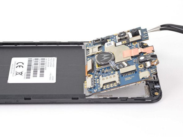

  35. Motorola Moto E6 Plus Display Replacement: crwdns2935265:035crwdnd2935265:01crwdnd2935265:03crwdne2935265:0 Motorola Moto E6 Plus Display Replacement: crwdns2935265:035crwdnd2935265:02crwdnd2935265:03crwdne2935265:0 Motorola Moto E6 Plus Display Replacement: crwdns2935265:035crwdnd2935265:03crwdnd2935265:03crwdne2935265:0
    • Flip the motherboard assembly over.
  36. Motorola Moto E6 Plus Display Replacement: crwdns2935265:036crwdnd2935265:01crwdnd2935265:02crwdne2935265:0 Motorola Moto E6 Plus Display Replacement: crwdns2935265:036crwdnd2935265:02crwdnd2935265:02crwdne2935265:0
    • Use the pointed end of a spudger to disconnect the coaxial cable by prying up on the cable as close to the connector as possible.
  37. Motorola Moto E6 Plus Display Replacement: crwdns2935265:037crwdnd2935265:01crwdnd2935265:01crwdne2935265:0
    • Remove the motherboard.

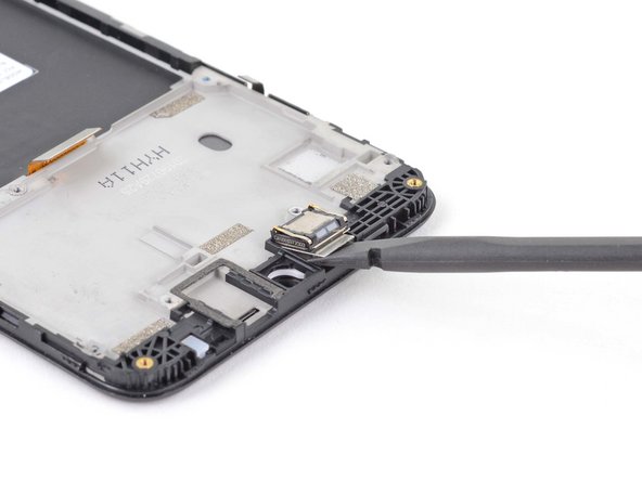

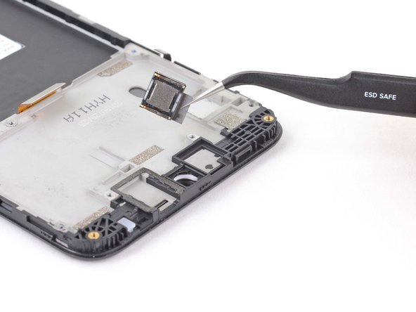

  38. Motorola Moto E6 Plus Display Replacement, Remove the earpiece speaker: crwdns2935265:038crwdnd2935265:01crwdnd2935265:03crwdne2935265:0 Motorola Moto E6 Plus Display Replacement, Remove the earpiece speaker: crwdns2935265:038crwdnd2935265:02crwdnd2935265:03crwdne2935265:0 Motorola Moto E6 Plus Display Replacement, Remove the earpiece speaker: crwdns2935265:038crwdnd2935265:03crwdnd2935265:03crwdne2935265:0
    • Insert the flat end of a spudger underneath the earpiece speaker to separate it from the frame.
    • Remove the earpiece speaker.

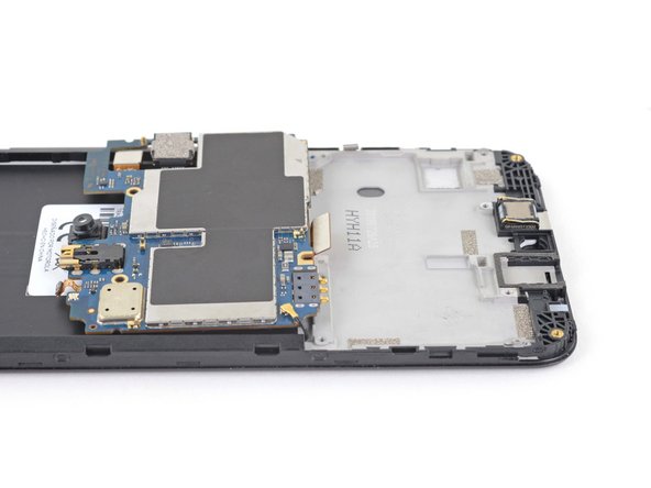

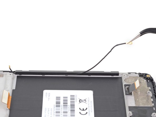

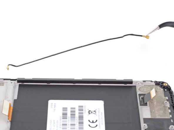

  39. Motorola Moto E6 Plus Display Replacement, Remove the coaxial cable: crwdns2935265:039crwdnd2935265:01crwdnd2935265:03crwdne2935265:0 Motorola Moto E6 Plus Display Replacement, Remove the coaxial cable: crwdns2935265:039crwdnd2935265:02crwdnd2935265:03crwdne2935265:0 Motorola Moto E6 Plus Display Replacement, Remove the coaxial cable: crwdns2935265:039crwdnd2935265:03crwdnd2935265:03crwdne2935265:0
    • Pull the coaxial cable out of its clips on the right side of the frame.
  40. Motorola Moto E6 Plus Display Replacement: crwdns2935265:040crwdnd2935265:01crwdnd2935265:01crwdne2935265:0
    • Only the display assembly remains.
