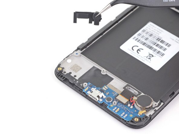

  10. Motorola Moto E6 Plus Daughterboard Replacement, Remove the charging port insulator: crwdns2935265:010crwdnd2935265:01crwdnd2935265:02crwdne2935265:0 Motorola Moto E6 Plus Daughterboard Replacement, Remove the charging port insulator: crwdns2935265:010crwdnd2935265:02crwdnd2935265:02crwdne2935265:0
    • Use a pair of tweezers or your fingers to remove the charging port insulator.
    • The charging port insulator may have come off with the loudspeaker.

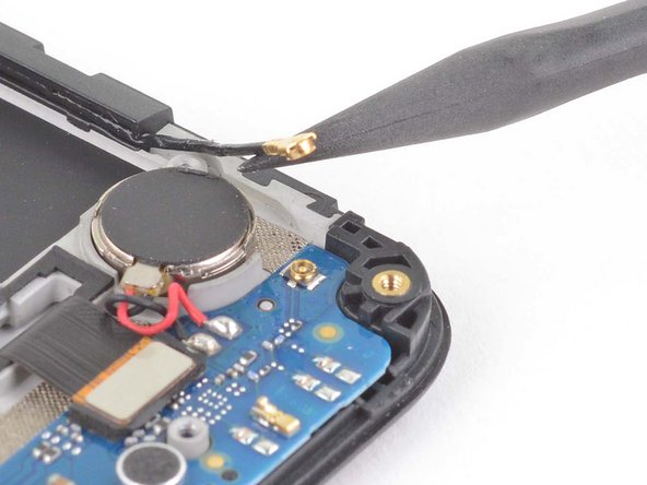

  11. Motorola Moto E6 Plus Daughterboard Replacement, Disconnect the coaxial cable: crwdns2935265:011crwdnd2935265:01crwdnd2935265:02crwdne2935265:0 Motorola Moto E6 Plus Daughterboard Replacement, Disconnect the coaxial cable: crwdns2935265:011crwdnd2935265:02crwdnd2935265:02crwdne2935265:0
    • Use the pointed end of a spudger to disconnect the coaxial cable by lifting straight up as close to the connector as possible.

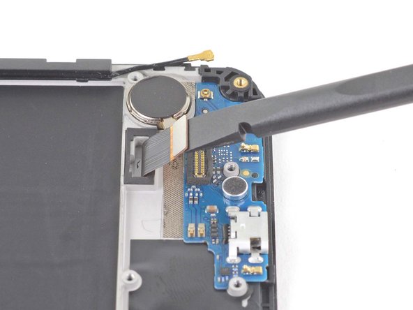

  12. Motorola Moto E6 Plus Daughterboard Replacement, Disconnect the motherboard flex cable: crwdns2935265:012crwdnd2935265:01crwdnd2935265:02crwdne2935265:0 Motorola Moto E6 Plus Daughterboard Replacement, Disconnect the motherboard flex cable: crwdns2935265:012crwdnd2935265:02crwdnd2935265:02crwdne2935265:0
    • Use the flat end of a spudger to disconnect the motherboard flex cable by lifting straight up on the press connector.

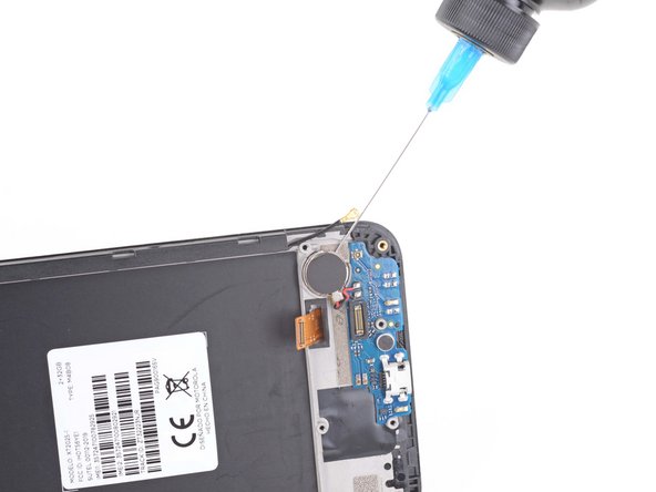

  13. Motorola Moto E6 Plus Daughterboard Replacement, Loosen the adhesive: crwdns2935265:013crwdnd2935265:01crwdnd2935265:02crwdne2935265:0 Motorola Moto E6 Plus Daughterboard Replacement, Loosen the adhesive: crwdns2935265:013crwdnd2935265:02crwdnd2935265:02crwdne2935265:0
    • Heat an iOpener and apply it to the bottom edge of the screen for 30 seconds.
    • A hair dryer, heat gun, or hot plate may also be used, but be careful not to overheat the phone—the display and internal battery are both susceptible to heat damage.
    • Apply a few drops of high concentration (over 90%) isopropyl alcohol underneath the vibration motor to loosen the adhesive securing it to the frame.
    • Tilt your phone to allow the isopropyl alcohol to flow underneath the vibration motor.

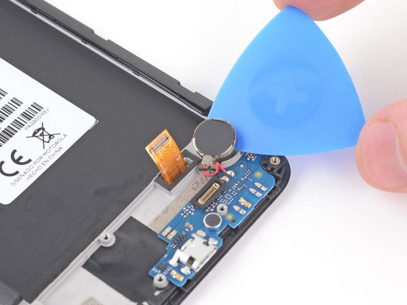

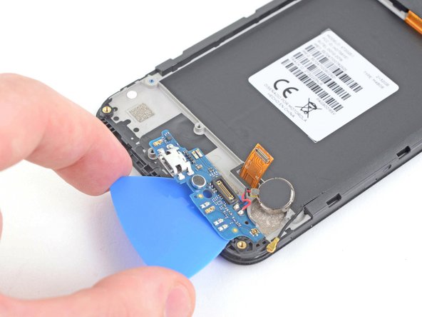

  14. Motorola Moto E6 Plus Daughterboard Replacement, Remove the daughterboard assembly: crwdns2935265:014crwdnd2935265:01crwdnd2935265:02crwdne2935265:0 Motorola Moto E6 Plus Daughterboard Replacement, Remove the daughterboard assembly: crwdns2935265:014crwdnd2935265:02crwdnd2935265:02crwdne2935265:0
    • Use an opening pick to peel the vibration motor off the frame.

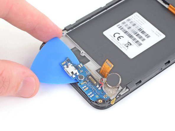

  15. Motorola Moto E6 Plus Daughterboard Replacement: crwdns2935265:015crwdnd2935265:01crwdnd2935265:03crwdne2935265:0 Motorola Moto E6 Plus Daughterboard Replacement: crwdns2935265:015crwdnd2935265:02crwdnd2935265:03crwdne2935265:0 Motorola Moto E6 Plus Daughterboard Replacement: crwdns2935265:015crwdnd2935265:03crwdnd2935265:03crwdne2935265:0
    • Use an opening pick to peel the daughterboard assembly off the frame starting from the left edge.
    • Insert an opening pick under the bottom right edge to cut the remaining adhesive.
  16. Motorola Moto E6 Plus Daughterboard Replacement: crwdns2935265:016crwdnd2935265:01crwdnd2935265:01crwdne2935265:0
    • Remove the daughterboard assembly which includes the vibration motor and the charging port.
