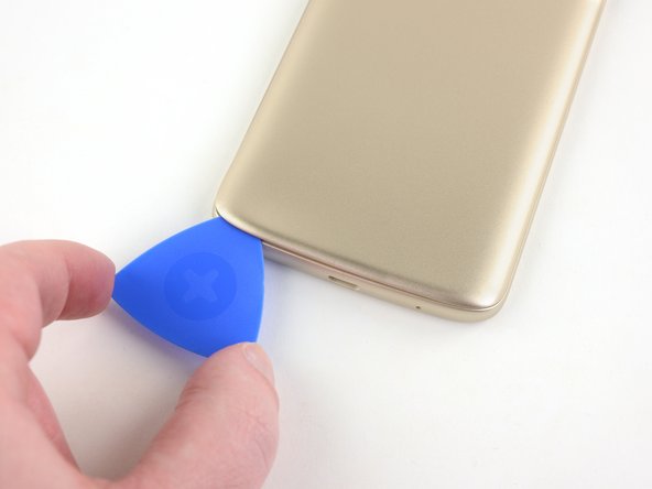

    • Apply a suction handle to the back cover, near the middle of the edge you heated up.
    • Pull the suction cup with firm, constant pressure to create a slight gap between the phone's frame and the back cover.
    • Insert an opening pick into the gap.
  4. Motorola Moto E5 Screen Replacement: crwdns2935265:04crwdnd2935265:01crwdnd2935265:02crwdne2935265:0 Motorola Moto E5 Screen Replacement: crwdns2935265:04crwdnd2935265:02crwdnd2935265:02crwdne2935265:0
    • Slide the opening pick along the edge of the phone, cutting through the adhesive securing the back cover to the phone's frame.

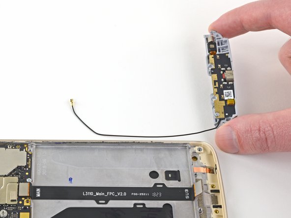

    • Remove the four 3.8 mm-long Phillips screws securing the daughterboard.

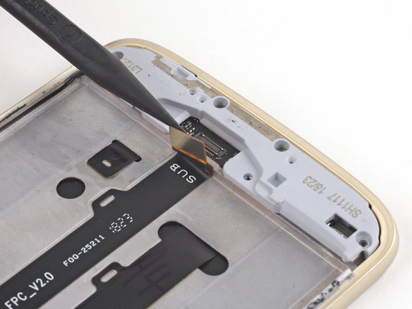

  24. Motorola Moto E5 Screen Replacement: crwdns2935265:024crwdnd2935265:01crwdnd2935265:02crwdne2935265:0 Motorola Moto E5 Screen Replacement: crwdns2935265:024crwdnd2935265:02crwdnd2935265:02crwdne2935265:0
    • Use a spudger to pry up and disconnect the daughterboard cable connector from the daughterboard.
  25. Motorola Moto E5 Screen Replacement: crwdns2935265:025crwdnd2935265:01crwdnd2935265:02crwdne2935265:0 Motorola Moto E5 Screen Replacement: crwdns2935265:025crwdnd2935265:02crwdnd2935265:02crwdne2935265:0
    • Use the flat end of a spudger to pry up the daughterboard and free it from its recess.
  26. Motorola Moto E5 Screen Replacement: crwdns2935265:026crwdnd2935265:01crwdnd2935265:02crwdne2935265:0 Motorola Moto E5 Screen Replacement: crwdns2935265:026crwdnd2935265:02crwdnd2935265:02crwdne2935265:0

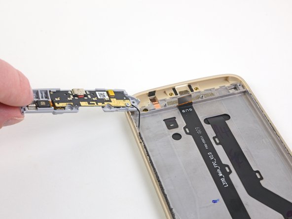

    • The daughterboard is still attached to an antenna cable, so lift the daughterboard up from the left side of the phone and flip it over its right side to prevent ripping the antenna cable out.
  27. Motorola Moto E5 Screen Replacement: crwdns2935265:027crwdnd2935265:01crwdnd2935265:02crwdne2935265:0 Motorola Moto E5 Screen Replacement: crwdns2935265:027crwdnd2935265:02crwdnd2935265:02crwdne2935265:0

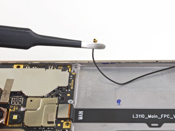

    • Use the point of a spudger to pry up and disconnect the antenna cable connector on the motherboard.
  28. Motorola Moto E5 Screen Replacement: crwdns2935265:028crwdnd2935265:01crwdnd2935265:03crwdne2935265:0 Motorola Moto E5 Screen Replacement: crwdns2935265:028crwdnd2935265:02crwdnd2935265:03crwdne2935265:0 Motorola Moto E5 Screen Replacement: crwdns2935265:028crwdnd2935265:03crwdnd2935265:03crwdne2935265:0
    • Use your fingers or a pair of tweezers to detach the antenna cable from its groove along the side of the phone.
    • Remove the daughterboard and antenna cable.
  29. Motorola Moto E5 Screen Replacement: crwdns2935265:029crwdnd2935265:01crwdnd2935265:02crwdne2935265:0 Motorola Moto E5 Screen Replacement: crwdns2935265:029crwdnd2935265:02crwdnd2935265:02crwdne2935265:0

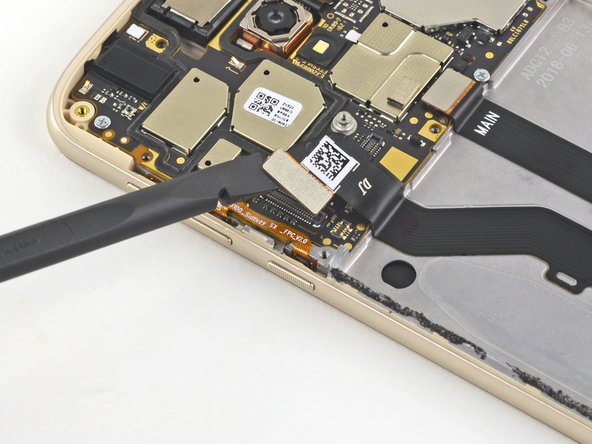

    • Use the point of a spudger to pry up and disconnect the daughterboard cable from the motherboard.
  30. Motorola Moto E5 Screen Replacement: crwdns2935265:030crwdnd2935265:01crwdnd2935265:02crwdne2935265:0 Motorola Moto E5 Screen Replacement: crwdns2935265:030crwdnd2935265:02crwdnd2935265:02crwdne2935265:0

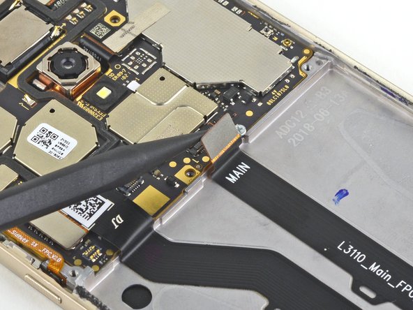

    • Use a spudger to pry up and disconnect the display cable from the motherboard.

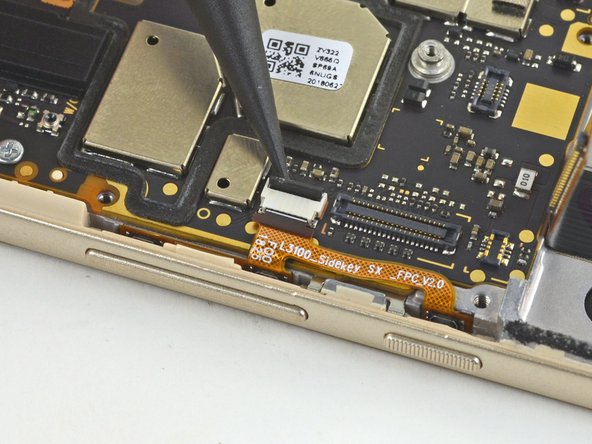

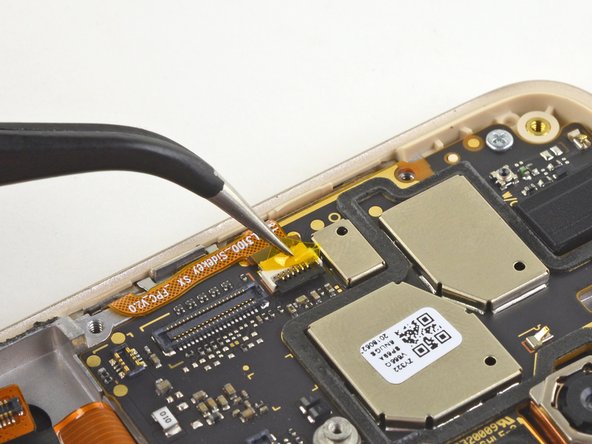

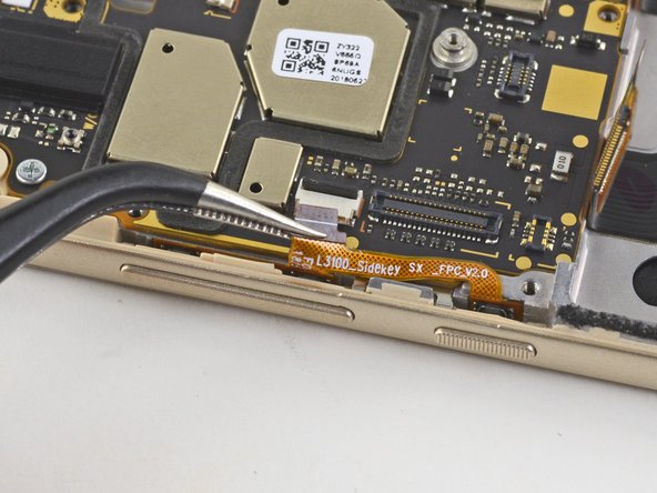

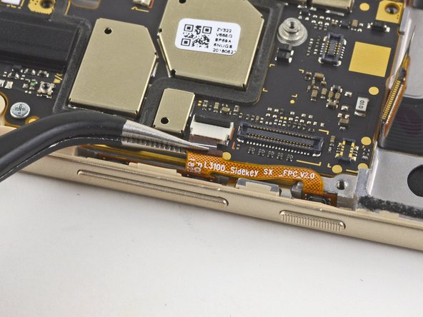

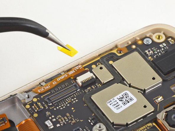

    • Use a pair of tweezers to peel up and remove the tape covering the volume button connector.
  32. Motorola Moto E5 Screen Replacement: crwdns2935265:032crwdnd2935265:01crwdnd2935265:02crwdne2935265:0 Motorola Moto E5 Screen Replacement: crwdns2935265:032crwdnd2935265:02crwdnd2935265:02crwdne2935265:0
    • Use the point of a spudger to flip up the black locking lever on the volume button connector.
  33. Motorola Moto E5 Screen Replacement: crwdns2935265:033crwdnd2935265:01crwdnd2935265:03crwdne2935265:0 Motorola Moto E5 Screen Replacement: crwdns2935265:033crwdnd2935265:02crwdnd2935265:03crwdne2935265:0 Motorola Moto E5 Screen Replacement: crwdns2935265:033crwdnd2935265:03crwdnd2935265:03crwdne2935265:0

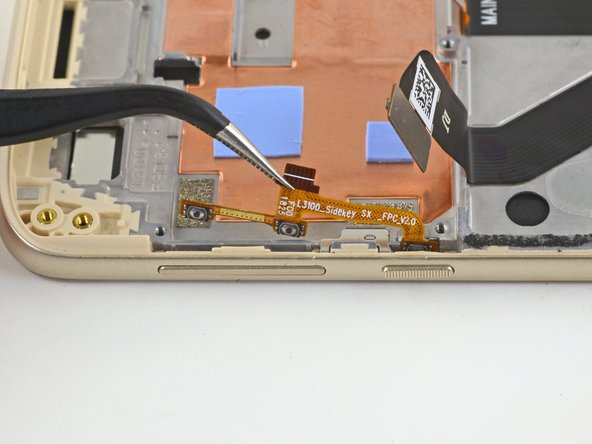

    • Use a pair of tweezers to pull the volume button cable straight out of its connector.
  34. Motorola Moto E5 Screen Replacement: crwdns2935265:034crwdnd2935265:01crwdnd2935265:03crwdne2935265:0 Motorola Moto E5 Screen Replacement: crwdns2935265:034crwdnd2935265:02crwdnd2935265:03crwdne2935265:0 Motorola Moto E5 Screen Replacement: crwdns2935265:034crwdnd2935265:03crwdnd2935265:03crwdne2935265:0
    • Slide an opening pick along the underside of the volume button cable to cut the adhesive and free it from the motherboard.

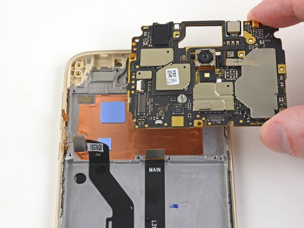

    • Remove the two 2.9 mm-long Phillips screws securing the motherboard.
  36. Motorola Moto E5 Screen Replacement: crwdns2935265:036crwdnd2935265:01crwdnd2935265:03crwdne2935265:0 Motorola Moto E5 Screen Replacement: crwdns2935265:036crwdnd2935265:02crwdnd2935265:03crwdne2935265:0 Motorola Moto E5 Screen Replacement: crwdns2935265:036crwdnd2935265:03crwdnd2935265:03crwdne2935265:0

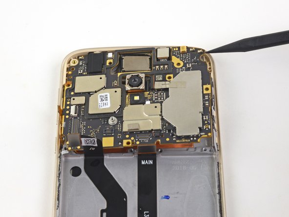

    • Insert the point of a spudger anywhere in between the motherboard and the phone's frame.
    • Pry the motherboard up to free it from its recess and remove it, making sure it doesn't snag on any of the cables and connectors.

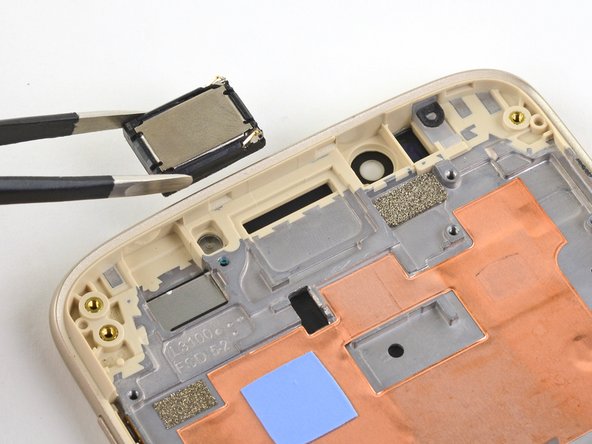

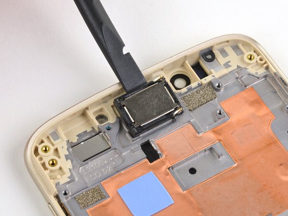

    • Use the flat end of a spudger to pry up and free the earpiece speaker from its recess.
    • The earpiece speaker is slightly adhered to the phone's frame, so a bit of resistance is normal.
    • Use your fingers or a pair of tweezers to remove the earpiece speaker.
    • During re-assembly, be sure the two spring contacts on the earpiece speaker point upward and face the right.

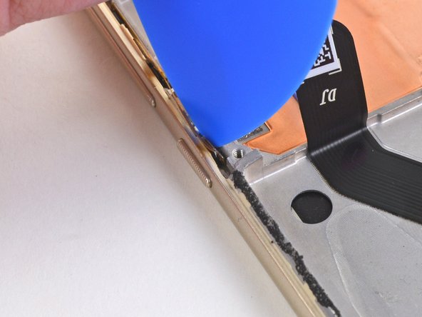

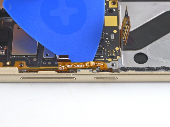

    • Insert an opening pick into the gap between the volume buttons and the phone's frame.

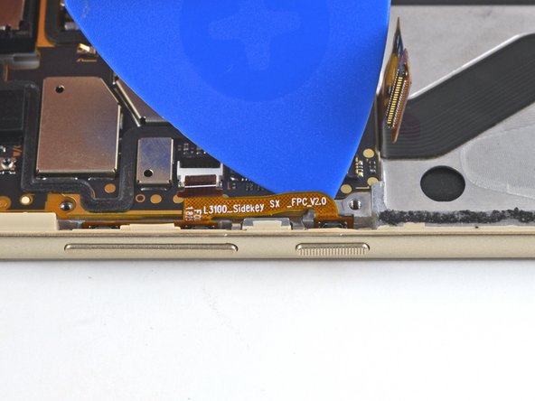

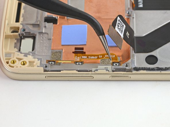

  39. Motorola Moto E5 Screen Replacement: crwdns2935265:039crwdnd2935265:01crwdnd2935265:02crwdne2935265:0 Motorola Moto E5 Screen Replacement: crwdns2935265:039crwdnd2935265:02crwdnd2935265:02crwdne2935265:0
    • Slide the opening pick along the volume buttons to cut the adhesive securing it to the phone's frame.
  40. Motorola Moto E5 Screen Replacement: crwdns2935265:040crwdnd2935265:01crwdnd2935265:03crwdne2935265:0 Motorola Moto E5 Screen Replacement: crwdns2935265:040crwdnd2935265:02crwdnd2935265:03crwdne2935265:0 Motorola Moto E5 Screen Replacement: crwdns2935265:040crwdnd2935265:03crwdnd2935265:03crwdne2935265:0
    • Use a pair of tweezers to remove the volume buttons from the phone's frame.

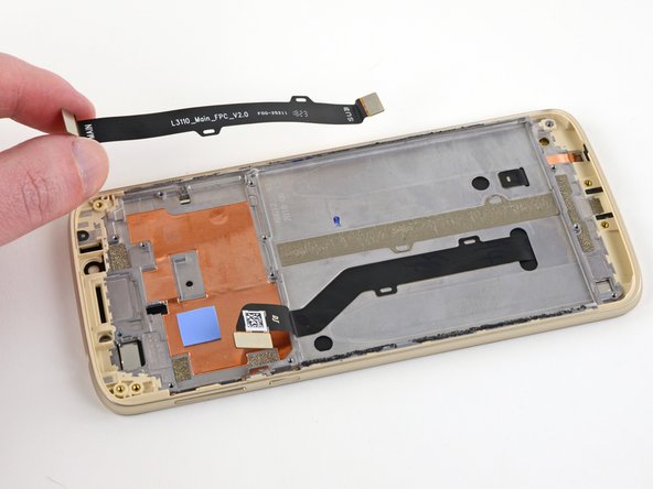

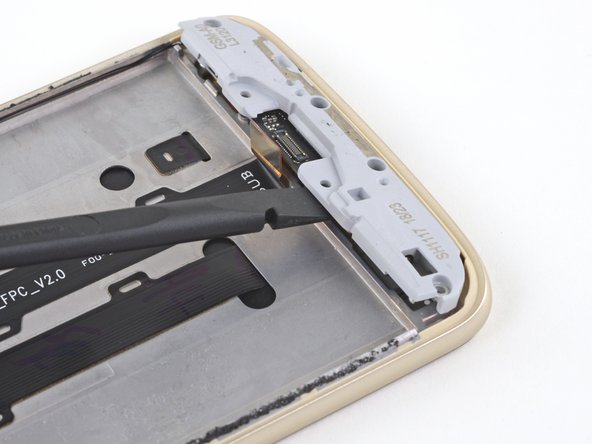

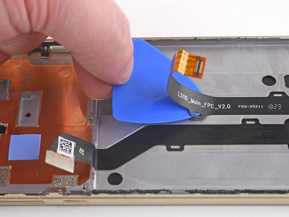

    • Insert an opening pick underneath the daughterboard cable near the motherboard connector at a 45-degree angle.
    • Slide the opening pick along the underside of the cable, slicing the adhesive and removing the cable from the phone.
  42. Motorola Moto E5 Screen Replacement: crwdns2935265:042crwdnd2935265:01crwdnd2935265:01crwdne2935265:0
    • Only the frame, the LCD screen, digitizer assembly, and display cable remain.
    • Compare your new replacement part to the original part. You may need to transfer remaining components or remove adhesive backings from the new part before installing.
