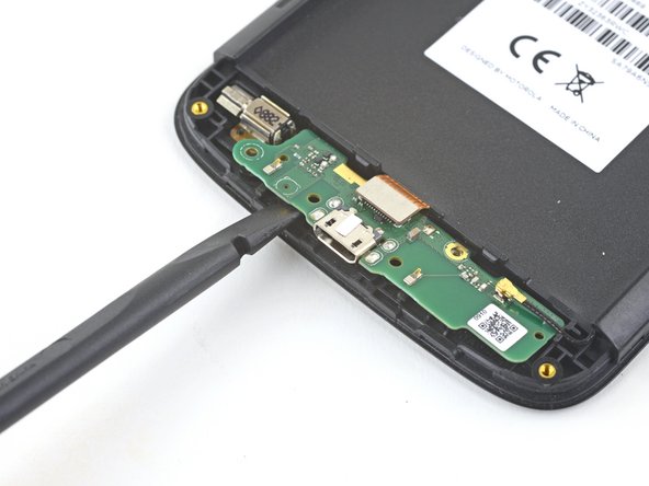

    • Insert the flat end of a spudger into the seam on the bottom of the daughterboard cover.
    • Twist the spudger slightly to unclip the daughterboard cover.
    • Remove the daughterboard cover.

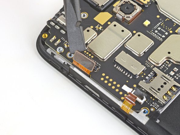

    • Use the point of a spudger to pry up and disconnect the antenna cable from the daughterboard.
  10. Motorola Moto E5 Play Screen Replacement: crwdns2935265:010crwdnd2935265:01crwdnd2935265:02crwdne2935265:0 Motorola Moto E5 Play Screen Replacement: crwdns2935265:010crwdnd2935265:02crwdnd2935265:02crwdne2935265:0
    • Use a spudger to pry up and disconnect the motherboard flex cable connector from the daughterboard.

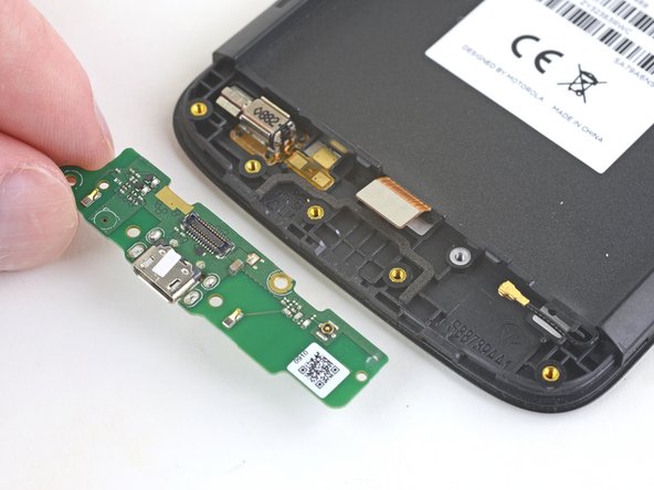

    • Insert the flat end of a spudger into the gap below the daughterboard and to the left of the charging port.
    • Pry the daughterboard up slightly with the spudger to loosen it from its recess.
    • Lift and remove the daughterboard, taking care not to snag any cables.

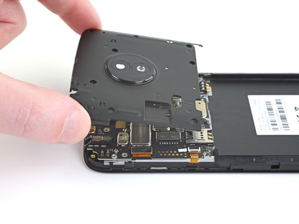

  17. Motorola Moto E5 Play Screen Replacement: crwdns2935265:017crwdnd2935265:01crwdnd2935265:02crwdne2935265:0 Motorola Moto E5 Play Screen Replacement: crwdns2935265:017crwdnd2935265:02crwdnd2935265:02crwdne2935265:0
    • Make sure the three clips on the motherboard cover have not re-engaged.
    • Lift the motherboard cover from the top and remove it.
