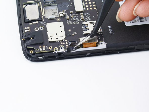

  4. Motorola Moto E4 Screen (No Fingerprint Sensor) Replacement: crwdns2935265:04crwdnd2935265:01crwdnd2935265:03crwdne2935265:0 Motorola Moto E4 Screen (No Fingerprint Sensor) Replacement: crwdns2935265:04crwdnd2935265:02crwdnd2935265:03crwdne2935265:0 Motorola Moto E4 Screen (No Fingerprint Sensor) Replacement: crwdns2935265:04crwdnd2935265:03crwdnd2935265:03crwdne2935265:0
    • This step can be skipped if you are only removing the front-facing camera. For all other repairs, continue as follows.
    • Disconnect the rear-facing camera by prying straight up on the connector on its right side.
    • Remove the rear-facing camera from the Moto E4.

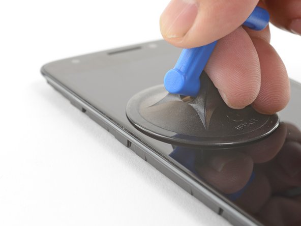

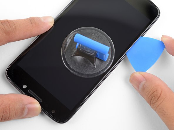

  11. Motorola Moto E4 Screen (No Fingerprint Sensor) Replacement, Apply heat to the edge of the phone: crwdns2935265:011crwdnd2935265:01crwdnd2935265:01crwdne2935265:0
    • Heat an iOpener and apply it to the left edge of the screen for one minute to help soften the adhesive securing the screen.
    • A hair dryer, heat gun, or hot plate may also be used.
    • If your display is badly cracked, covering it with a layer of clear packing tape may allow the suction cup to adhere. Alternatively, very strong tape may be used instead of the suction cup. If all else fails, you can superglue the suction cup to the broken screen.

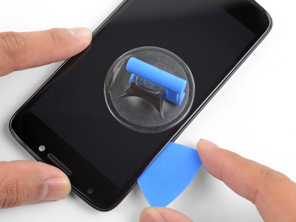

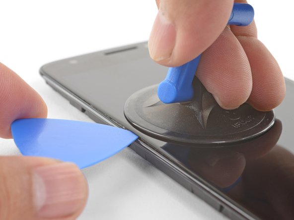

  12. Motorola Moto E4 Screen (No Fingerprint Sensor) Replacement, Create an opening gap: crwdns2935265:012crwdnd2935265:01crwdnd2935265:03crwdne2935265:0 Motorola Moto E4 Screen (No Fingerprint Sensor) Replacement, Create an opening gap: crwdns2935265:012crwdnd2935265:02crwdnd2935265:03crwdne2935265:0 Motorola Moto E4 Screen (No Fingerprint Sensor) Replacement, Create an opening gap: crwdns2935265:012crwdnd2935265:03crwdnd2935265:03crwdne2935265:0
    • Apply a suction cup to the screen, near the heated edge of the phone.
    • Pull on the suction cup with strong, steady force to create a gap between the screen and frame.
    • Insert the point of an opening pick into the gap.
    • Due to the strong adhesive, this may take multiple attempts. If you have trouble, heat the edge for another minute and try again.

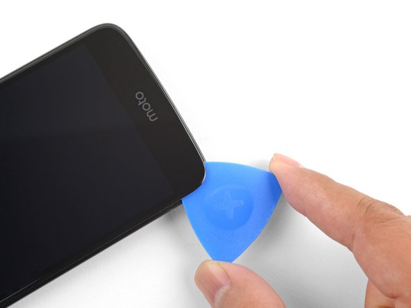

  13. Motorola Moto E4 Screen (No Fingerprint Sensor) Replacement, Slice through the screen adhesive: crwdns2935265:013crwdnd2935265:01crwdnd2935265:03crwdne2935265:0 Motorola Moto E4 Screen (No Fingerprint Sensor) Replacement, Slice through the screen adhesive: crwdns2935265:013crwdnd2935265:02crwdnd2935265:03crwdne2935265:0 Motorola Moto E4 Screen (No Fingerprint Sensor) Replacement, Slice through the screen adhesive: crwdns2935265:013crwdnd2935265:03crwdnd2935265:03crwdne2935265:0
    • Slide the opening pick along the left edge to slice through the adhesive.
    • As you push the pick into the phone, you may feel it press against the edge of the LCD underneath the glass. If you angle the point of the pick downwards, you can slide the pick underneath the edge of the LCD.

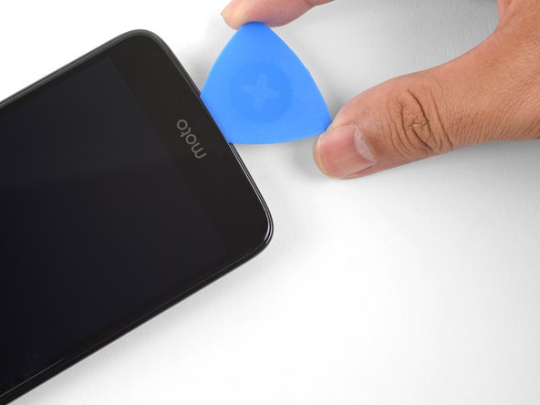

  14. Motorola Moto E4 Screen (No Fingerprint Sensor) Replacement: crwdns2935265:014crwdnd2935265:01crwdnd2935265:03crwdne2935265:0 Motorola Moto E4 Screen (No Fingerprint Sensor) Replacement: crwdns2935265:014crwdnd2935265:02crwdnd2935265:03crwdne2935265:0 Motorola Moto E4 Screen (No Fingerprint Sensor) Replacement: crwdns2935265:014crwdnd2935265:03crwdnd2935265:03crwdne2935265:0
    • Apply a heated iOpener to the bottom edge of the phone for a minute to soften the adhesive.
    • Use an opening pick to slice through the adhesive at the bottom edge of the phone.
    • The adhesive here is as thick as the bezel. Be sure to slice deep enough to cut through all of the adhesive.

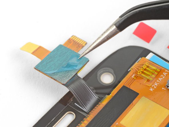

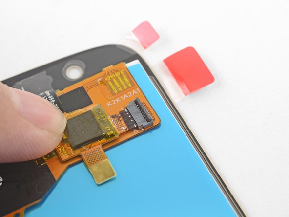

  19. Motorola Moto E4 Screen (No Fingerprint Sensor) Replacement, Prepare the replacement screen: crwdns2935265:019crwdnd2935265:01crwdnd2935265:03crwdne2935265:0 Motorola Moto E4 Screen (No Fingerprint Sensor) Replacement, Prepare the replacement screen: crwdns2935265:019crwdnd2935265:02crwdnd2935265:03crwdne2935265:0 Motorola Moto E4 Screen (No Fingerprint Sensor) Replacement, Prepare the replacement screen: crwdns2935265:019crwdnd2935265:03crwdnd2935265:03crwdne2935265:0
    • This step shows how to prepare your replacement screen for installation.
    • If your replacement screen came with the digitizer cable disconnected, be sure to connect it before installation:
    • Use a spudger to flip up the digitizer cable ZIF socket's locking bar, located on the back of the screen near the top right corner.
    • Peel off the small square plastic liner under the digitizer cable to expose the adhesive.
    • Press the cable down against the back of the screen.
    • Carefully feed the cable into the digitizer cable socket until the white bar printed on the cable is barely visible.
    • Flip the socket's locking bar down to secure the cable in place.
    • Peel all plastic liners from the replacement screen.
