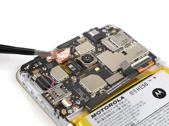

  10. Motorola Moto E4 Plus Rear Camera Replacement, Rear Camera: crwdns2935265:010crwdnd2935265:01crwdnd2935265:02crwdne2935265:0 Motorola Moto E4 Plus Rear Camera Replacement, Rear Camera: crwdns2935265:010crwdnd2935265:02crwdnd2935265:02crwdne2935265:0
    • Use a pair of tweezers to peel up the copper tape that covers the rear camera flex connector.
    • Fold the copper tape out of the way.

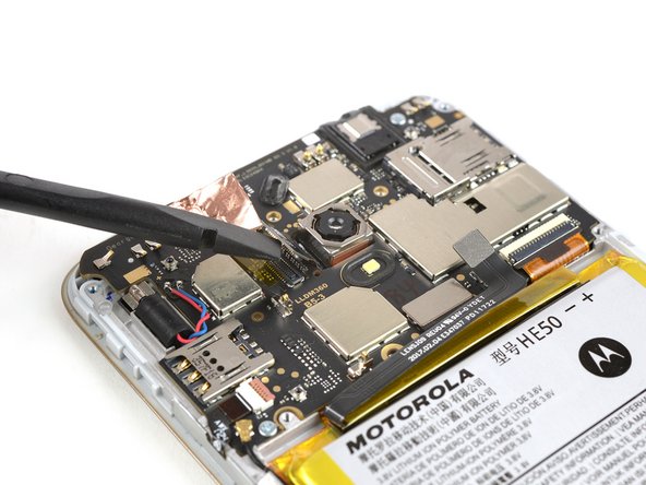

  11. Motorola Moto E4 Plus Rear Camera Replacement: crwdns2935265:011crwdnd2935265:01crwdnd2935265:02crwdne2935265:0 Motorola Moto E4 Plus Rear Camera Replacement: crwdns2935265:011crwdnd2935265:02crwdnd2935265:02crwdne2935265:0
    • Use the flat end of a spudger to pry up and disconnect the rear camera flex cable.
