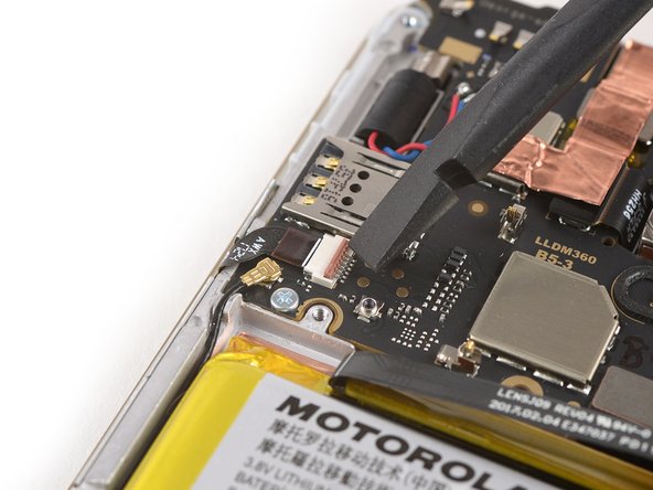

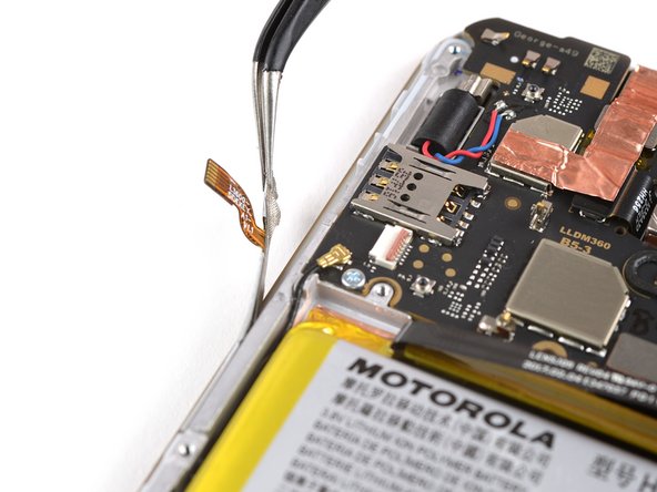

  10. Motorola Moto E4 Plus Power and Volume Buttons Replacement, Power & Volume Button: crwdns2935265:010crwdnd2935265:01crwdnd2935265:03crwdne2935265:0 Motorola Moto E4 Plus Power and Volume Buttons Replacement, Power & Volume Button: crwdns2935265:010crwdnd2935265:02crwdnd2935265:03crwdne2935265:0 Motorola Moto E4 Plus Power and Volume Buttons Replacement, Power & Volume Button: crwdns2935265:010crwdnd2935265:03crwdnd2935265:03crwdne2935265:0
    • Use the edge of a spudger to open the lever of the ZIF connector.
    • Use a pair of tweezers to pull the power and volume button flex cable out of the ZIF connector.

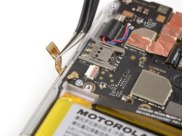

  11. Motorola Moto E4 Plus Power and Volume Buttons Replacement: crwdns2935265:011crwdnd2935265:01crwdnd2935265:03crwdne2935265:0 Motorola Moto E4 Plus Power and Volume Buttons Replacement: crwdns2935265:011crwdnd2935265:02crwdnd2935265:03crwdne2935265:0 Motorola Moto E4 Plus Power and Volume Buttons Replacement: crwdns2935265:011crwdnd2935265:03crwdnd2935265:03crwdne2935265:0
    • Use a pair of tweezers to gently peel the power and volume button unit out of its thin recess in the side of the frame.
    • Remove the power and volume button unit.
