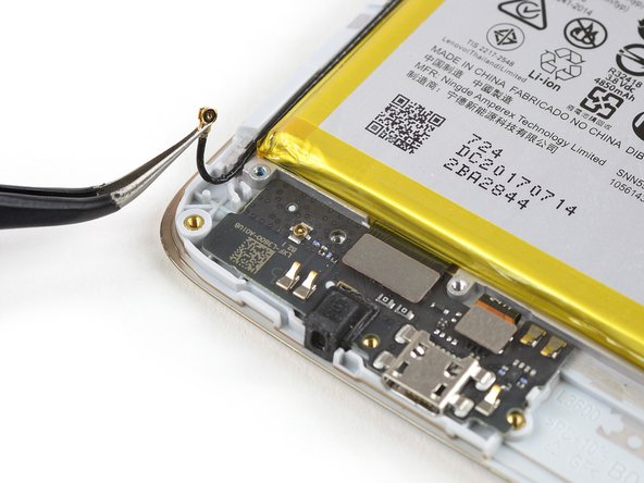

  11. Motorola Moto E4 Plus Charging Board Replacement: crwdns2935265:011crwdnd2935265:01crwdnd2935265:02crwdne2935265:0 Motorola Moto E4 Plus Charging Board Replacement: crwdns2935265:011crwdnd2935265:02crwdnd2935265:02crwdne2935265:0
    • Use a pair of tweezers to pry up and disconnect the antenna cable.

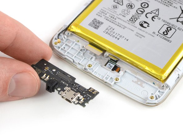

    • Insert the tip of a spudger underneath the bottom edge of the charging board and pry upwards.
    • Remove the charging board.
    • Before reassembly check your new part for any components that might need to be transferred from the old one (e.g. microphone rubber gasket).
