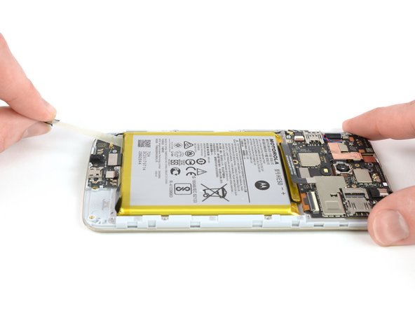

  11. Motorola Moto E4 Plus Battery Replacement: crwdns2935265:011crwdnd2935265:01crwdnd2935265:03crwdne2935265:0 Motorola Moto E4 Plus Battery Replacement: crwdns2935265:011crwdnd2935265:02crwdnd2935265:03crwdne2935265:0 Motorola Moto E4 Plus Battery Replacement: crwdns2935265:011crwdnd2935265:03crwdnd2935265:03crwdne2935265:0
    • Pull out the left adhesive strip by steadily pulling the left tab at a flat angle.
    • If the adhesive strip rips, grab and twist the remaining stub around the tip of a pair of tweezers a couple of times and then continue pulling.
    • Repeat the same process for the right adhesive strip.

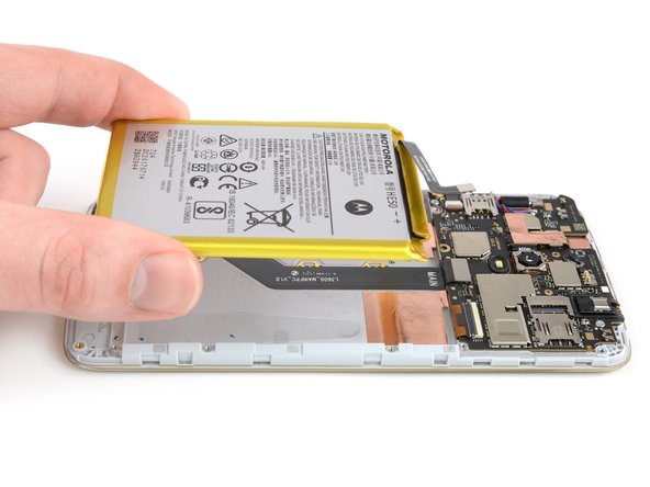

  12. Motorola Moto E4 Plus Battery Replacement: crwdns2935265:012crwdnd2935265:01crwdnd2935265:02crwdne2935265:0 Motorola Moto E4 Plus Battery Replacement: crwdns2935265:012crwdnd2935265:02crwdnd2935265:02crwdne2935265:0
    • Remove the battery.
    • Do not reuse the battery after it has been removed, as doing so is a potential safety hazard. Replace it with a new battery.
    • Secure the new battery with pre-cut adhesive or double-sided adhesive tape.
    • In order to position it correctly, apply the new adhesive into the phone at the places where the old adhesive was located, not directly onto the battery.
    • Press the new battery firmly into place for 5-10 seconds.
If possible, turn on your phone and test your repair before installing new adhesive and resealing the phone.
For optimal performance, after completing this guide, calibrate your newly installed battery: Charge it to 100% and keep charging it for at least two more hours. Then use your device until it shuts off due to low battery. Finally, charge it uninterrupted to 100%.
