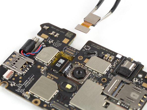

  17. Motorola Moto E4 Plus (XT1771) Motherboard Replacement: crwdns2935265:017crwdnd2935265:01crwdnd2935265:03crwdne2935265:0 Motorola Moto E4 Plus (XT1771) Motherboard Replacement: crwdns2935265:017crwdnd2935265:02crwdnd2935265:03crwdne2935265:0 Motorola Moto E4 Plus (XT1771) Motherboard Replacement: crwdns2935265:017crwdnd2935265:03crwdnd2935265:03crwdne2935265:0
    • Use the flat end of a spudger to pry up and disconnect the front facing camera flex cable.
    • Remove the front facing camera with a pair of tweezers.

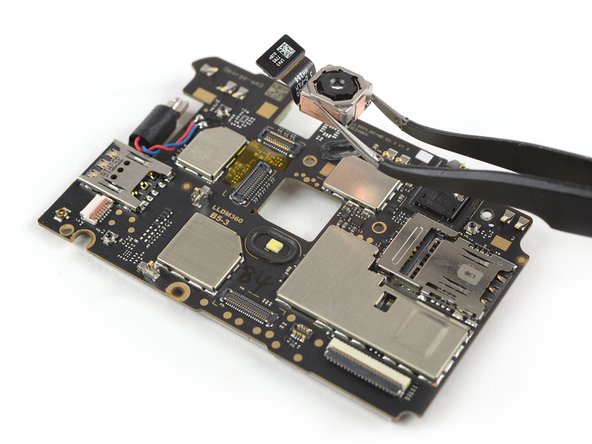

  18. Motorola Moto E4 Plus (XT1771) Motherboard Replacement: crwdns2935265:018crwdnd2935265:01crwdnd2935265:03crwdne2935265:0 Motorola Moto E4 Plus (XT1771) Motherboard Replacement: crwdns2935265:018crwdnd2935265:02crwdnd2935265:03crwdne2935265:0 Motorola Moto E4 Plus (XT1771) Motherboard Replacement: crwdns2935265:018crwdnd2935265:03crwdnd2935265:03crwdne2935265:0
    • Use the flat end of a spudger to pry up and disconnect the rear facing camera flex cable.
    • Remove the rear facing camera with a pair of tweezers.
