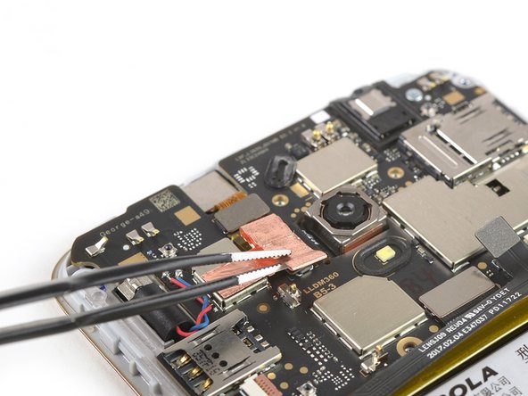

  10. Motorola Moto E4 Plus (XT1771) Front Facing Camera Replacement, Front Facing Camera: crwdns2935265:010crwdnd2935265:01crwdnd2935265:02crwdne2935265:0 Motorola Moto E4 Plus (XT1771) Front Facing Camera Replacement, Front Facing Camera: crwdns2935265:010crwdnd2935265:02crwdnd2935265:02crwdne2935265:0
    • Use a pair of tweezers to peel up the copper tape covering the front facing camera flex connector.
    • Fold the copper tape out of the way.

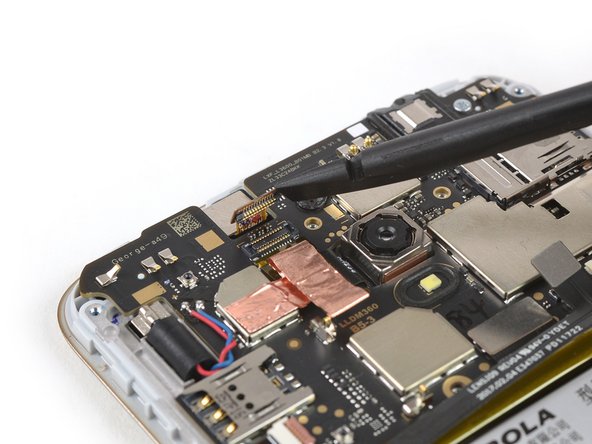

  11. Motorola Moto E4 Plus (XT1771) Front Facing Camera Replacement: crwdns2935265:011crwdnd2935265:01crwdnd2935265:02crwdne2935265:0 Motorola Moto E4 Plus (XT1771) Front Facing Camera Replacement: crwdns2935265:011crwdnd2935265:02crwdnd2935265:02crwdne2935265:0
    • Use the edge of a spudger to pry up and disconnect the front facing camera flex cable.
