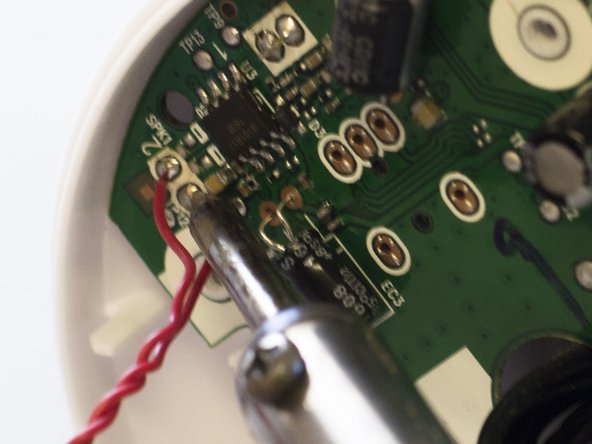

  3. Motorola MBP33SBU Baby Unit Speaker Replacement: crwdns2935265:03crwdnd2935265:01crwdnd2935265:02crwdne2935265:0 Motorola MBP33SBU Baby Unit Speaker Replacement: crwdns2935265:03crwdnd2935265:02crwdnd2935265:02crwdne2935265:0
    • Desolder the wires connecting the speaker to the circuit board.
    • Beware of overheating, the soldering kit is capable of damaging the circuit board.
    • Beware of the potential for personal injury from heated metals.
    • For soldering procedures please refer to iFixit's guide to Soldering Skills.
