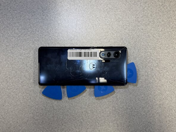

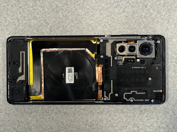

    • Use an iOpener or hair dryer to heat the perimeter of the back cover to loosen the adhesive beneath.
    • Insert the tip of an opening pick 2-3 mm into the seam between the back cover and chassis.
    • Slide the pick around the entire perimeter of the case to sever the adhesive, inserting additional opening picks periodically to prevent the back cover from resealing.
    • If the adhesive hardens as it cools, apply additional heat as needed.
    • Remove the back cover.

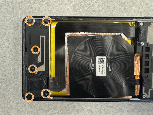

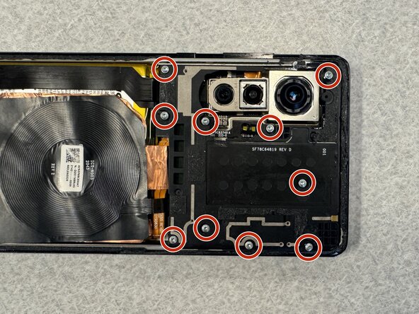

    • Before you begin, discharge your phone battery below 25%. A charged lithium-ion battery can catch fire and/or explode if accidentally punctured.
    • Remove the following T3 Torx screws:
    • Ten 6 mm silver screws
    • Six 5 mm black screws

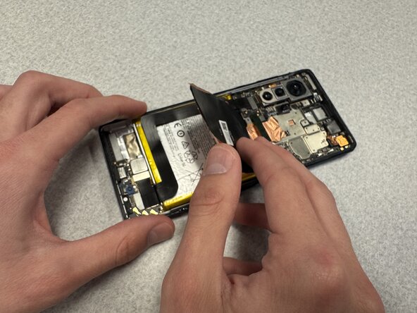

    • Remove the daughterboard and motherboard covers.
    • Disconnect and remove the wireless charging coil.

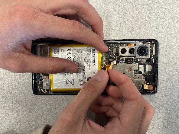

    • Use the pointed end of a spudger to lift and disconnect the battery press connector.
    • If you're completing a camera replacement guide, skip to the beginning of that procedure. It's not necessary to remove the battery.

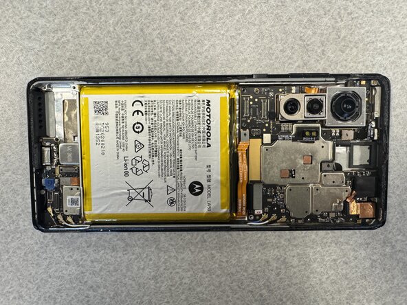

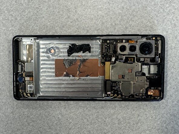

    • Apply a few drops of high-concentration isopropyl alcohol beneath the battery.
    • Tilt the phone to allow the alcohol to reach all of the adhesive.
    • Alternatively, lightly heat the battery with an iOpener or hairdryer.
    • Insert a spudger beneath the battery and gently pry the battery up and out of the chassis.
    • Do not bend, warp, or puncture the battery.
    • Remove the battery.
