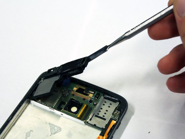

  16. Moto Z Speaker Replacement, Speaker: crwdns2935265:016crwdnd2935265:01crwdnd2935265:01crwdne2935265:0
  17. Moto Z Speaker Replacement: crwdns2935265:017crwdnd2935265:01crwdnd2935265:02crwdne2935265:0 Moto Z Speaker Replacement: crwdns2935265:017crwdnd2935265:02crwdnd2935265:02crwdne2935265:0
    • Lift up and remove the speaker with the spudger.
    • It's best to use the blue iFixit opening tool to pry off the speaker. Metal tools can be dangerous.
Compare your new replacement part to the original part. You may need to transfer remaining components or remove adhesive backings from the new part before installing.
