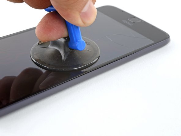

      • Apply a suction cup as close to the heated edge as possible.
      • Lift on the suction cup and insert the tip of an opening pick into the gap.
      • Do not insert the pick more than 1/16" (1.5 mm). Over-inserting the pick may damage the OLED panel.

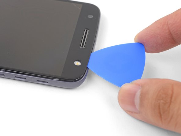

      • Insert an opening pick into the flash side corner of the phone and carefully slice around the flash unit.
      • Do not insert the pick more than 1/16" (1.5 mm) into the edge.
      • Once you are done cutting, leave the pick in the corner to prevent the adhesive from resealing.

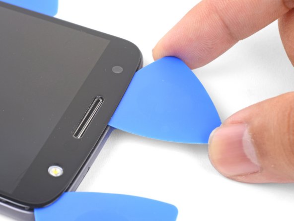

      • Insert an opening pick into the remaining top corner of the phone.
      • Carefully slice through the adhesive across the top of the phone.
      • Do not insert the pick beyond 1/2" (12.5 mm).

      • Carefully twist the first opening pick slightly to help release the edge adhesive.
      • Repeat the same process for each remaining pick, moving them as necessary and twisting slightly to release the adhesive.

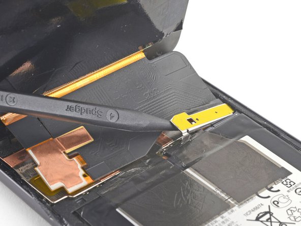

      • Use the point of a spudger to pry the display cable shield up.
      • Remove the display cable shield.

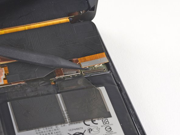

    14. Moto Z Rear-Facing Camera Replacement: crwdns2935265:014crwdnd2935265:01crwdnd2935265:02crwdne2935265:0 Moto Z Rear-Facing Camera Replacement: crwdns2935265:014crwdnd2935265:02crwdnd2935265:02crwdne2935265:0
      • Use the point of the spudger to lift and disconnect the display cable connector from its socket.

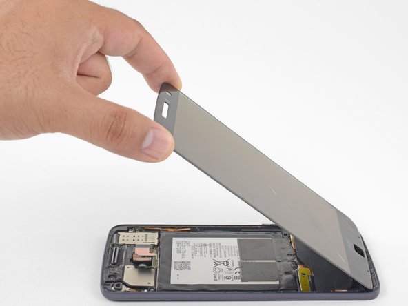

      • Remove the display assembly.
      • Compare your new replacement part to the original part. You may need to transfer remaining components (such as the flash lens) or remove adhesive backings from the new part before installing.
      • Before you reinstall the display assembly, thoroughly remove any remaining adhesive and glass from the frame.
      • After removing all traces of glue and glass from the frame, clean the adhesion areas with 90% (or higher) isopropyl alcohol and a lint-free cloth or coffee filter.
      • Be sure to turn on your phone and test your repair before installing new adhesive and resealing the phone.
      • Use the Motorola Moto Z display adhesive to reseal your phone. Follow this guide for instructions on how to apply adhesive to the replacement screen.

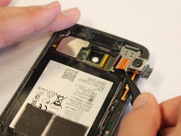

    1. Moto Z Rear-Facing Camera Replacement, Rear-Facing Camera: crwdns2935265:016crwdnd2935265:01crwdnd2935265:01crwdne2935265:0
      • Place the tweezers under the copper tab on the top of the device.
      • Make sure you have a firm grip on the tab with the tweezers.
      • Make sure not to puncture the battery with the metal tweezers as it's a fire hazard.
    2. Moto Z Rear-Facing Camera Replacement: crwdns2935265:017crwdnd2935265:01crwdnd2935265:01crwdne2935265:0
      • Slowly and carefully lift up on the tab until it pops out of the phone and is only connected by the black tape.
    3. Moto Z Rear-Facing Camera Replacement: crwdns2935265:018crwdnd2935265:01crwdnd2935265:02crwdne2935265:0 Moto Z Rear-Facing Camera Replacement: crwdns2935265:018crwdnd2935265:02crwdnd2935265:02crwdne2935265:0
      • Using the tweezers, firmly grab the black connecting tape closest to the lens.
      • Gently pull to the right until the camera (lens and black tape) disconnects from the device.
Compare your new replacement part to the original part. You may need to transfer remaining components or remove adhesive backings from the new part before installing.
