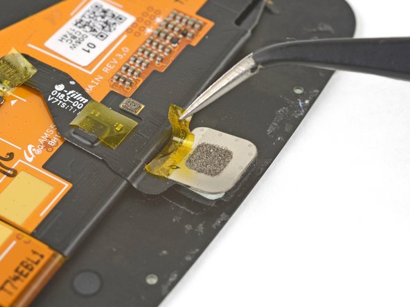

      • Use tweezers to peel off any tape on the home button connector and home button

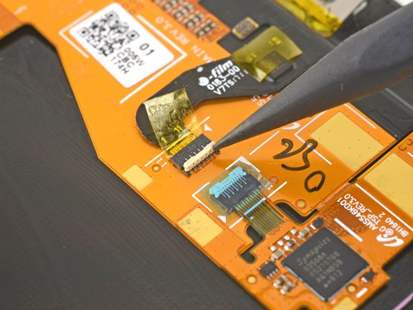

      • Use the point of a spudger to flip up the home button connector's lock.

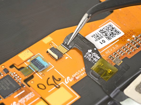

    3. Moto Z Display Assembly Replacement: crwdns2935265:018crwdnd2935265:01crwdnd2935265:02crwdne2935265:0 Moto Z Display Assembly Replacement: crwdns2935265:018crwdnd2935265:02crwdnd2935265:02crwdne2935265:0
      • Use tweezers to carefully pull the home button cable straight out of the socket.
