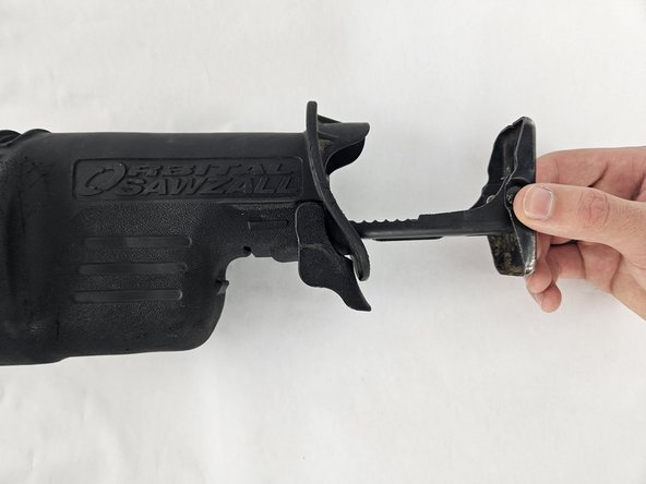

  2. Milwaukee Sawzall 6520-21 Motor Replacement: crwdns2935265:02crwdnd2935265:01crwdnd2935265:02crwdne2935265:0 Milwaukee Sawzall 6520-21 Motor Replacement: crwdns2935265:02crwdnd2935265:02crwdnd2935265:02crwdne2935265:0
    • Two rubber rings around the divots hold the cushion grip to the handle.
    • Lift off the cushion grip.

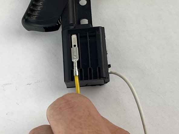

  4. Milwaukee Sawzall 6520-21 Motor Replacement: crwdns2935265:04crwdnd2935265:01crwdnd2935265:03crwdne2935265:0 Milwaukee Sawzall 6520-21 Motor Replacement: crwdns2935265:04crwdnd2935265:02crwdnd2935265:03crwdne2935265:0 Milwaukee Sawzall 6520-21 Motor Replacement: crwdns2935265:04crwdnd2935265:03crwdnd2935265:03crwdne2935265:0

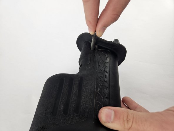

    • Take a 1.5mm flathead screwdriver and insert it into the pin lock above each of the wires:
    • Black wire: Insert it on the left side of the pin. Pull the wire while gently rotating it clockwise
    • Black wire: Insert it on the bottom side of the pin and gently rotate it counterclockwise
    • White wire: Insert it on the right of the pin and gently rotate it counterclockwise

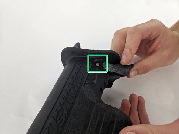

  5. Milwaukee Sawzall 6520-21 Motor Replacement, Trigger: crwdns2935265:05crwdnd2935265:01crwdnd2935265:02crwdne2935265:0 Milwaukee Sawzall 6520-21 Motor Replacement, Trigger: crwdns2935265:05crwdnd2935265:02crwdnd2935265:02crwdne2935265:0
    • Gently pull the yellow electrical wire.
  6. Milwaukee Sawzall 6520-21 Motor Replacement: crwdns2935265:06crwdnd2935265:01crwdnd2935265:03crwdne2935265:0 Milwaukee Sawzall 6520-21 Motor Replacement: crwdns2935265:06crwdnd2935265:02crwdnd2935265:03crwdne2935265:0 Milwaukee Sawzall 6520-21 Motor Replacement: crwdns2935265:06crwdnd2935265:03crwdnd2935265:03crwdne2935265:0

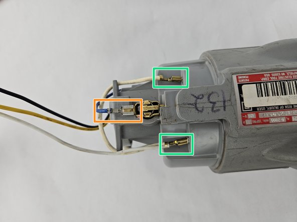

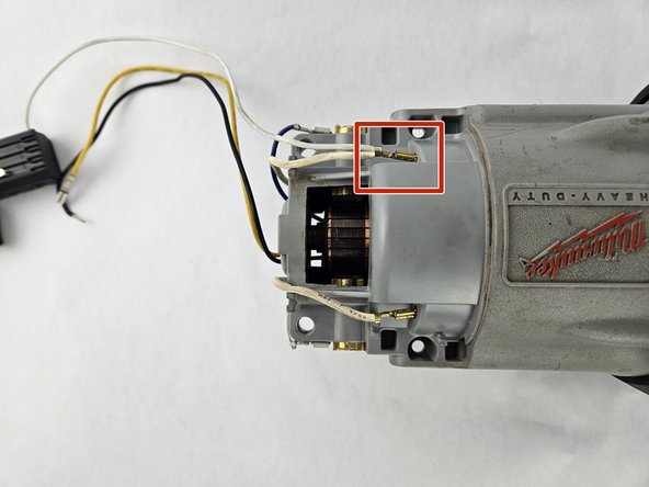

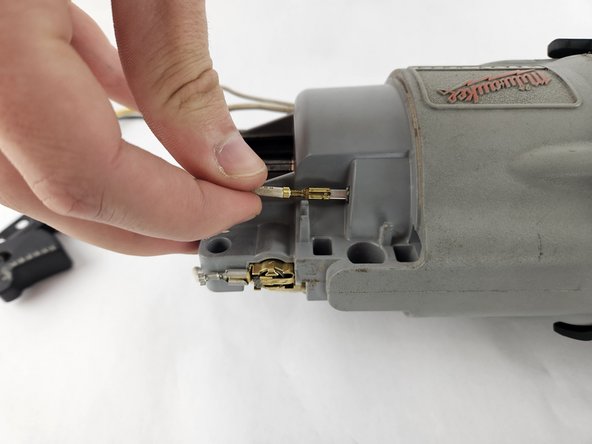

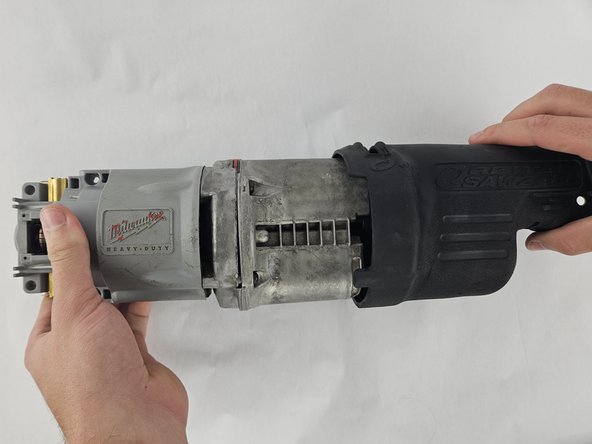

    • The left half handle and motor housing can separate without difficulty.
    • The trigger paired with the motor housing wire requires two removals.
    • Gently remove both white wires.

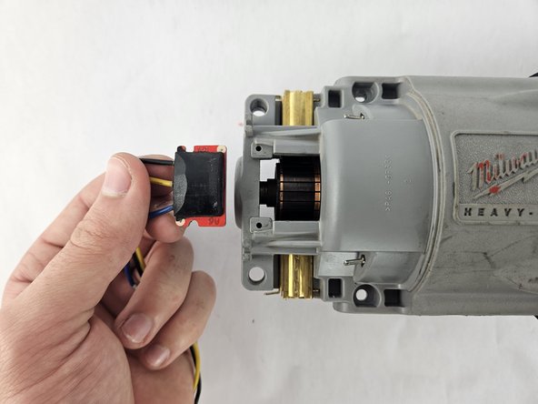

    • Gently slide the following from the motor housing:
    • Black chip.
    • Blue electrical wire.
    • Two, white electrical wires.

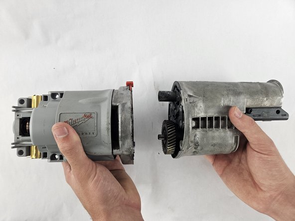

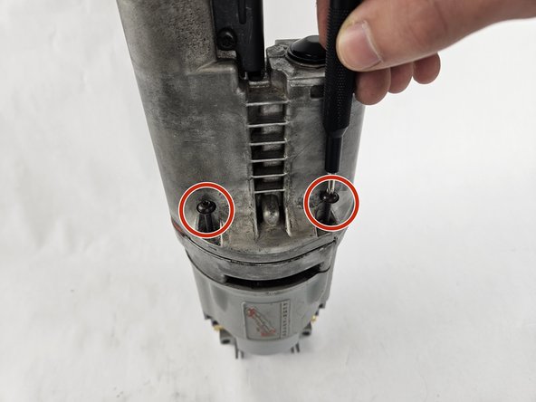

  10. Milwaukee Sawzall 6520-21 Motor Replacement: crwdns2935265:010crwdnd2935265:01crwdnd2935265:03crwdne2935265:0 Milwaukee Sawzall 6520-21 Motor Replacement: crwdns2935265:010crwdnd2935265:02crwdnd2935265:03crwdne2935265:0 Milwaukee Sawzall 6520-21 Motor Replacement: crwdns2935265:010crwdnd2935265:03crwdnd2935265:03crwdne2935265:0
    • Use a T20 Torx screwdriver to remove the following four screws from the gearcase:
    • K50 x 60 mm Washer Hd. PT Screw
    • Detach the motor housing from the gearcase.
