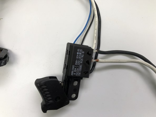

  3. Milwaukee Reciprocating Saw 6538-21-B36B (2010) Power Cord Replacement: crwdns2935265:03crwdnd2935265:01crwdnd2935265:01crwdne2935265:0
    • Use light pressure to pull the white and black wires from the trigger mechanism.

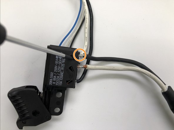

  4. Milwaukee Reciprocating Saw 6538-21-B36B (2010) Power Cord Replacement: crwdns2935265:04crwdnd2935265:01crwdnd2935265:03crwdne2935265:0 Milwaukee Reciprocating Saw 6538-21-B36B (2010) Power Cord Replacement: crwdns2935265:04crwdnd2935265:02crwdnd2935265:03crwdne2935265:0 Milwaukee Reciprocating Saw 6538-21-B36B (2010) Power Cord Replacement: crwdns2935265:04crwdnd2935265:03crwdnd2935265:03crwdne2935265:0
    • Notice the small windows on the side of the trigger mechanism; this is where the wires attach.
    • Apply pressure to open these windows with a small flathead screwdriver; this is to ensure the wires are securely in place.
    • Insert the white and black wires from the replacement cord in the sockets perpendicular to the windows.
