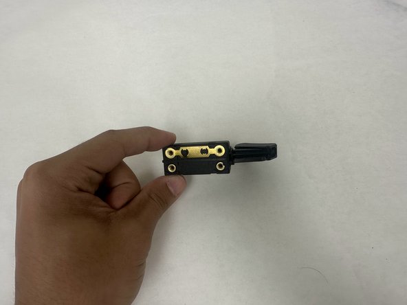

  3. Milwaukee Circular Saw 263020 B57A 2008 Trigger Replacement, Trigger: crwdns2935265:03crwdnd2935265:01crwdnd2935265:02crwdne2935265:0 Milwaukee Circular Saw 263020 B57A 2008 Trigger Replacement, Trigger: crwdns2935265:03crwdnd2935265:02crwdnd2935265:02crwdne2935265:0
    • Remove four 10 mm screws that attach the wires to the trigger using a Phillips #2 screwdriver.
    • Gently move the wires from the trigger (the wires should just come off).
