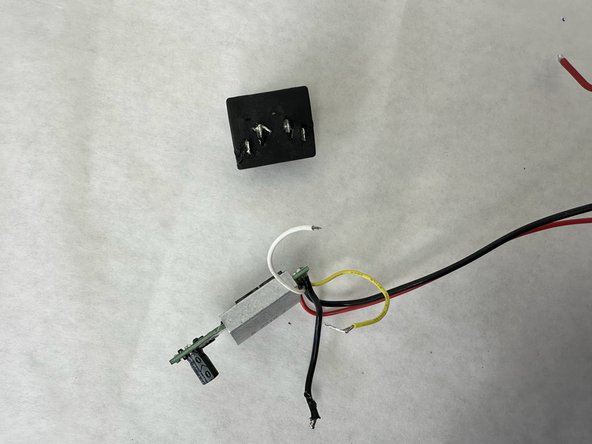

  4. Milwaukee Circular Saw 263020 B57A 2008 Battery Replacement: crwdns2935265:04crwdnd2935265:01crwdnd2935265:01crwdne2935265:0
    • Carefully remove the rubber covers from the black and red wires of the battery with a pair of tweezers.

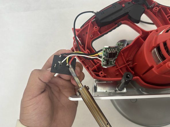

  5. Milwaukee Circular Saw 263020 B57A 2008 Battery Replacement: crwdns2935265:05crwdnd2935265:01crwdnd2935265:03crwdne2935265:0 Milwaukee Circular Saw 263020 B57A 2008 Battery Replacement: crwdns2935265:05crwdnd2935265:02crwdnd2935265:03crwdne2935265:0 Milwaukee Circular Saw 263020 B57A 2008 Battery Replacement: crwdns2935265:05crwdnd2935265:03crwdnd2935265:03crwdne2935265:0
    • Carefully desolder and separate the wires from the battery compartment.
    • Gently pull the wires off with your hands being careful of the heat.
