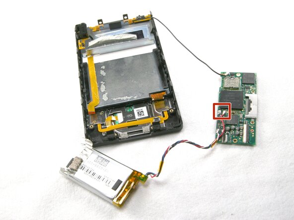

    7. Microsoft Zune 80 Battery Replacement: crwdns2935265:012crwdnd2935265:01crwdnd2935265:03crwdne2935265:0 Microsoft Zune 80 Battery Replacement: crwdns2935265:012crwdnd2935265:02crwdnd2935265:03crwdne2935265:0 Microsoft Zune 80 Battery Replacement: crwdns2935265:012crwdnd2935265:03crwdnd2935265:03crwdne2935265:0
      • Remove the battery from the device with the cables still connected.
      • Carefully lift up the mother board located at the base of the Zune. Unclip the orange ribbon cable in the same manner as in the previous steps.
      • Use a soldering iron to desolder the battery connections from the motherboard.
      • Be cautious when using a soldering iron—it gets extremely hot and can cause burns. Always work in a well-ventilated area, as soldering produces fumes that can be harmful if inhaled.
