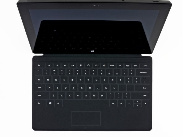

    • Just like your first big-kid bike, this laptop tablet comes with a kickstand to prop it up in notebook mode.
    • One of the most notable features of the Surface is its Touch Cover keyboard, which protects the screen when closed and provides a full QWERTY typing experience when open.
    • For users who find the Touch Cover to be too much a compromise, Microsoft offers the Type Cover, a chiclet keyboard that also folds up to protect the Surface's LCD.

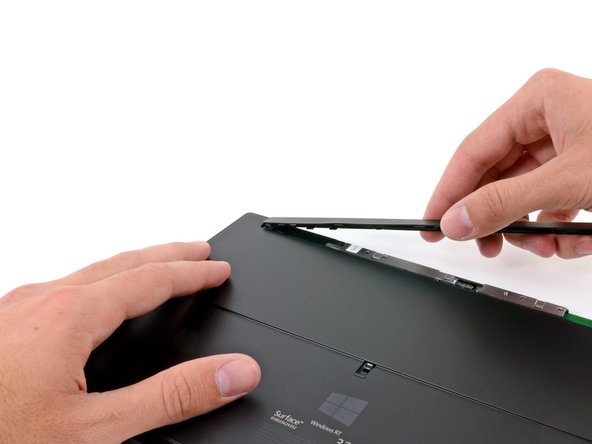

    • We begin our expedition by removing the kickstand.
    • Fun fact: the kickstand is held in place by a few Torx screws.
    • Sans kickstand, we can easily view the markings on the back of the Surface's rear case. The Surface with Windows RT has a model number of 1516.

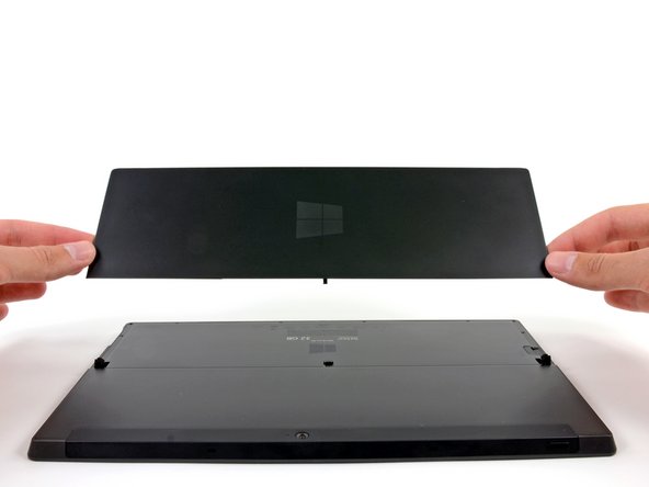

  5. Microsoft Surface Teardown: crwdns2935265:05crwdnd2935265:01crwdnd2935265:03crwdne2935265:0 Microsoft Surface Teardown: crwdns2935265:05crwdnd2935265:02crwdnd2935265:03crwdne2935265:0 Microsoft Surface Teardown: crwdns2935265:05crwdnd2935265:03crwdnd2935265:03crwdne2935265:0

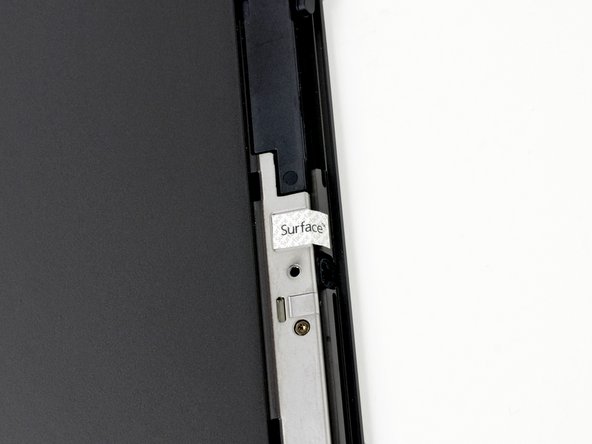

    • Small bezels tend to hide screws, so the first place we look to open the Surface is its long plastic camera cover.
    • Our pictures make it look easy, but removing this plastic cover took about half an hour and a lot of careful prying.
    • Chalk it up to inexperience. This step should take less than ten minutes once we create guides for it.
    • Not only did we find the screws we were searching for, but there is also what appears to be a tamper-evident seal that simply reads "Surface."
    • The tamper-evident label is composed of multiple sections. Unfortunately, it breaks apart upon removal.

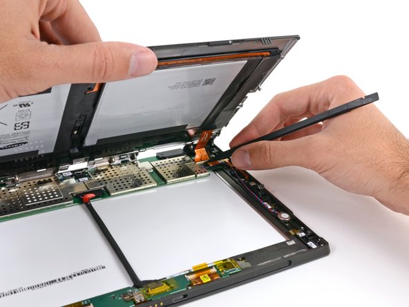

    • After removing a total of 17 T5 Torx screws, (10 under the kickstand and 7 under the camera cover), the rear case comes right off—almost.
    • A lone ribbon cable still tethers the battery to a ZIF connector on the Surface's motherboard, which we make quick work of with the ever-trusty spudger.

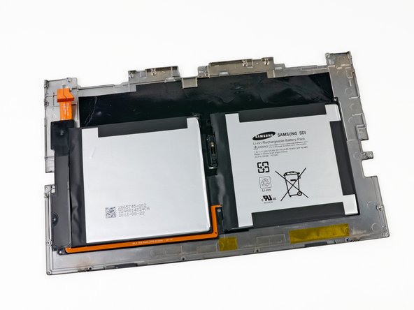

    • The big question of the day: is the battery easily removed?
    • Answer: Yes. It's glued in, but it's way easier to remove than on the iPad. A couple of minutes of spudging around, and it's out.
    • We get our first look at the battery. As is the norm, the dual battery cell is adhered to the VaporMg rear case.
    • The 7.4 V, 31.5 Wh battery is manufactured by Samsung. It fits right in between the iPad 2's 25 Wh battery, and the iPad 3's 42.5 Wh unit.

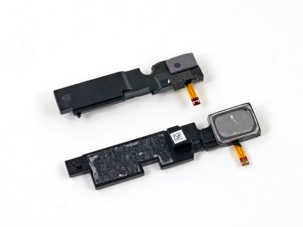

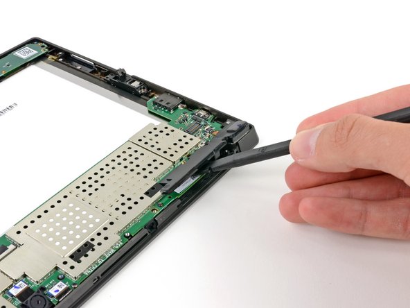

    • Next we find a large orange ribbon cable leading to the "Apple-esque" magnetic charging port. The microSDXC card slot that hides underneath the kickstand is also attached to this ribbon cable. And not a single bother was given that day, so we proceeded to dismantle the speakers.
    • We love modular components inside tablets and smartphones, and these speakers fit that bill. A little bit of spudgering, and our Surface has gone silent.
    • With two speaker assemblies we are living in stereo.

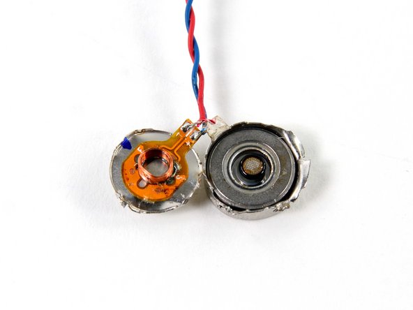

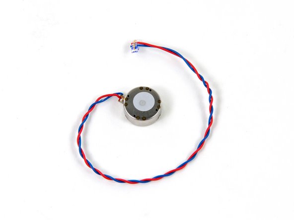

  9. Microsoft Surface Teardown: crwdns2935265:09crwdnd2935265:01crwdnd2935265:03crwdne2935265:0 Microsoft Surface Teardown: crwdns2935265:09crwdnd2935265:02crwdnd2935265:03crwdne2935265:0 Microsoft Surface Teardown: crwdns2935265:09crwdnd2935265:03crwdnd2935265:03crwdne2935265:0
    • Next to the display in the front case we find, well, some speaker-looking thing.
    • Inside the case of our mystery component we found a voice coil, so we're pretty sure it's some sort of microphone or secondary speaker, or possibly a linear vibration motor.
    • Update: It looks like a Precision Microdrives Precision Haptic Linear Resonant Vibrator, responsible for haptic feedback.

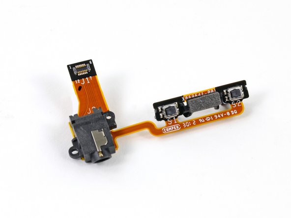

  10. Microsoft Surface Teardown: crwdns2935265:010crwdnd2935265:01crwdnd2935265:02crwdne2935265:0 Microsoft Surface Teardown: crwdns2935265:010crwdnd2935265:02crwdnd2935265:02crwdne2935265:0
    • The headphone jack and volume buttons aren't holding on to their real estate too tightly, and they easily come out next.
    • We still count this as a modular component, even though it's two things on the same ribbon cable. We have certainly seen worse lately as far as modularity goes.

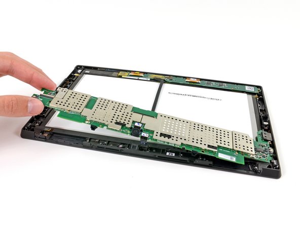

  11. Microsoft Surface Teardown: crwdns2935265:011crwdnd2935265:01crwdnd2935265:02crwdne2935265:0 Microsoft Surface Teardown: crwdns2935265:011crwdnd2935265:02crwdnd2935265:02crwdne2935265:0
    • We disconnect the display and digitizer cable from the motherboard with the help of a plastic opening tool.
    • Let's get the motherboard out and see what goodies are attached to it.

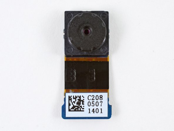

  13. Microsoft Surface Teardown: crwdns2935265:013crwdnd2935265:01crwdnd2935265:02crwdne2935265:0 Microsoft Surface Teardown: crwdns2935265:013crwdnd2935265:02crwdnd2935265:02crwdne2935265:0
    • Off comes another 720p camera from the motherboard. It feels like we've done this before…
    • The exclusion of a 1080p rear-facing camera either means cost was a big concern, or that Microsoft's designers don't expect you to use the Surface as your main camera.
    • Perhaps they too realized how goofy you might look when taking pictures with a tablet.

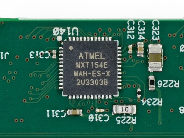

  16. Microsoft Surface Teardown: crwdns2935265:016crwdnd2935265:01crwdnd2935265:03crwdne2935265:0 Microsoft Surface Teardown: crwdns2935265:016crwdnd2935265:02crwdnd2935265:03crwdne2935265:0 Microsoft Surface Teardown: crwdns2935265:016crwdnd2935265:03crwdnd2935265:03crwdne2935265:0
    • Following the mother(board) is the daughter(board) featuring three Atmel MXT154E touchscreen controllers.
    • This board only deals with matters pertaining to the 10.6" touchscreen. Everything else is either located on the motherboard or on its own ribbon cable.

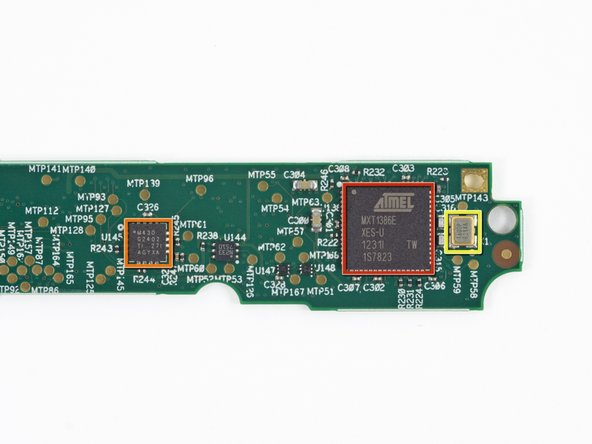

  17. Microsoft Surface Teardown: crwdns2935265:017crwdnd2935265:01crwdnd2935265:02crwdne2935265:0 Microsoft Surface Teardown: crwdns2935265:017crwdnd2935265:02crwdnd2935265:02crwdne2935265:0
    • The back side of the daughterboard contains only a few prominent ICs:
    • Atmel MXT1386 touchscreen controller
    • TI MSP430G2402 Microcontroller
    • 1600P E284A Crystal Oscillator

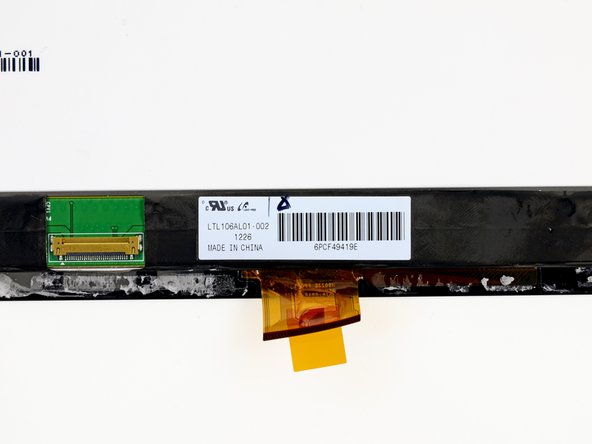

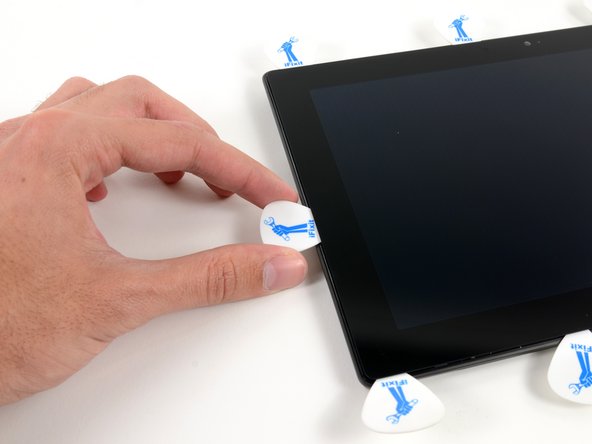

    • We tried to remove the keyboard connector, but were disappointed to find it's wedged firmly under the LCD. Replacing the connector will require either bending the magnesium frame or separating the display.
    • We were on a teardown roll, so we pressed on and pulled the display from the VaporMG frame, which required a heat gun, some guitar picks, and plenty of patience.
    • The display's LTL106AL01-002 label indicates Samsung as the manufacturer. Its sister panel, the LTL106AL01-001, appears to be 1280 x 800 resolution. We didn't test the Surface's display before taking it apart, and we trust Microsoft not to lie…
    • But maybe someone can do a quicky double-check on the display resolution, just for giggles?

This site says the display LTL106AL01-002 has the 1280 x 800 resolution also...
http://www.alibaba.com/product-gs/664763...
Mile Zajkovski - crwdns2934203:0crwdne2934203:0
This site states the proper resolution: http://xingkong.en.alibaba.com/product/6...
