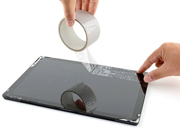

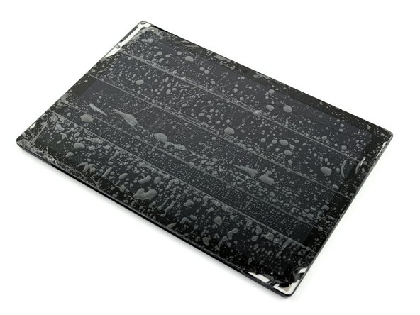

    1. Microsoft Surface Pro X Screen Replacement, Tape the screen: crwdns2935265:06crwdnd2935265:01crwdnd2935265:03crwdne2935265:0 Microsoft Surface Pro X Screen Replacement, Tape the screen: crwdns2935265:06crwdnd2935265:02crwdnd2935265:03crwdne2935265:0 Microsoft Surface Pro X Screen Replacement, Tape the screen: crwdns2935265:06crwdnd2935265:03crwdnd2935265:03crwdne2935265:0
      • Wear safety glasses to protect your eyes, and be careful not to damage the LCD screen.
      • If your display glass is cracked, keep further breakage contained and prevent bodily harm during your repair by taping the glass.
      • Lay overlapping strips of clear packing tape over the Surface’s display until the whole face is covered.
      • This will keep glass shards contained and provide structural integrity when prying and lifting the display.
      • Do your best to follow the rest of the guide as described. However, once the glass is broken, it will likely continue to crack as you work, and you may need to use a metal prying tool to scoop the glass out.

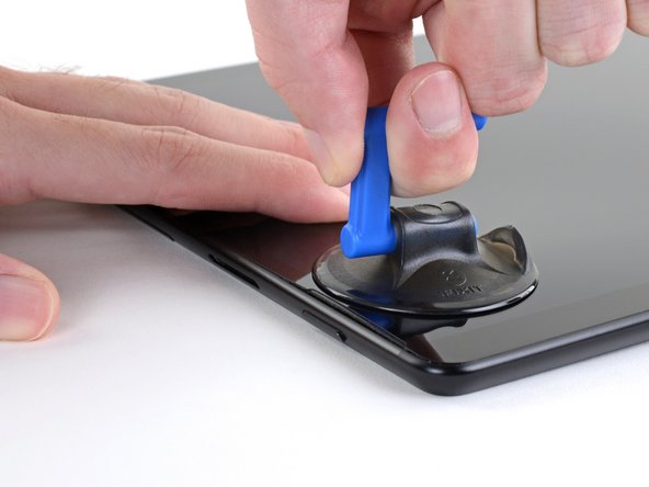

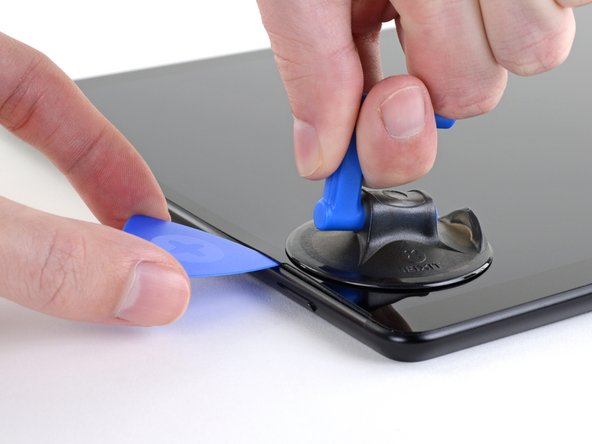

    2. Microsoft Surface Pro X Screen Replacement, Apply a suction cup to the screen: crwdns2935265:07crwdnd2935265:01crwdnd2935265:02crwdne2935265:0 Microsoft Surface Pro X Screen Replacement, Apply a suction cup to the screen: crwdns2935265:07crwdnd2935265:02crwdnd2935265:02crwdne2935265:0
      • Wear safety glasses during the screen removal procedure in case the glass shatters while you're working.
      • There is a significant chance that you may break the unreinforced and fragile display panel during this procedure. Be sure to work slowly and be extremely careful while slicing through the adhesive.
      • Place your tablet on your work surface so that the screen is facing up.
      • Apply a suction cup to the screen next to the right speaker grille.
    3. Microsoft Surface Pro X Screen Replacement, Secure the tablet: crwdns2935265:08crwdnd2935265:01crwdnd2935265:01crwdne2935265:0
      • Place your hand on the screen next to the suction cup to secure the Surface while you lift up the screen.
    4. Microsoft Surface Pro X Screen Replacement, Create a gap between the screen and frame: crwdns2935265:09crwdnd2935265:01crwdnd2935265:03crwdne2935265:0 Microsoft Surface Pro X Screen Replacement, Create a gap between the screen and frame: crwdns2935265:09crwdnd2935265:02crwdnd2935265:03crwdne2935265:0 Microsoft Surface Pro X Screen Replacement, Create a gap between the screen and frame: crwdns2935265:09crwdnd2935265:03crwdnd2935265:03crwdne2935265:0
      • Don't insert the opening pick more than 3 mm while cutting through the adhesive on the right, bottom, and left edge.
      • Lift up on the suction cup to create a gap between the screen and the frame.
      • The gap only needs to be wide enough to slide in an opening pick.
      • Insert an opening pick about 2 mm into the gap. Leave the opening pick in the gap to prevent it from resealing.

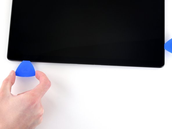

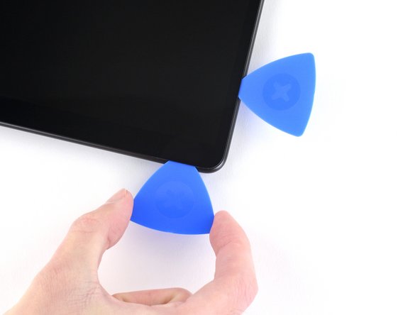

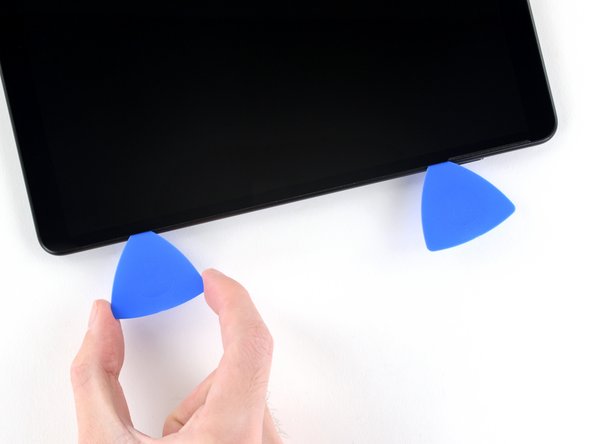

    5. Microsoft Surface Pro X Screen Replacement, Cut through the screen adhesive: crwdns2935265:010crwdnd2935265:01crwdnd2935265:02crwdne2935265:0 Microsoft Surface Pro X Screen Replacement, Cut through the screen adhesive: crwdns2935265:010crwdnd2935265:02crwdnd2935265:02crwdne2935265:0
      • Insert a second opening pick into the gap between the screen and the frame.
      • Slide the pick down the right edge of the Surface to slice through the adhesive under the screen.
      • Leave this opening pick in the right edge to prevent the adhesive from resealing.
    6. Microsoft Surface Pro X Screen Replacement: crwdns2935265:011crwdnd2935265:01crwdnd2935265:03crwdne2935265:0 Microsoft Surface Pro X Screen Replacement: crwdns2935265:011crwdnd2935265:02crwdnd2935265:03crwdne2935265:0 Microsoft Surface Pro X Screen Replacement: crwdns2935265:011crwdnd2935265:03crwdnd2935265:03crwdne2935265:0
      • Don't insert the pick more than 3 mm while cutting through the screen adhesive on the bottom edge or you may damage delicate components on the screen.
      • Insert a third opening pick into the bottom right corner and slide it around the corner toward the bottom edge.
    7. Microsoft Surface Pro X Screen Replacement: crwdns2935265:012crwdnd2935265:01crwdnd2935265:02crwdne2935265:0 Microsoft Surface Pro X Screen Replacement: crwdns2935265:012crwdnd2935265:02crwdnd2935265:02crwdne2935265:0
      • Slide the pick along the bottom edge of the Surface to cut through the screen adhesive.
      • Leave this pick in the bottom edge to prevent the adhesive from resealing.

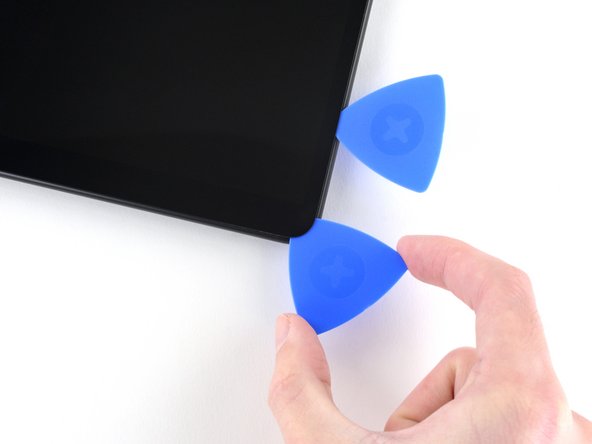

    8. Microsoft Surface Pro X Screen Replacement: crwdns2935265:013crwdnd2935265:01crwdnd2935265:03crwdne2935265:0 Microsoft Surface Pro X Screen Replacement: crwdns2935265:013crwdnd2935265:02crwdnd2935265:03crwdne2935265:0 Microsoft Surface Pro X Screen Replacement: crwdns2935265:013crwdnd2935265:03crwdnd2935265:03crwdne2935265:0
      • Insert a fourth opening pick into the bottom left corner and slide it around the corner toward the left edge.
      • Slide the pick along the left edge of the Surface to cut through the screen adhesive.
      • Leave this pick in the left edge to prevent the adhesive from resealing.

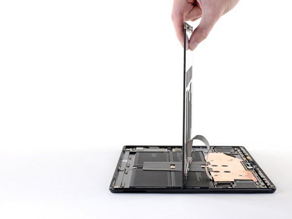

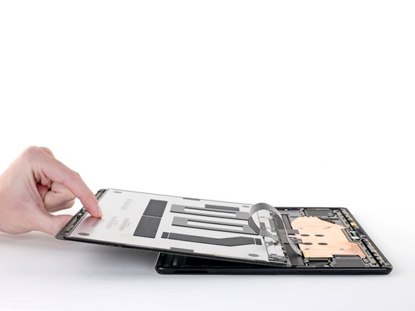

    10. Microsoft Surface Pro X Screen Replacement, Open the Surface: crwdns2935265:015crwdnd2935265:01crwdnd2935265:03crwdne2935265:0 Microsoft Surface Pro X Screen Replacement, Open the Surface: crwdns2935265:015crwdnd2935265:02crwdnd2935265:03crwdne2935265:0 Microsoft Surface Pro X Screen Replacement, Open the Surface: crwdns2935265:015crwdnd2935265:03crwdnd2935265:03crwdne2935265:0
      • Do not remove the screen yet. It is still connected to the motherboard by the display cable. Keep the screen as close as possible to the Surface's frame to avoid straining the display cable.
      • Avoid hitting the battery with the screen during this procedure. A punctured or bent battery may leak dangerous chemicals or cause a thermal event.
      • Lift up the top edge of the screen so that it is at a 30° angle with the frame.
      • If you encounter any resistance, stop and check that all the adhesive is separated. Use an opening pick to cut through any remaining adhesive.
      • Rotate the screen so that its bottom edge is in the middle of the frame. The screen should be perpendicular to the frame.
      • Rotate the screen 90° so that it is facing down. Place the screen on the frame.

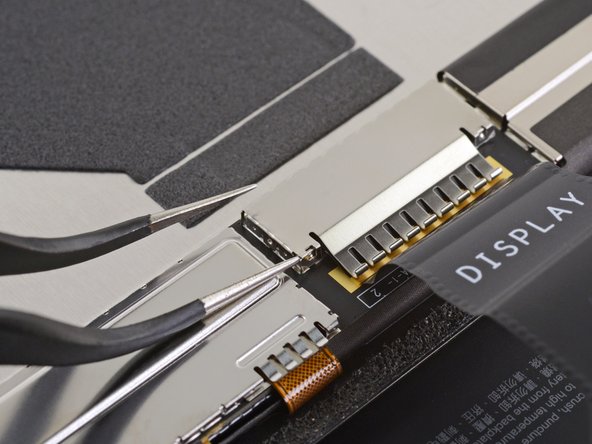

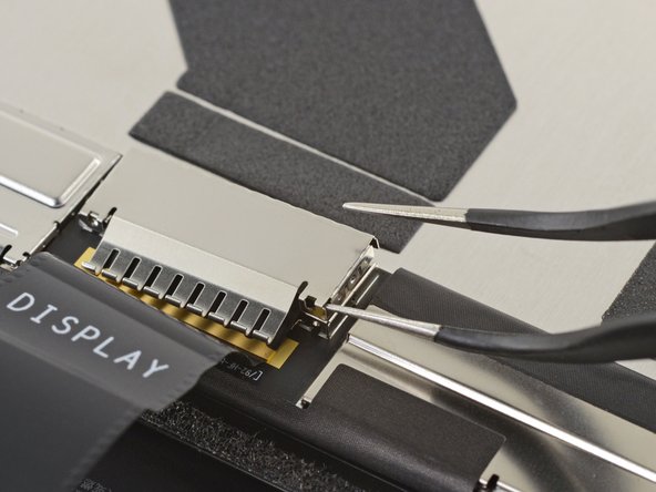

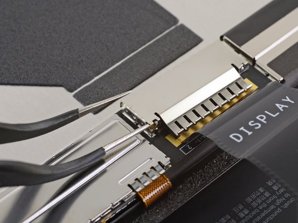

    1. Microsoft Surface Pro X Screen Replacement, Remove the display cable shield: crwdns2935265:016crwdnd2935265:01crwdnd2935265:03crwdne2935265:0 Microsoft Surface Pro X Screen Replacement, Remove the display cable shield: crwdns2935265:016crwdnd2935265:02crwdnd2935265:03crwdne2935265:0 Microsoft Surface Pro X Screen Replacement, Remove the display cable shield: crwdns2935265:016crwdnd2935265:03crwdnd2935265:03crwdne2935265:0
      • Insert a tine of a pair of pointed tweezers under the bottom right corner of the display cable shield (where the display cable is oriented down).
      • Lift up the corner to detach it from the screen.
    2. Microsoft Surface Pro X Screen Replacement: crwdns2935265:017crwdnd2935265:01crwdnd2935265:02crwdne2935265:0 Microsoft Surface Pro X Screen Replacement: crwdns2935265:017crwdnd2935265:02crwdnd2935265:02crwdne2935265:0
      • Repeat the previous step for the bottom right corner.
    3. Microsoft Surface Pro X Screen Replacement: crwdns2935265:018crwdnd2935265:01crwdnd2935265:01crwdne2935265:0
      • Remove the display cable shield from the screen.
      • If the display cable shield isn't completely detached from the screen, pry up additional areas around the edges of the shield.

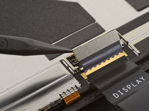

    4. Microsoft Surface Pro X Screen Replacement, Disconnect the screen: crwdns2935265:019crwdnd2935265:01crwdnd2935265:02crwdne2935265:0 Microsoft Surface Pro X Screen Replacement, Disconnect the screen: crwdns2935265:019crwdnd2935265:02crwdnd2935265:02crwdne2935265:0
      • Insert the pointed end of a spudger under the right side of the display cable press connector.
      • Lift up the right side of the press connector to detach it from the display cable socket on the screen.
    5. Microsoft Surface Pro X Screen Replacement: crwdns2935265:020crwdnd2935265:01crwdnd2935265:02crwdne2935265:0 Microsoft Surface Pro X Screen Replacement: crwdns2935265:020crwdnd2935265:02crwdnd2935265:02crwdne2935265:0
      • Repeat the previous step on the left side of the display cable connector to fully disconnect it from the screen.
      • To re-attach press connectors like this one, carefully align and press down on one side until it clicks into place, then repeat on the other side. Do not press down on the middle. If the connector is misaligned, the pins can bend, causing permanent damage.

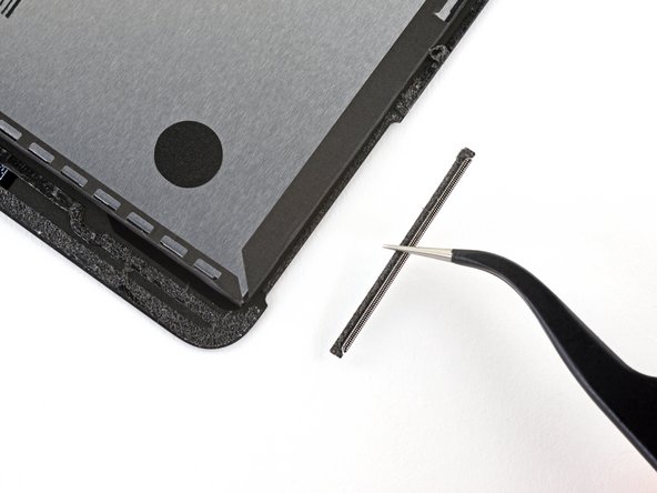

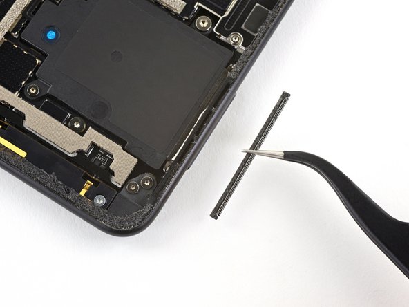

    6. Microsoft Surface Pro X Screen Replacement, Remove the screen: crwdns2935265:021crwdnd2935265:01crwdnd2935265:01crwdne2935265:0
      • Remove the screen from the frame.

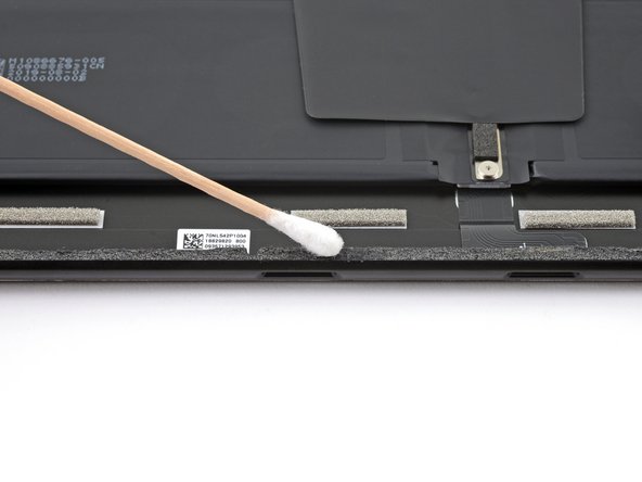

    9. Microsoft Surface Pro X Screen Replacement, Screen adhesive information: crwdns2935265:024crwdnd2935265:01crwdnd2935265:03crwdne2935265:0 Microsoft Surface Pro X Screen Replacement, Screen adhesive information: crwdns2935265:024crwdnd2935265:02crwdnd2935265:03crwdne2935265:0 Microsoft Surface Pro X Screen Replacement, Screen adhesive information: crwdns2935265:024crwdnd2935265:03crwdnd2935265:03crwdne2935265:0
      • If you are going to replace the screen adhesive, follow these steps:
      • Apply a few drops of high-concentration (90% or higher) isopropyl alcohol to the adhesive.
      • Use a cotton swab or the flat end of a spudger to scrape away the adhesive.
      • Use a lint-free cloth or coffee filter to wipe away any remaining adhesive.
      • Allow the surface to dry completely before applying replacement adhesive.
      • Apply new adhesive strips or pre-cut adhesive to the frame where the old screen adhesive was located.
