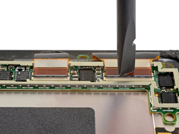

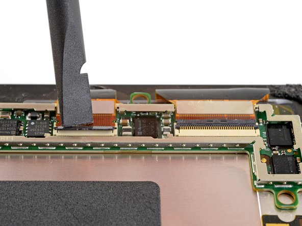

    1. Microsoft Surface Pro 6 Screen Replacement, Disconnect the display board: crwdns2935265:023crwdnd2935265:01crwdnd2935265:03crwdne2935265:0 Microsoft Surface Pro 6 Screen Replacement, Disconnect the display board: crwdns2935265:023crwdnd2935265:02crwdnd2935265:03crwdne2935265:0 Microsoft Surface Pro 6 Screen Replacement, Disconnect the display board: crwdns2935265:023crwdnd2935265:03crwdnd2935265:03crwdne2935265:0
      • Use a spudger to flip up the small locking flaps on the display cable ZIF connectors.

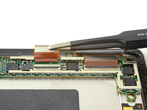

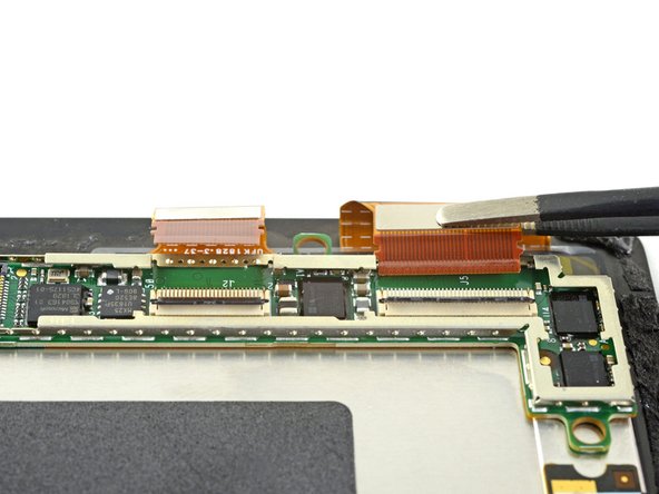

    2. Microsoft Surface Pro 6 Screen Replacement: crwdns2935265:024crwdnd2935265:01crwdnd2935265:03crwdne2935265:0 Microsoft Surface Pro 6 Screen Replacement: crwdns2935265:024crwdnd2935265:02crwdnd2935265:03crwdne2935265:0 Microsoft Surface Pro 6 Screen Replacement: crwdns2935265:024crwdnd2935265:03crwdnd2935265:03crwdne2935265:0
      • Use tweezers to slide the display cables straight out of their sockets on the display board.
