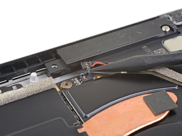

  26. Microsoft Surface Pro 6 Right Speaker Replacement, Disconnect the right speaker: crwdns2935265:026crwdnd2935265:01crwdnd2935265:02crwdne2935265:0 Microsoft Surface Pro 6 Right Speaker Replacement, Disconnect the right speaker: crwdns2935265:026crwdnd2935265:02crwdnd2935265:02crwdne2935265:0
    • Use the point of a spudger to lift the right speaker connector out of its socket on the motherboard.

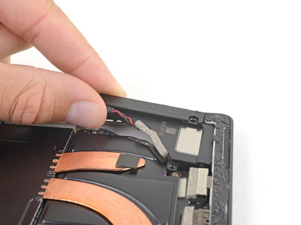

  28. Microsoft Surface Pro 6 Right Speaker Replacement, Remove the speaker: crwdns2935265:028crwdnd2935265:01crwdnd2935265:03crwdne2935265:0 Microsoft Surface Pro 6 Right Speaker Replacement, Remove the speaker: crwdns2935265:028crwdnd2935265:02crwdnd2935265:03crwdne2935265:0 Microsoft Surface Pro 6 Right Speaker Replacement, Remove the speaker: crwdns2935265:028crwdnd2935265:03crwdnd2935265:03crwdne2935265:0
    • Use a spudger to lift the left edge of the speaker so that it clears the components around the speaker.
    • With the left edge lifted, slide the speaker to the left, straight out of its recess in the case.
