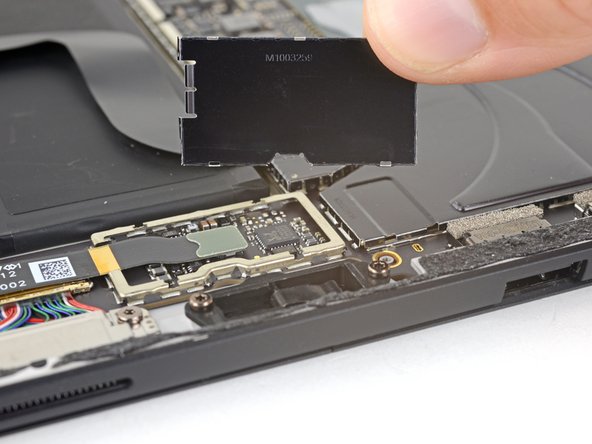

  23. Microsoft Surface Pro 6 MicroSD Card Reader Replacement, Remove the heat sink shield: crwdns2935265:023crwdnd2935265:01crwdnd2935265:02crwdne2935265:0 Microsoft Surface Pro 6 MicroSD Card Reader Replacement, Remove the heat sink shield: crwdns2935265:023crwdnd2935265:02crwdnd2935265:02crwdne2935265:0
    • Insert one point of a pair of pointed tweezers into a gap in the corner of the EMI shield covering the heat sink.
    • Use the tweezers to pry the EMI shield away from the motherboard as much as you can without bending it. Do not remove it yet.
    • Try not to deform the shield too much—you will need to reinstall it during reassembly.
    • Take care not to puncture the battery with the tweezers while working on this shield.
  24. Microsoft Surface Pro 6 MicroSD Card Reader Replacement: crwdns2935265:024crwdnd2935265:01crwdnd2935265:03crwdne2935265:0 Microsoft Surface Pro 6 MicroSD Card Reader Replacement: crwdns2935265:024crwdnd2935265:02crwdnd2935265:03crwdne2935265:0 Microsoft Surface Pro 6 MicroSD Card Reader Replacement: crwdns2935265:024crwdnd2935265:03crwdnd2935265:03crwdne2935265:0
    • Repeat the last step for each corner of the EMI shield covering the heat sink.
  25. Microsoft Surface Pro 6 MicroSD Card Reader Replacement: crwdns2935265:025crwdnd2935265:01crwdnd2935265:01crwdne2935265:0
    • Remove the heat sink shield.

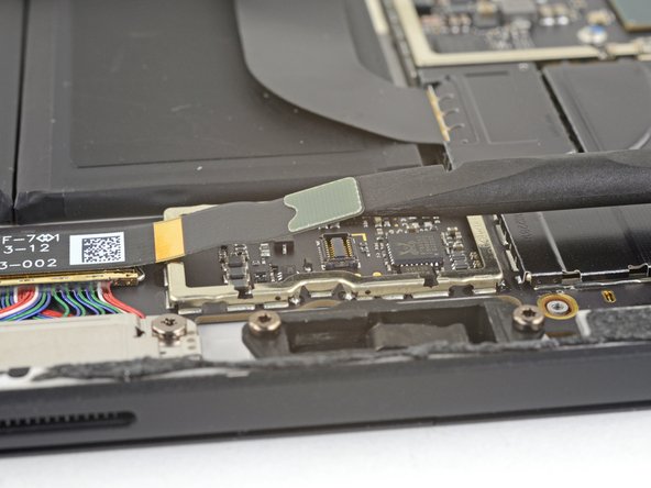

  28. Microsoft Surface Pro 6 MicroSD Card Reader Replacement, Disconnect the microSD card reader: crwdns2935265:028crwdnd2935265:01crwdnd2935265:03crwdne2935265:0 Microsoft Surface Pro 6 MicroSD Card Reader Replacement, Disconnect the microSD card reader: crwdns2935265:028crwdnd2935265:02crwdnd2935265:03crwdne2935265:0 Microsoft Surface Pro 6 MicroSD Card Reader Replacement, Disconnect the microSD card reader: crwdns2935265:028crwdnd2935265:03crwdnd2935265:03crwdne2935265:0
    • Insert one point of a pair of pointed tweezers into a gap in the corner of the EMI shield covering the microSD card reader connector.
    • Repeat this procedure at different points around the shield until it is free. Remove the shield.
  29. Microsoft Surface Pro 6 MicroSD Card Reader Replacement: crwdns2935265:029crwdnd2935265:01crwdnd2935265:02crwdne2935265:0 Microsoft Surface Pro 6 MicroSD Card Reader Replacement: crwdns2935265:029crwdnd2935265:02crwdnd2935265:02crwdne2935265:0
    • Use the flat end of a spudger to pry the microSD card reader connector up and out of its socket on the motherboard.
  30. Microsoft Surface Pro 6 MicroSD Card Reader Replacement, Remove the microSD card reader: crwdns2935265:030crwdnd2935265:01crwdnd2935265:01crwdne2935265:0
    • Use a T5 Torx driver to remove the two 3.1 mm screws securing the microSD card reader.
  31. Microsoft Surface Pro 6 MicroSD Card Reader Replacement: crwdns2935265:031crwdnd2935265:01crwdnd2935265:01crwdne2935265:0
    • Remove the microSD card reader.
