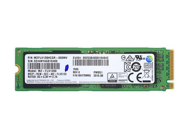

  8. Microsoft Surface Pro 4 Teardown: crwdns2935265:08crwdnd2935265:01crwdnd2935265:03crwdne2935265:0 Microsoft Surface Pro 4 Teardown: crwdns2935265:08crwdnd2935265:02crwdnd2935265:03crwdne2935265:0 Microsoft Surface Pro 4 Teardown: crwdns2935265:08crwdnd2935265:03crwdnd2935265:03crwdne2935265:0
    • Oh Surface, look how you've grown!
    • The Surface 4's Samsung branded SSD is considerably larger than the little whipper snapper we saw in the previous generation.
    • Awww, they brought us more chips. The 128 GB Samsung PM951 SSD is packing the following:
    • Samsung S4LN058A01-8030 PCIe 3.0 x4 NVMe flash controller
    • Samsung K9CHGY8S5C-CCK0 64 GB NAND flash
    • Samsung K4E4E324EE-SGCF 4 Gb (512 MB) DRAM
    • Texas Instruments TPS22966 5.5V, 6A, 16mΩ, 2-channel load switch
    • Silergy power management (likely)

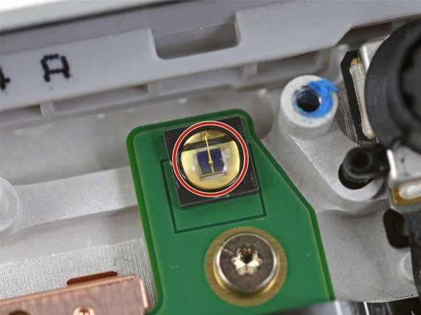

  10. Microsoft Surface Pro 4 Teardown: crwdns2935265:010crwdnd2935265:01crwdnd2935265:03crwdne2935265:0 Microsoft Surface Pro 4 Teardown: crwdns2935265:010crwdnd2935265:02crwdnd2935265:03crwdne2935265:0 Microsoft Surface Pro 4 Teardown: crwdns2935265:010crwdnd2935265:03crwdnd2935265:03crwdne2935265:0
    • Fittingly, the Surface has a pro line-up of cameras and sensors:
    • Infrared emitter
    • Infrared camera
    • Front-facing camera
    • "Privacy light" indicator LED (mounted on the rear-facing camera)
    • Microphone
    • Ambient light sensor
    • We're pretty sure the lil' guy marked in red is an IR emitter, like the one found in Project Tango. It should work with the IR camera to recognize your face and unlock your computer. Aw, he knows his mummy.

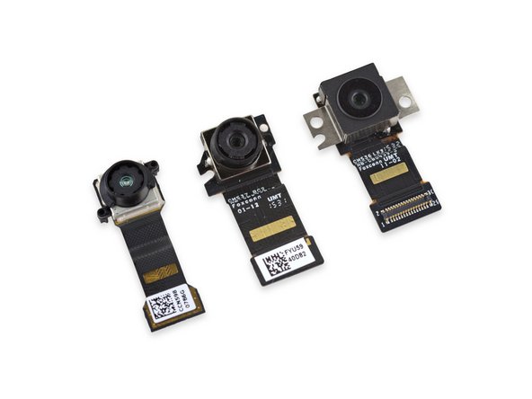

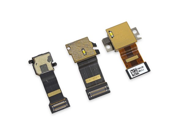

  11. Microsoft Surface Pro 4 Teardown: crwdns2935265:011crwdnd2935265:01crwdnd2935265:03crwdne2935265:0 Microsoft Surface Pro 4 Teardown: crwdns2935265:011crwdnd2935265:02crwdnd2935265:03crwdne2935265:0 Microsoft Surface Pro 4 Teardown: crwdns2935265:011crwdnd2935265:03crwdnd2935265:03crwdne2935265:0
    • Amidst this sea of tech, the tablet's three cameras all float to the surface.
    • From left to right:
    • Infrared face-detection camera supporting Windows Hello
    • Front-facing 5 MP camera
    • Rear-facing 8 MP main camera

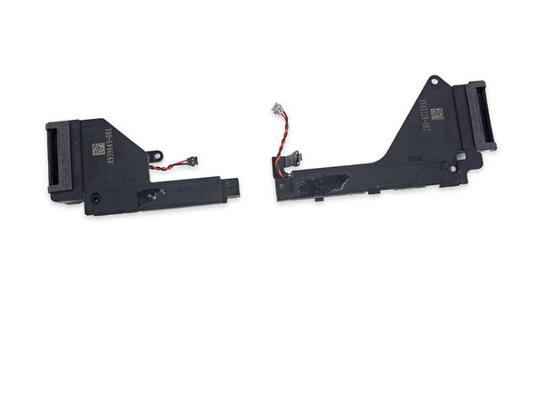

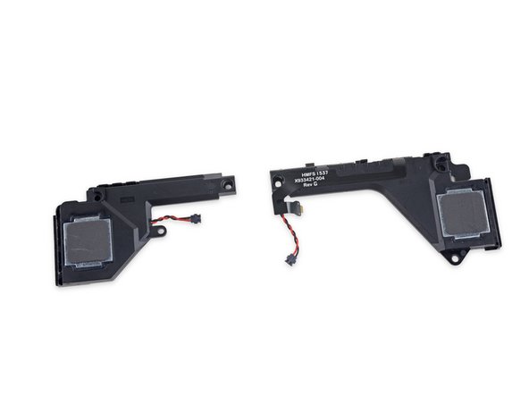

  12. Microsoft Surface Pro 4 Teardown: crwdns2935265:012crwdnd2935265:01crwdnd2935265:03crwdne2935265:0 Microsoft Surface Pro 4 Teardown: crwdns2935265:012crwdnd2935265:02crwdnd2935265:03crwdne2935265:0 Microsoft Surface Pro 4 Teardown: crwdns2935265:012crwdnd2935265:03crwdnd2935265:03crwdne2935265:0
    • We tweeze out the two stereo speakers from the corners of the case and make an interesting discovery...
    • It looks like the volume and power buttons are integrated directly into one of the speakers.
    • The Good: These integrated buttons are much less fidgity to replace as one piece than each button individually.
    • The Bad: The entire speaker will have to be replaced to replace one of the buttons, increasing the cost of repair.
