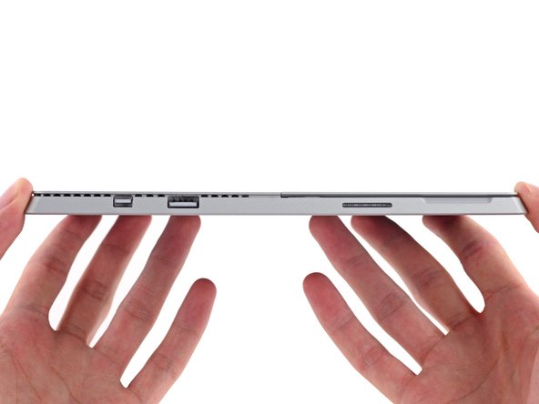

  3. Microsoft Surface Pro 3 Teardown: crwdns2935265:04crwdnd2935265:01crwdnd2935265:03crwdne2935265:0 Microsoft Surface Pro 3 Teardown: crwdns2935265:04crwdnd2935265:02crwdnd2935265:03crwdne2935265:0 Microsoft Surface Pro 3 Teardown: crwdns2935265:04crwdnd2935265:03crwdnd2935265:03crwdne2935265:0
    • True to its name, this threequel brings its hardware in triplicate:
    • Arrayed across the back, we find the rear-facing camera, accompanied by two additional specks—a status LED and a microphone.
    • And along the edge, another trio, this one for connectivity: a full-size USB 3.0 port, Mini DisplayPort, and the charging port.
    • Hiding beneath the kickstand is the microSD card slot, good for up to 128 GB of additional storage.

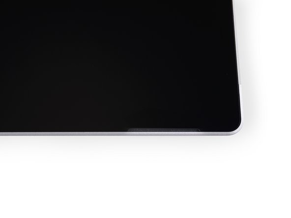

  4. Microsoft Surface Pro 3 Teardown: crwdns2935265:05crwdnd2935265:01crwdnd2935265:03crwdne2935265:0 Microsoft Surface Pro 3 Teardown: crwdns2935265:05crwdnd2935265:02crwdnd2935265:03crwdne2935265:0 Microsoft Surface Pro 3 Teardown: crwdns2935265:05crwdnd2935265:03crwdnd2935265:03crwdne2935265:0
    iOpener
    $24.99

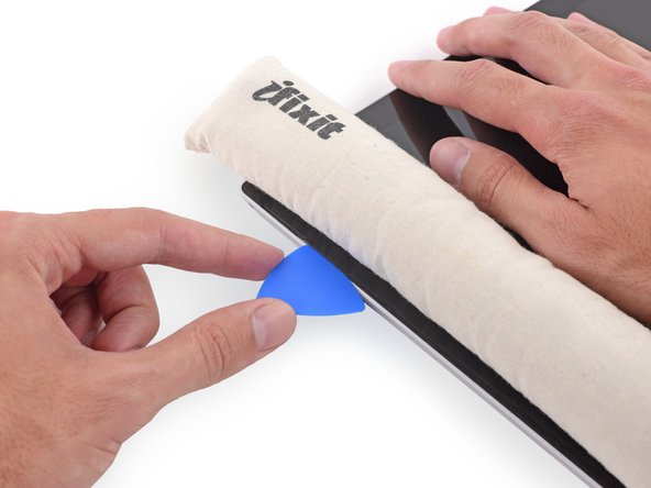

    • A cursory look is all it takes to tell us we're gonna need to bring the heat for a display-first invasion. Out comes the trusty iOpener.
    • If the old Surface Pro 2 is anything to go by, we're gonna need picks—oodles and oodles of picks.

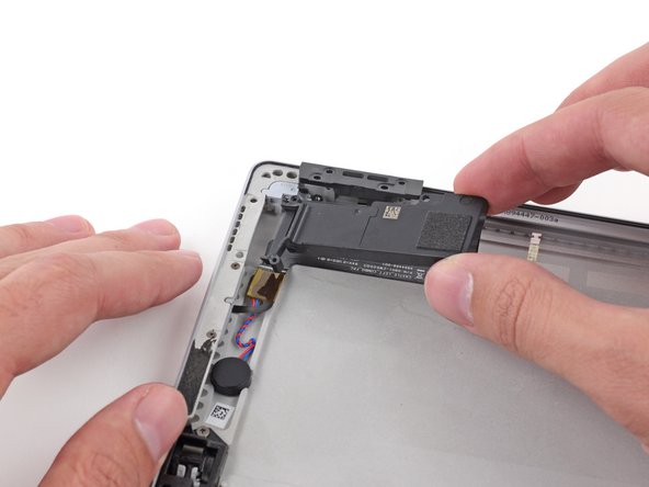

    • These speaker cutouts give us a handy point of access.
    • Picks, away!

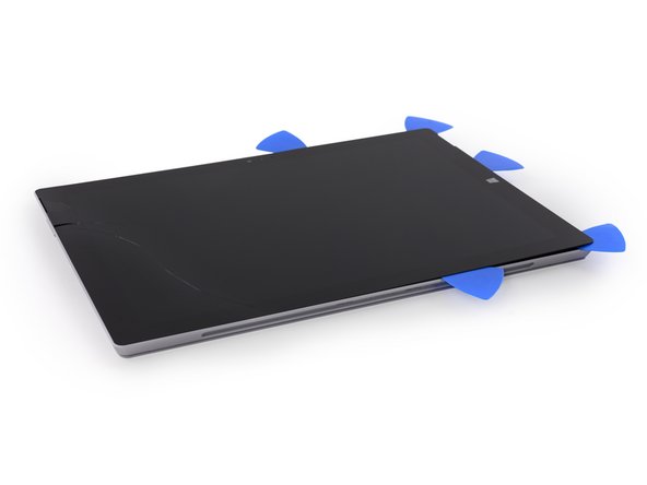

  5. Microsoft Surface Pro 3 Teardown: crwdns2935265:06crwdnd2935265:01crwdnd2935265:02crwdne2935265:0 Microsoft Surface Pro 3 Teardown: crwdns2935265:06crwdnd2935265:02crwdnd2935265:02crwdne2935265:0
    • Whoops.
    • Unfortunately, the Pro 3's weak point is just that—a point of weakness.
    • Our teardown engineer carefully heated and pried up the glass at the edge of this device, but the cooling adhesive alone was enough to crack the glass on our photo table.
    • Microsoft went to great lengths to make the Surface Pro 3 super portable, thinning it down from the Pro 2's 0.53" to a mere 0.36" thick—but it seems the thinner glass does not bode well for ruggedness, or repair.
    • We'll just work down here as that crack spreads quicker than an army across Westeros...

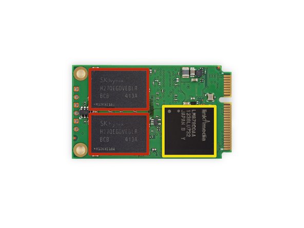

    • Next, we Ring Pop this surficial SSD up off the back case for a closer look.
    • You may be asking yourself, why a Ring Pop? As you well know, except for most natural blue diamonds, which are semiconductors due to substitutional boron impurities replacing carbon atoms, diamonds are a great electrical insulator, having a resistivity of 10^11 to 10^18 Ω·m. So really, we're just being careful.

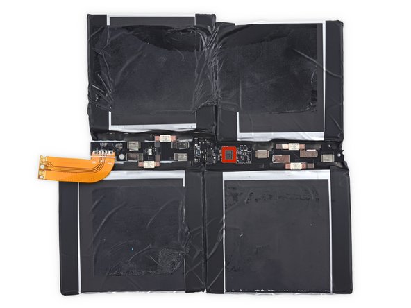

  12. Microsoft Surface Pro 3 Teardown: crwdns2935265:013crwdnd2935265:01crwdnd2935265:02crwdne2935265:0 Microsoft Surface Pro 3 Teardown: crwdns2935265:013crwdnd2935265:02crwdnd2935265:02crwdne2935265:0
    • We begin excavating, and find that this Surface keeps a few secrets in between its battery cells.
    • This hidden battery board contains a Maxim Integrated MAX17817 battery management IC.

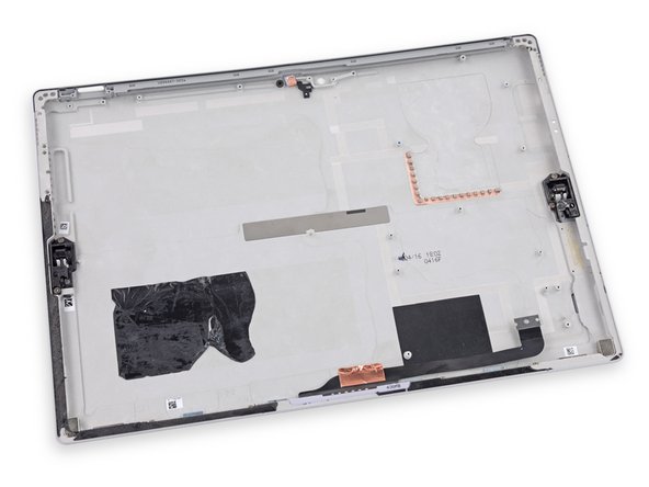

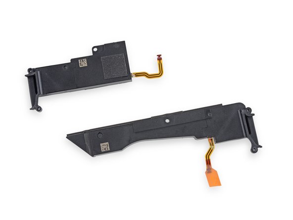

    • The everything cable—home to the headphone jack, volume and power buttons, and vibrator.
    • While the myriad of reviews focused on the identity crisis of this laplet and whether or not it could replace your tablet and laptop, Gabe over at Penny Arcade found some of the issues with the hardware. It would seem that if you are drawing with the included Premium pen, you bump into problems with the home button, literally. Perhaps there's a software fix in the offing?

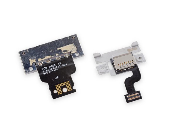

  22. Microsoft Surface Pro 3 Teardown: crwdns2935265:023crwdnd2935265:01crwdnd2935265:03crwdne2935265:0 Microsoft Surface Pro 3 Teardown: crwdns2935265:023crwdnd2935265:02crwdnd2935265:03crwdne2935265:0 Microsoft Surface Pro 3 Teardown: crwdns2935265:023crwdnd2935265:03crwdnd2935265:03crwdne2935265:0
    • We're charging (port) through the remains of the back case. We quickly free the microSD and charging port for closer inspection.
    • We're happy to see that Microsoft still provides a microSD slot. While it is not exactly all we hope and dream for in terms of expandable storage, it is a welcome inclusion.

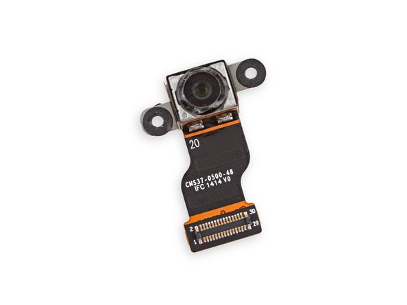

    • Next, we come upon a baby rear-facing camera in its natural habitat. This small creature watches its prey, waiting to strike at any moment.
    • Both cameras on this Surface safari are 5.0 MP, a lackluster spec in the current world of mobile device photography. However, we are just fine with that, as we aren't fond of tablet selfies.
    • As the sun sets on another teardown, we're left alone with our thoughts... and the rear case.
