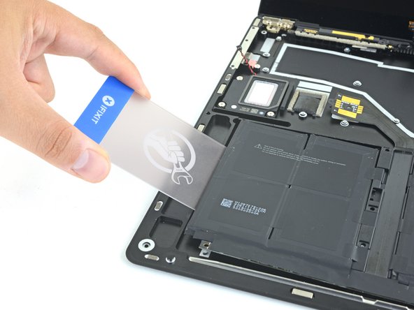

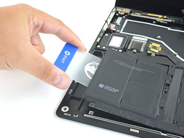

  46. Microsoft Surface Laptop 3 13.5" Battery Replacement: crwdns2935265:046crwdnd2935265:01crwdnd2935265:03crwdne2935265:0 Microsoft Surface Laptop 3 13.5" Battery Replacement: crwdns2935265:046crwdnd2935265:02crwdnd2935265:03crwdne2935265:0 Microsoft Surface Laptop 3 13.5" Battery Replacement: crwdns2935265:046crwdnd2935265:03crwdnd2935265:03crwdne2935265:0
    Plastic Cards
    $2.99
    • Take care not to puncture or bend the battery with your tools—a punctured or bent battery may leak dangerous chemicals or cause a thermal event.
    • Slide a plastic card underneath the far left battery cell group to slice through the adhesive holding it to the case.
    • If you encounter significant resistance at any point during this procedure, pause and apply more adhesive remover. Wait for it to soak into the adhesive, and try again.
    • Wiggle the card from side to side as you insert it under the battery cells to fully separate all adhesive holding them in place.
    • Leave the plastic card temporarily underneath the cell to prevent it from re-adhering while you continue.

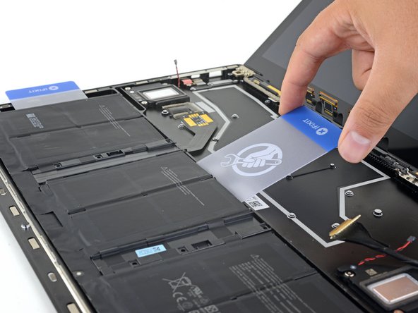

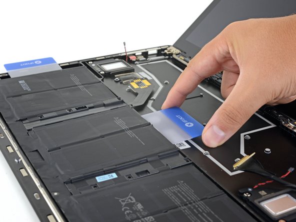

  47. Microsoft Surface Laptop 3 13.5" Battery Replacement: crwdns2935265:047crwdnd2935265:01crwdnd2935265:03crwdne2935265:0 Microsoft Surface Laptop 3 13.5" Battery Replacement: crwdns2935265:047crwdnd2935265:02crwdnd2935265:03crwdne2935265:0 Microsoft Surface Laptop 3 13.5" Battery Replacement: crwdns2935265:047crwdnd2935265:03crwdnd2935265:03crwdne2935265:0
    • Slide a second plastic card underneath the middle battery cell group to slice through the adhesive holding it to the case.

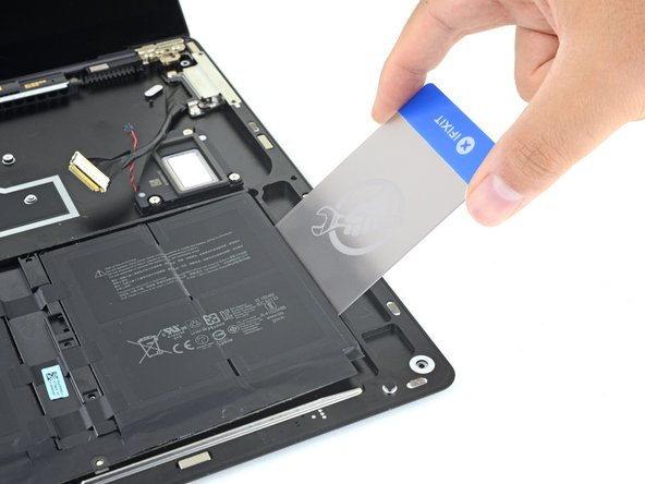

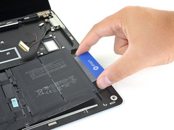

  48. Microsoft Surface Laptop 3 13.5" Battery Replacement: crwdns2935265:048crwdnd2935265:01crwdnd2935265:03crwdne2935265:0 Microsoft Surface Laptop 3 13.5" Battery Replacement: crwdns2935265:048crwdnd2935265:02crwdnd2935265:03crwdne2935265:0 Microsoft Surface Laptop 3 13.5" Battery Replacement: crwdns2935265:048crwdnd2935265:03crwdnd2935265:03crwdne2935265:0
    • Slide the card out from under the middle cell group.
    • Leave the card that's underneath the left group in place for now.
    • Slide the plastic card underneath the far right battery cell group to slice through the adhesive holding it to the case.
    • Leave the plastic card temporarily underneath the right cell group to prevent it from re-adhering while you continue.
