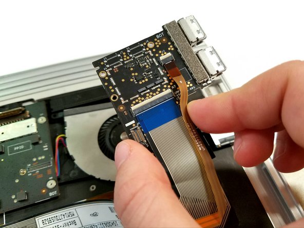

    1. Microsoft Surface Book Keyboard USB Port Replacement, USB Port: crwdns2935265:011crwdnd2935265:01crwdnd2935265:01crwdne2935265:0
      • Orient your keyboard with the internals facing up and the USB Port on the right.
    2. Microsoft Surface Book Keyboard USB Port Replacement: crwdns2935265:012crwdnd2935265:01crwdnd2935265:01crwdne2935265:0
      • Use a plastic opening tool and remove the tab from the USB board

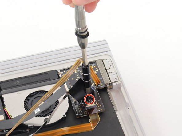

    3. Microsoft Surface Book Keyboard USB Port Replacement: crwdns2935265:013crwdnd2935265:01crwdnd2935265:02crwdne2935265:0 Microsoft Surface Book Keyboard USB Port Replacement: crwdns2935265:013crwdnd2935265:02crwdnd2935265:02crwdne2935265:0
      • Lift up the black and gold wires and find the screw hidden there.
      • Use the T3 Torx Screwdriver and remove the four mm screw.
    4. Microsoft Surface Book Keyboard USB Port Replacement: crwdns2935265:014crwdnd2935265:01crwdnd2935265:01crwdne2935265:0
      • Use the T3 Torx Screwdriver to remove the remaining three 4 mm screws.
    5. Microsoft Surface Book Keyboard USB Port Replacement: crwdns2935265:015crwdnd2935265:01crwdnd2935265:02crwdne2935265:0 Microsoft Surface Book Keyboard USB Port Replacement: crwdns2935265:015crwdnd2935265:02crwdnd2935265:02crwdne2935265:0
      • Wiggle the USB Port board away from the keyboard.
      • This may require some force.
