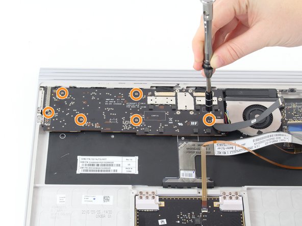

      • Use the T3 screwdriver to remove three 4 mm screws located on the black bar towards the bottom of the board.
      • Use the T3 Torx Screwdriver to remove the remaining six 4 mm screws.

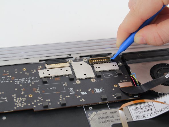

    3. Microsoft Surface Book Keyboard Fan Replacement: crwdns2935265:016crwdnd2935265:01crwdnd2935265:03crwdne2935265:0 Microsoft Surface Book Keyboard Fan Replacement: crwdns2935265:016crwdnd2935265:02crwdnd2935265:03crwdne2935265:0 Microsoft Surface Book Keyboard Fan Replacement: crwdns2935265:016crwdnd2935265:03crwdnd2935265:03crwdne2935265:0
      • Lift both clamps with the blue plastic opening tool. Place the tool underneath the clamps and pry them open.
      • Use the plastic opening tool to slide ribbon cable toward the wall of the keyboard until the ribbon cables come loose.

      • Wiggle the the GPU board out away from the keyboard.
      • This may require some force to remove.
