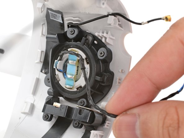

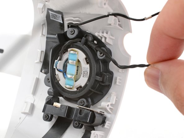

    • Insert one arm of a pair of tweezers under the metal neck of the side antenna cable.
    • Lift the antenna connector straight up to disconnect it.

  56. Meta Quest 2 USB‑C Port and Headphone Jack Replacement, Unclip the left speaker cable: crwdns2935265:056crwdnd2935265:01crwdnd2935265:03crwdne2935265:0 Meta Quest 2 USB‑C Port and Headphone Jack Replacement, Unclip the left speaker cable: crwdns2935265:056crwdnd2935265:02crwdnd2935265:03crwdne2935265:0 Meta Quest 2 USB‑C Port and Headphone Jack Replacement, Unclip the left speaker cable: crwdns2935265:056crwdnd2935265:03crwdnd2935265:03crwdne2935265:0
    • Use tweezers or your fingers to guide the left speaker cable out of its two plastic clips.
    • During reassembly:
    • Clip this cable neatly into the guide clips to prevent it from getting pinched by the screen and lens assembly.
    • The first guide clip should clip behind the rubber stop on the speaker cable. This anchors the cable while giving it enough slack for the speaker arm to swivel.

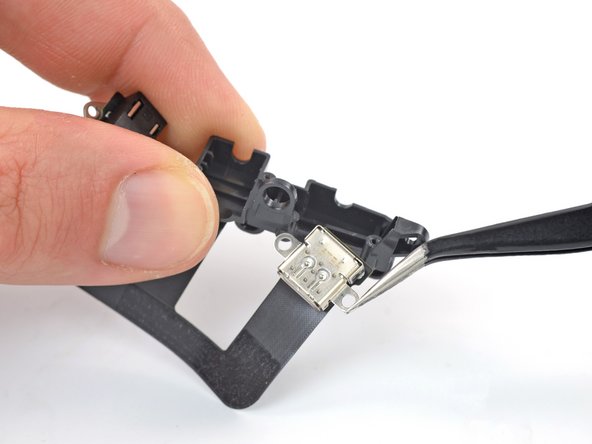

  63. Meta Quest 2 USB‑C Port and Headphone Jack Replacement: crwdns2935265:063crwdnd2935265:01crwdnd2935265:02crwdne2935265:0 Meta Quest 2 USB‑C Port and Headphone Jack Replacement: crwdns2935265:063crwdnd2935265:02crwdnd2935265:02crwdne2935265:0
    • Use tweezers or your fingers to lift the USB-C port out of its recess.
  64. Meta Quest 2 USB‑C Port and Headphone Jack Replacement: crwdns2935265:064crwdnd2935265:01crwdnd2935265:02crwdne2935265:0 Meta Quest 2 USB‑C Port and Headphone Jack Replacement: crwdns2935265:064crwdnd2935265:02crwdnd2935265:02crwdne2935265:0
    • Remove the USB-C port and headphone jack from its bracket.
