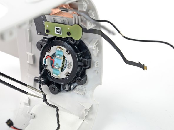

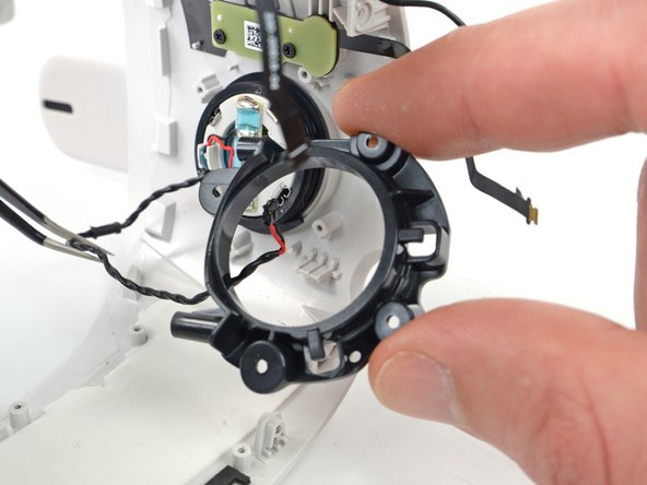

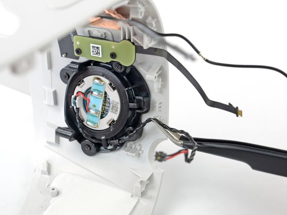

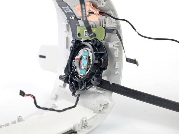

  39. Meta Quest 2 Speaker Assembly Replacement, Disconnect the speaker connectors: crwdns2935265:039crwdnd2935265:01crwdnd2935265:03crwdne2935265:0 Meta Quest 2 Speaker Assembly Replacement, Disconnect the speaker connectors: crwdns2935265:039crwdnd2935265:02crwdnd2935265:03crwdne2935265:0 Meta Quest 2 Speaker Assembly Replacement, Disconnect the speaker connectors: crwdns2935265:039crwdnd2935265:03crwdnd2935265:03crwdne2935265:0
    • Use tweezers to grip the left speaker cables at the base of their motherboard connector.
    • Lift the connector gently straight up to disconnect it.
    • During reassembly, use the flat end of a spudger to press the speaker cable into the rubber holding clip.
  40. Meta Quest 2 Speaker Assembly Replacement: crwdns2935265:040crwdnd2935265:01crwdnd2935265:03crwdne2935265:0 Meta Quest 2 Speaker Assembly Replacement: crwdns2935265:040crwdnd2935265:02crwdnd2935265:03crwdne2935265:0 Meta Quest 2 Speaker Assembly Replacement: crwdns2935265:040crwdnd2935265:03crwdnd2935265:03crwdne2935265:0
    • Repeat the disconnection procedure for the right speaker connector.

  60. Meta Quest 2 Speaker Assembly Replacement, Unclip the speaker cable: crwdns2935265:060crwdnd2935265:01crwdnd2935265:03crwdne2935265:0 Meta Quest 2 Speaker Assembly Replacement, Unclip the speaker cable: crwdns2935265:060crwdnd2935265:02crwdnd2935265:03crwdne2935265:0 Meta Quest 2 Speaker Assembly Replacement, Unclip the speaker cable: crwdns2935265:060crwdnd2935265:03crwdnd2935265:03crwdne2935265:0
    • Use tweezers or your fingers to guide the speaker cable out of its two plastic clips.
    • During reassembly:
    • Clip this cable neatly into the guide clips to prevent it from getting pinched by the screen and lens assembly.
    • The first guide clip should clip behind the rubber stop on the speaker cable. This anchors the cable while giving it enough slack for the speaker arm to swivel.

  63. Meta Quest 2 Speaker Assembly Replacement: crwdns2935265:063crwdnd2935265:01crwdnd2935265:03crwdne2935265:0 Meta Quest 2 Speaker Assembly Replacement: crwdns2935265:063crwdnd2935265:02crwdnd2935265:03crwdne2935265:0 Meta Quest 2 Speaker Assembly Replacement: crwdns2935265:063crwdnd2935265:03crwdnd2935265:03crwdne2935265:0
    • Four metal clips secure the inner speaker bracket to the speaker assembly.
    • Insert one arm of a pair of tweezers under the lip of a metal clip.
    • Use tweezers to grasp the clip by the lip and pull out the clip from its recess.
    • These clips can be difficult to pull out because they have a small locking tab on the back. If you have trouble, you can wiggle the clip back and forth as you pull. To get a better grip, use needle nose pliers.
    • Repeat the process for the three remaining clips.
    • During reassembly, use the flat end of a spudger to fully press each clip into its recess.
  64. Meta Quest 2 Speaker Assembly Replacement: crwdns2935265:064crwdnd2935265:01crwdnd2935265:03crwdne2935265:0 Meta Quest 2 Speaker Assembly Replacement: crwdns2935265:064crwdnd2935265:02crwdnd2935265:03crwdne2935265:0 Meta Quest 2 Speaker Assembly Replacement: crwdns2935265:064crwdnd2935265:03crwdnd2935265:03crwdne2935265:0
    • Grasp the inner speaker bracket with your fingers and twist it counterclockwise to unlock it from the speaker assembly.
    • If you have trouble rotating the bracket, you can brace a spudger against the bracket while you twist the speaker arm.
    • During reassembly, twist the inner speaker bracket clockwise onto the speaker assembly until it won’t turn anymore. If it’s not fully twisted, you’ll have a difficult time reinstalling the four metal clips.
  65. Meta Quest 2 Speaker Assembly Replacement, Remove the speaker assembly: crwdns2935265:065crwdnd2935265:01crwdnd2935265:02crwdne2935265:0 Meta Quest 2 Speaker Assembly Replacement, Remove the speaker assembly: crwdns2935265:065crwdnd2935265:02crwdnd2935265:02crwdne2935265:0
    • Thread the speaker assembly wire through the inner speaker bracket.
    • Remove the speaker assembly.
