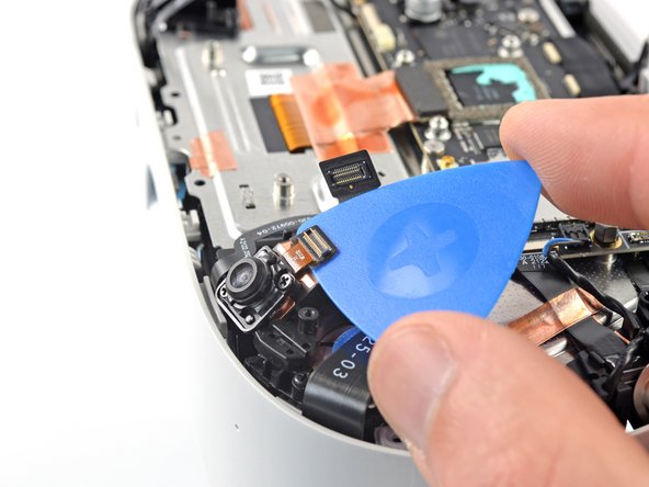

  32. Meta Quest 2 Lower Cameras Replacement, Disconnect the lower camera: crwdns2935265:032crwdnd2935265:01crwdnd2935265:02crwdne2935265:0 Meta Quest 2 Lower Cameras Replacement, Disconnect the lower camera: crwdns2935265:032crwdnd2935265:02crwdnd2935265:02crwdne2935265:0
    • Use a spudger to pry up and disconnect the lower camera connector.
  33. Meta Quest 2 Lower Cameras Replacement, Loosen the lower camera: crwdns2935265:033crwdnd2935265:01crwdnd2935265:02crwdne2935265:0 Meta Quest 2 Lower Cameras Replacement, Loosen the lower camera: crwdns2935265:033crwdnd2935265:02crwdnd2935265:02crwdne2935265:0
    • Slide an opening pick under the camera cable to loosen it from the headset.
  34. Meta Quest 2 Lower Cameras Replacement: crwdns2935265:034crwdnd2935265:01crwdnd2935265:01crwdne2935265:0

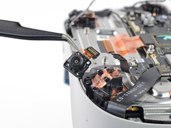

    • Use a Phillips screwdriver to remove the two 3.5 mm‑long screws securing the camera.
  35. Meta Quest 2 Lower Cameras Replacement, Remove the camera: crwdns2935265:035crwdnd2935265:01crwdnd2935265:02crwdne2935265:0 Meta Quest 2 Lower Cameras Replacement, Remove the camera: crwdns2935265:035crwdnd2935265:02crwdnd2935265:02crwdne2935265:0
    iFixit Thermal Putty
    $9.95
    • Lift and remove the lower camera.
    • You can reuse the thermal paste if you keep it clean. Otherwise, use a spudger to scrape off the old paste and apply a small amount of thermal putty or viscous thermal compound (such as K5 Pro) to the back of the camera.
