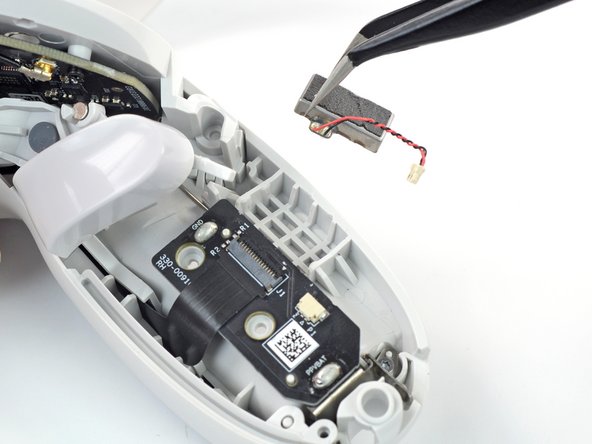

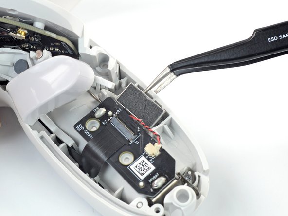

  18. Meta Quest 2 Controller Vibration Motor Replacement, Disconnect the vibration motor: crwdns2935265:018crwdnd2935265:01crwdnd2935265:02crwdne2935265:0 Meta Quest 2 Controller Vibration Motor Replacement, Disconnect the vibration motor: crwdns2935265:018crwdnd2935265:02crwdnd2935265:02crwdne2935265:0
    • Use tweezers or your fingernail to pull the vibration motor connector out of its socket.
  19. Meta Quest 2 Controller Vibration Motor Replacement, Remove the vibration motor: crwdns2935265:019crwdnd2935265:01crwdnd2935265:03crwdne2935265:0 Meta Quest 2 Controller Vibration Motor Replacement, Remove the vibration motor: crwdns2935265:019crwdnd2935265:02crwdnd2935265:03crwdne2935265:0 Meta Quest 2 Controller Vibration Motor Replacement, Remove the vibration motor: crwdns2935265:019crwdnd2935265:03crwdnd2935265:03crwdne2935265:0
    Tesa 61395 Tape
    $2.99
    • Insert one arm of a pair of tweezers between the vibration motor and the controller.
    • Pry to loosen the vibration motor.
    • Remove the vibration motor.
    • The vibration motor is held in place mostly by a friction fit. If your motor feels loose when you replace it, secure it in place with some double-sided tape.
