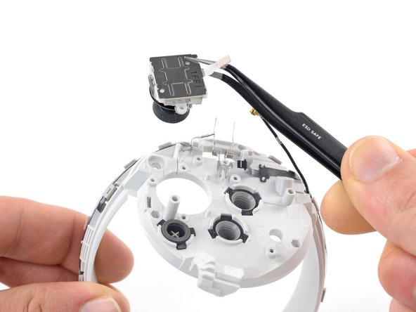

    1. Meta Quest 2 Controller Joystick Replacement, Remove the joystick: crwdns2935265:034crwdnd2935265:01crwdnd2935265:02crwdne2935265:0 Meta Quest 2 Controller Joystick Replacement, Remove the joystick: crwdns2935265:034crwdnd2935265:02crwdnd2935265:02crwdne2935265:0
      • Use your fingers or tweezers to remove the joystick.

When replacing the joystick, make sure you place the metal cover on the right side, the joystick goes under the circuit board, and make sure the little metal flap is bent enough, also make sure the screws are tight.
id recommend this video so you get more what i mean, although it doesn't show exactly that i mean.
https://youtu.be/kQ2-XYEbOKY?t=98
otherwise you wont have the touch pad on the joystick, it'll still work good, just no sensing if you have your finger on it
