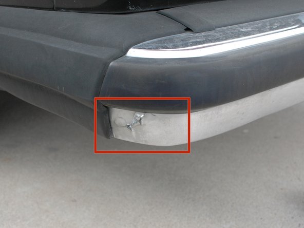

    • Check the bumpers to see that the rubber trim pieces are secured properly and not hanging off or otherwise loose.
    • Check the bumpers and the areas where the bumpers connect to the body of the car for rust or other damage.

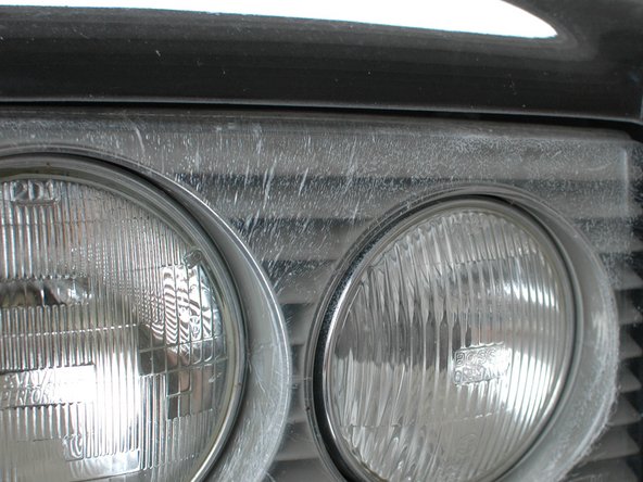

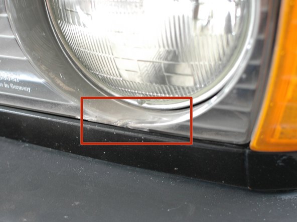

    • At the front of the car check the turn signals and head lights, aks the owner to operate them. Also check that the high-beams work and that the fog lights work.
    • It is typical for the old plastic turn signal lights and the plastic surrounds, also known as "doors", around the headlights to be covered in small cracks otherwise known as crazing.
    • The headlights on U.S. cars, however, are sealed beams in a glass housing. The fog lights are glass too. These should not be cracked. Small rock chips are typical.

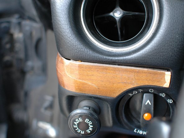

    • While sitting there take a look at all of the wood trim. Check for areas where it's coming loose, or where it's cracked, the finish is coming off, or it is missing entirely.
    • Note that loose trim can be easily re-glued in most cases, while cracked or missing trim can be expensive to replace.

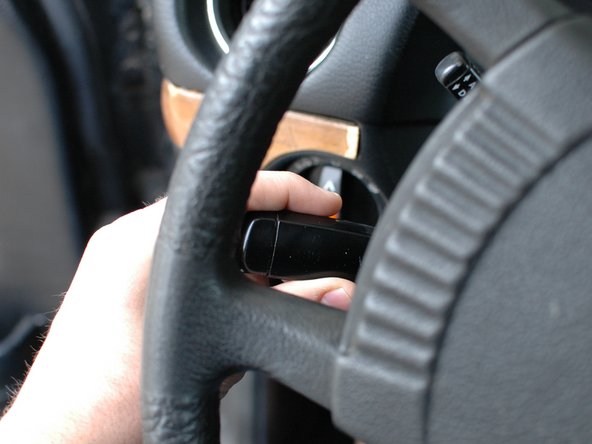

    • Move the combination switch up and down, for right and left turn signals respectively, and then push it away from you for high-beams. It should firmly move in to each position and stay there without any slop. Then pull it towards you for high-beam flash; it should spring back to the center position when you let it go.

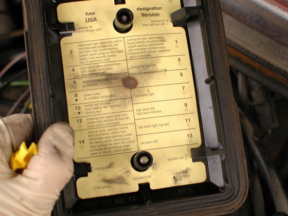

    • With the front door open the courtesy light should turn on. If it does not, try moving the small black switch on it through its various positions to see if the bulb is burnt out or if another issue may exist such as a bad door switch.

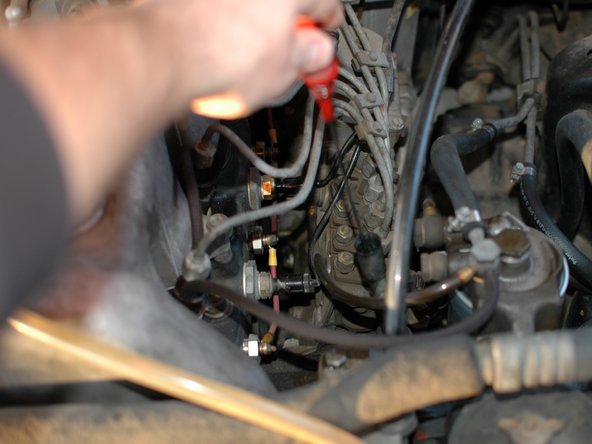

    • Inspect the injectors for fuel wetness. Leaks could be coming from:
    • the hard injector lines...
    • the body of the injectors...
    • or the soft injector return lines.
    • Inspect the return lines for brittleness, wetness, worn areas, etc.

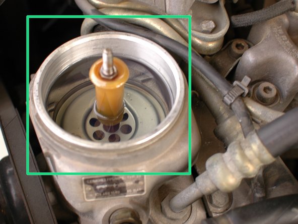

    • Check the oil filter housing for leaks at the lid seal, as well as at the oil cooler lines and the seal where it attaches to the engine block.

  43. Mercedes W123 Diesel Pre-Purchase Inspection: crwdns2935265:045crwdnd2935265:01crwdnd2935265:03crwdne2935265:0 Mercedes W123 Diesel Pre-Purchase Inspection: crwdns2935265:045crwdnd2935265:02crwdnd2935265:03crwdne2935265:0 Mercedes W123 Diesel Pre-Purchase Inspection: crwdns2935265:045crwdnd2935265:03crwdnd2935265:03crwdne2935265:0
    • Remove the fuse box cover and inspect the fuses for excess corrosion or obvious burnt fuses.
    • Check to see that the proper size of fuse is installed in each location, using the chart on the back of the cover.
    • Look out for any aluminium fuses; only copper fuses should be used on these cars.

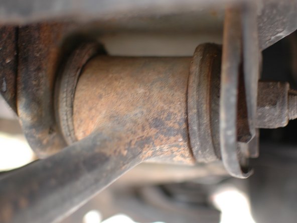

    • Check the various other rubber boots, bushings, etc. on the front steering and suspension for cracks, splits, dry-rotting, etc.

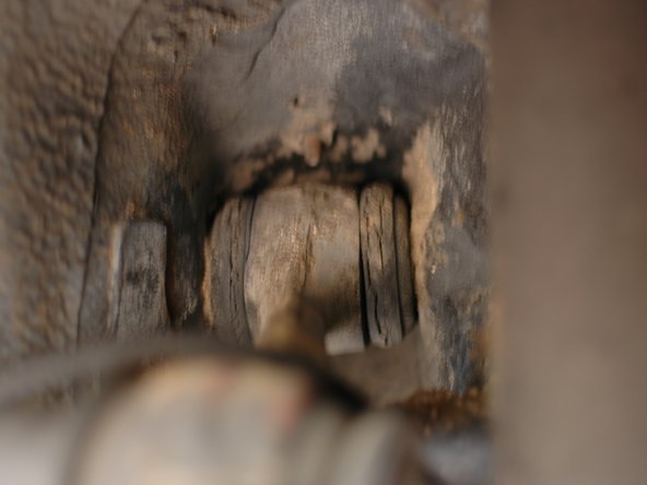

    • Check the transmission mount for deterioration. It is up inside the cross member just behind the front flex disc. You will have to crane your neck up to see it above the cross member.

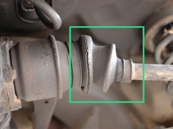

    • Check the inner and outer axle boots. Shown here is:
    • A good boot.
    • A bad boot, ready to split in the near future.
