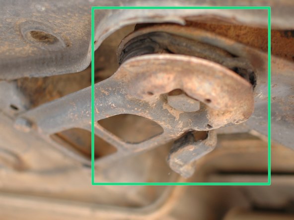

  4. Mercedes W123 Jack Technique: crwdns2935265:04crwdnd2935265:01crwdnd2935265:01crwdne2935265:0
    • Move to the back of the vehicle.
    • Place the jack under the rear differential of the car. This is the strongest lift point at the rear of the vehicle.
    • Place it directly under the center of the differential and begin lifting it slowly and carefully following similar precautions as the front of the car.
  5. Mercedes W123 Jack Technique: crwdns2935265:05crwdnd2935265:01crwdnd2935265:02crwdne2935265:0 Mercedes W123 Jack Technique: crwdns2935265:05crwdnd2935265:02crwdnd2935265:02crwdne2935265:0
    • Place the rear jack stands in a strong and secure location. At the rear of the car, there are several choices, and it will often depend on the type of work being done.
    • In most cases, a good choice is directly under the lower shock mounting point in the trailing arm.
    • Another option is underneath the sub-frame bushing mount points.
    • Lower the jack slowly and carefully on to the rear stands and check that they are well positioned.
    • Once the car is on the jack stands, firmly attempt to shake the vehicle back and forth, front and back, at each of the four corners of the car. Look to see that the jack stands are not rocking, bending, or otherwise moving. The vehicle should feel rather rock solid.
    • If the vehicle does not feel stable try and identify which stand is not securely placed and replace it by re-tracing the steps in this guide.
