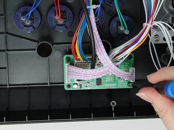

  2. Mayflash Arcade Stick F300 Printed Circuit Board Replacement, Printed Circuit Board: crwdns2935265:02crwdnd2935265:01crwdnd2935265:02crwdne2935265:0 Mayflash Arcade Stick F300 Printed Circuit Board Replacement, Printed Circuit Board: crwdns2935265:02crwdnd2935265:02crwdnd2935265:02crwdne2935265:0
    • Remove the four 10 mm truss head screws securing the PCB to the plastic outer casing using a Phillips #1 screwdriver.

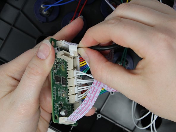

  3. Mayflash Arcade Stick F300 Printed Circuit Board Replacement: crwdns2935265:03crwdnd2935265:01crwdnd2935265:03crwdne2935265:0 Mayflash Arcade Stick F300 Printed Circuit Board Replacement: crwdns2935265:03crwdnd2935265:02crwdnd2935265:03crwdne2935265:0 Mayflash Arcade Stick F300 Printed Circuit Board Replacement: crwdns2935265:03crwdnd2935265:03crwdnd2935265:03crwdne2935265:0
    • Use a hair dryer or heat gun to soften the glue holding the USB cable into the socket on the PCB.
    • It should take less than a minute for the glue to be soft enough to remove. Do not overheat the circuit board.
    • Use a metal spudger to gently remove the softened glue.
    • Unplug the cable from the socket.

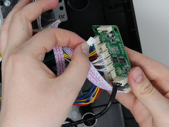

  4. Mayflash Arcade Stick F300 Printed Circuit Board Replacement: crwdns2935265:04crwdnd2935265:01crwdnd2935265:02crwdne2935265:0 Mayflash Arcade Stick F300 Printed Circuit Board Replacement: crwdns2935265:04crwdnd2935265:02crwdnd2935265:02crwdne2935265:0
    • Gently unplug the rest of the attached wires from the PCB.
    • Make sure to keep track of where each wire goes to assist with reassembly.

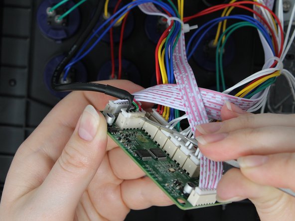

  5. Mayflash Arcade Stick F300 Printed Circuit Board Replacement: crwdns2935265:05crwdnd2935265:01crwdnd2935265:01crwdne2935265:0
    • Remove the printed circuit board.
