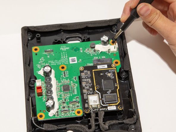

  4. Marshall Uxbridge LinkPlay Board Replacement, Motherboard: crwdns2935265:04crwdnd2935265:01crwdnd2935265:02crwdne2935265:0 Marshall Uxbridge LinkPlay Board Replacement, Motherboard: crwdns2935265:04crwdnd2935265:02crwdnd2935265:02crwdne2935265:0
    • Use a Phillips #1 screwdriver to remove the six 12 mm screws from the motherboard.
  5. Marshall Uxbridge LinkPlay Board Replacement: crwdns2935265:05crwdnd2935265:01crwdnd2935265:01crwdne2935265:0
    • Use a Phillips #000 screwdriver to remove the two 6 mm black screws holding the black board that says "LinkPlay" in place.
  6. Marshall Uxbridge LinkPlay Board Replacement: crwdns2935265:06crwdnd2935265:01crwdnd2935265:02crwdne2935265:0 Marshall Uxbridge LinkPlay Board Replacement: crwdns2935265:06crwdnd2935265:02crwdnd2935265:02crwdne2935265:0
    • Use a TR 6 Torx screwdriver to remove the two silver 6 mm screws from the LinkPlay board.

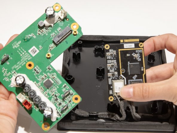

    • Lift the motherboard.
    • Slide the LinkPlay board down to remove the motherboard from the back panel.

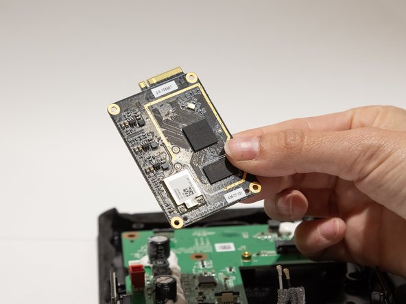

  8. Marshall Uxbridge LinkPlay Board Replacement, LinkPlay Board: crwdns2935265:08crwdnd2935265:01crwdnd2935265:02crwdne2935265:0 Marshall Uxbridge LinkPlay Board Replacement, LinkPlay Board: crwdns2935265:08crwdnd2935265:02crwdnd2935265:02crwdne2935265:0
    • Detach the two antennas that connect the LinkPlay to the speaker's back panel.
