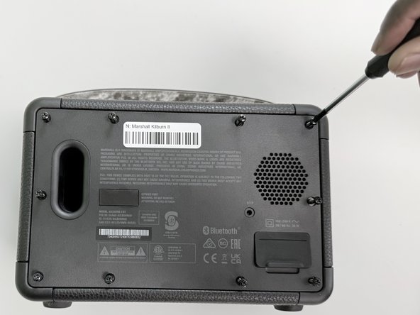

    • Flip the front of the Marshall Kilburn II on a flat surface so the back is facing you.
    • Use a Phillips #1 screwdriver to remove all ten 4 mm screws.

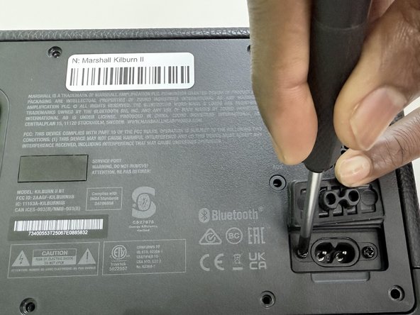

  2. Marshall Kilburn II Tweeters Replacement: crwdns2935265:02crwdnd2935265:01crwdnd2935265:02crwdne2935265:0 Marshall Kilburn II Tweeters Replacement: crwdns2935265:02crwdnd2935265:02crwdnd2935265:02crwdne2935265:0
    • Lift the charging port cover.
    • Use a Phillips #1 screwdriver to remove the two 4 mm screws.

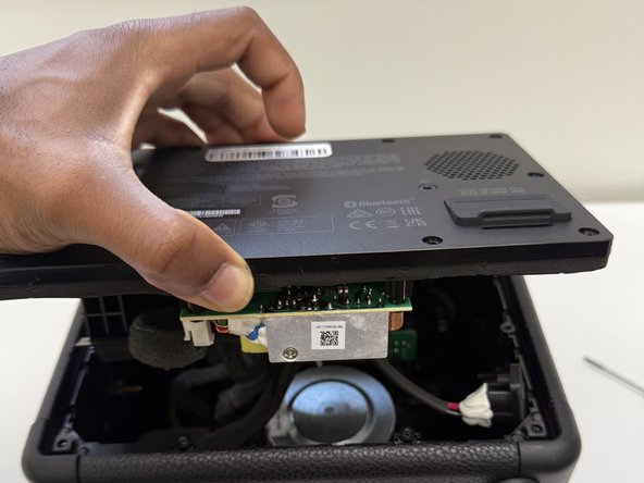

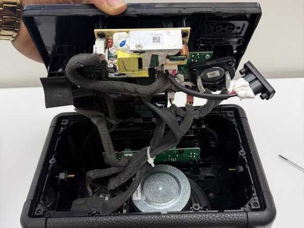

  3. Marshall Kilburn II Tweeters Replacement: crwdns2935265:03crwdnd2935265:01crwdnd2935265:03crwdne2935265:0 Marshall Kilburn II Tweeters Replacement: crwdns2935265:03crwdnd2935265:02crwdnd2935265:03crwdne2935265:0 Marshall Kilburn II Tweeters Replacement: crwdns2935265:03crwdnd2935265:03crwdnd2935265:03crwdne2935265:0
    • Slightly lift up the back cover of the speaker just enough to be able to see the inside compartment of the speaker.
    • Take care not to strain the attached cables.
    • You can use an opening tool to help pry up the back cover from the sides if the back cover doesn't lift up easily.
    • Lift the back cover just enough to be able to see the inside compartment of the speaker.

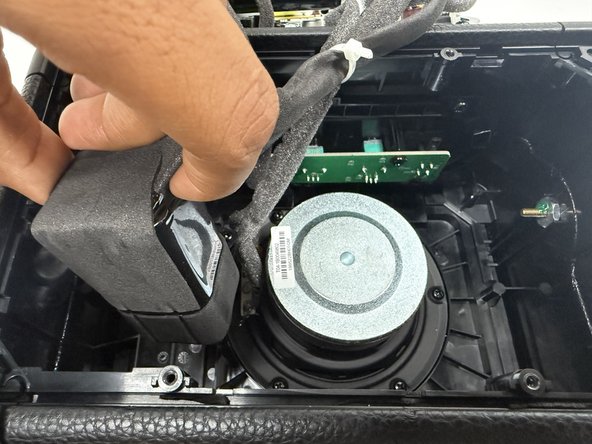

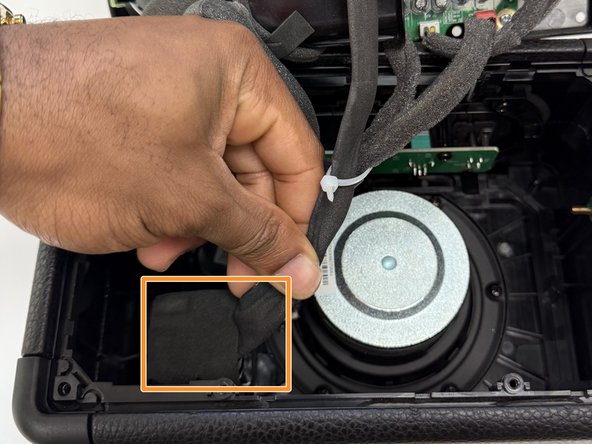

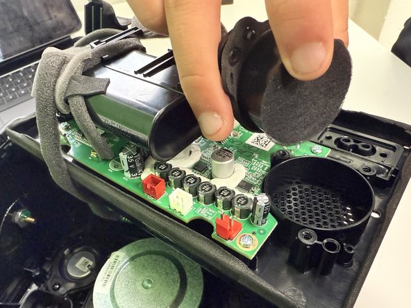

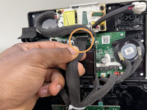

  4. Marshall Kilburn II Tweeters Replacement: crwdns2935265:04crwdnd2935265:01crwdnd2935265:03crwdne2935265:0 Marshall Kilburn II Tweeters Replacement: crwdns2935265:04crwdnd2935265:02crwdnd2935265:03crwdne2935265:0 Marshall Kilburn II Tweeters Replacement: crwdns2935265:04crwdnd2935265:03crwdnd2935265:03crwdne2935265:0
    • Locate the battery, which is attached on the inside bottom left corner. Refer to image 1.
    • Identify the black cable that connects from the battery to the back cover of the speaker.

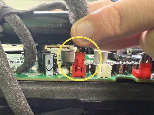

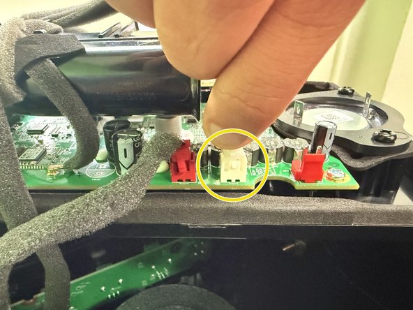

  5. Marshall Kilburn II Tweeters Replacement: crwdns2935265:05crwdnd2935265:01crwdnd2935265:02crwdne2935265:0 Marshall Kilburn II Tweeters Replacement: crwdns2935265:05crwdnd2935265:02crwdnd2935265:02crwdne2935265:0
    • Grip the white battery connector and pull it directly out of its socket.
    • Remove the battery by pulling the battery up out of its housing.
    • You will need to cut the white zip tie which holds the battery cable and the other cables together.

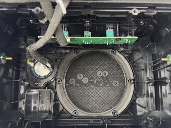

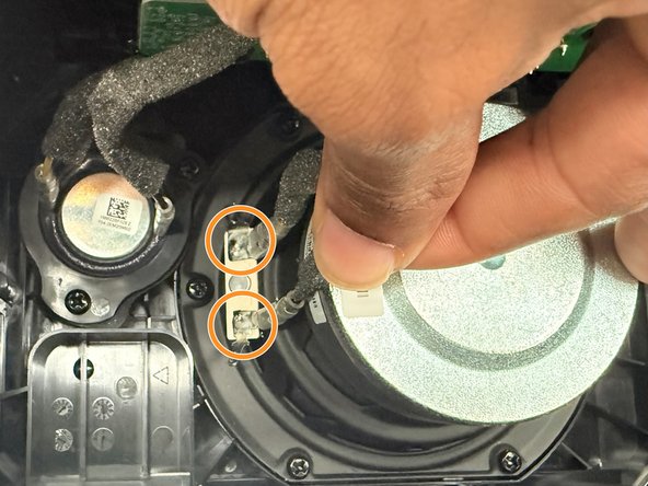

  6. Marshall Kilburn II Tweeters Replacement, Main Speaker: crwdns2935265:06crwdnd2935265:01crwdnd2935265:02crwdne2935265:0 Marshall Kilburn II Tweeters Replacement, Main Speaker: crwdns2935265:06crwdnd2935265:02crwdnd2935265:02crwdne2935265:0
    • Firmly press on the tab on the speake connector and pull up to disconnect it.
    • Disconnect the two speaker connectors.
    • Avoid using excessive force when pulling the wires to avoid damages.
  7. Marshall Kilburn II Tweeters Replacement: crwdns2935265:07crwdnd2935265:01crwdnd2935265:03crwdne2935265:0 Marshall Kilburn II Tweeters Replacement: crwdns2935265:07crwdnd2935265:02crwdnd2935265:03crwdne2935265:0 Marshall Kilburn II Tweeters Replacement: crwdns2935265:07crwdnd2935265:03crwdnd2935265:03crwdne2935265:0
    • Use a Phillips #1 screwdriver to remove all six 4 mm screws securing the main speaker.
    • Be mindful of the strong magnetic pull from the speaker.
    • Remove the main speaker.

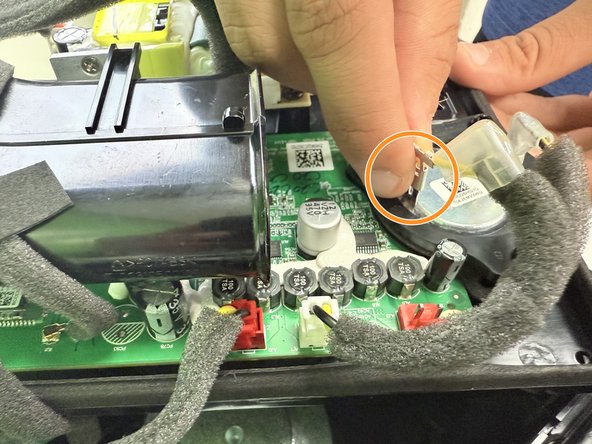

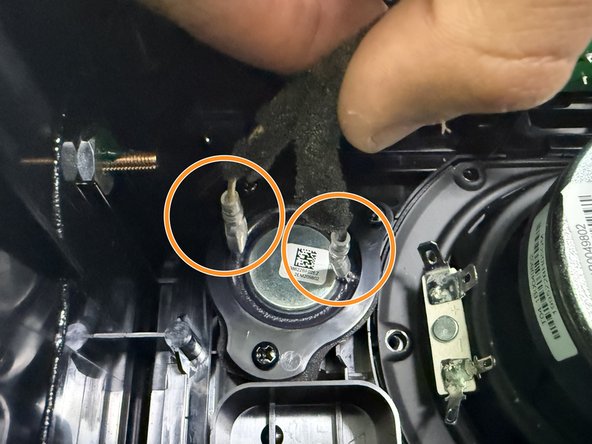

  8. Marshall Kilburn II Tweeters Replacement, Tweeters: crwdns2935265:08crwdnd2935265:01crwdnd2935265:03crwdne2935265:0 Marshall Kilburn II Tweeters Replacement, Tweeters: crwdns2935265:08crwdnd2935265:02crwdnd2935265:03crwdne2935265:0 Marshall Kilburn II Tweeters Replacement, Tweeters: crwdns2935265:08crwdnd2935265:03crwdnd2935265:03crwdne2935265:0
    • Identify the two tweeters. There’s one located on the back cover of the speaker and one located inside the speaker box , on the left side of the main speaker.
    • On the tweeter located on the back cover of the speaker, disconnect the two connectors connected to the tweeter by pressing on the tabs and pulling up.
    • On the opposite end of the two connectors disconnect the white connector by pressing on the tab and pulling up.
  9. Marshall Kilburn II Tweeters Replacement: crwdns2935265:09crwdnd2935265:01crwdnd2935265:02crwdne2935265:0 Marshall Kilburn II Tweeters Replacement: crwdns2935265:09crwdnd2935265:02crwdnd2935265:02crwdne2935265:0
    • Use a Phillips #1 screwdriver remove all three 4 mm screws holding down the tweeters.
    • After removing all three screws, gently lift the tweeter out of it’s housing.

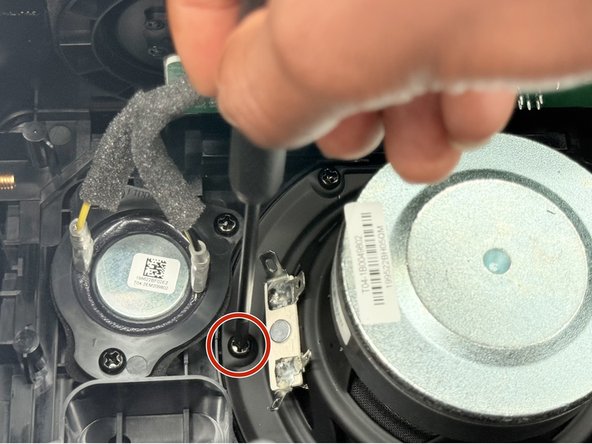

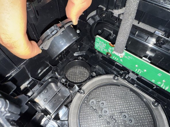

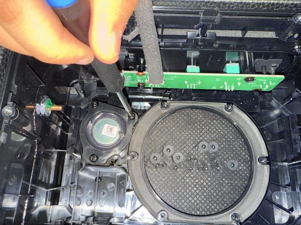

  10. Marshall Kilburn II Tweeters Replacement: crwdns2935265:010crwdnd2935265:01crwdnd2935265:03crwdne2935265:0 Marshall Kilburn II Tweeters Replacement: crwdns2935265:010crwdnd2935265:02crwdnd2935265:03crwdne2935265:0 Marshall Kilburn II Tweeters Replacement: crwdns2935265:010crwdnd2935265:03crwdnd2935265:03crwdne2935265:0
    • Identify the tweeter inside the speaker box, on the left side of the main speaker.
    • Disconnect the two connectors connected to the tweeter by pressing on the tabs and pulling up.
    • On the opposite end of the two connectors, disconnect the red connector, connected to the back cover of the speaker by pressing on the tab and pulling up.
  11. Marshall Kilburn II Tweeters Replacement: crwdns2935265:011crwdnd2935265:01crwdnd2935265:03crwdne2935265:0 Marshall Kilburn II Tweeters Replacement: crwdns2935265:011crwdnd2935265:02crwdnd2935265:03crwdne2935265:0 Marshall Kilburn II Tweeters Replacement: crwdns2935265:011crwdnd2935265:03crwdnd2935265:03crwdne2935265:0
    • Use a Phillips #1 screwdriver to remove all three 4 mm screws holding down the tweeter.
    • After removing all three screws, gently lift the tweeter out of its housing.
