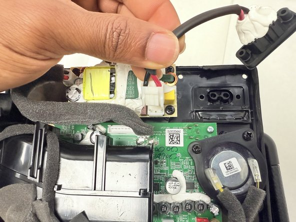

    • Slightly lift up the back cover of the speaker just enough to be able to see the inside compartment of the speaker.
    • Take care not to strain the attached cables.
    • You can use an opening tool to help pry up the back cover from the sides if the back cover doesn't lift up easily.
    • Lift the back cover just enough to be able to see the inside compartment of the speaker.
  4. Marshall Kilburn II Charging Port Replacement: crwdns2935265:04crwdnd2935265:01crwdnd2935265:03crwdne2935265:0 Marshall Kilburn II Charging Port Replacement: crwdns2935265:04crwdnd2935265:02crwdnd2935265:03crwdne2935265:0 Marshall Kilburn II Charging Port Replacement: crwdns2935265:04crwdnd2935265:03crwdnd2935265:03crwdne2935265:0
    • Locate the battery, which is attached on the inside bottom left corner. Refer to image 1.
    • Identify the black cable that connects from the battery to the back cover of the speaker.
  5. Marshall Kilburn II Charging Port Replacement: crwdns2935265:05crwdnd2935265:01crwdnd2935265:02crwdne2935265:0 Marshall Kilburn II Charging Port Replacement: crwdns2935265:05crwdnd2935265:02crwdnd2935265:02crwdne2935265:0
    • Grip the white battery connector and pull it directly out of its socket.
    • Remove the battery by pulling the battery up out of its housing.
    • You will need to cut the white zip tie which holds the battery cable and the other cables together.

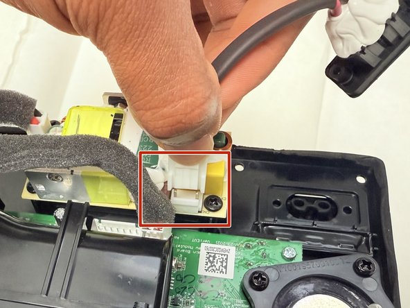

  6. Marshall Kilburn II Charging Port Replacement, Charging Port: crwdns2935265:06crwdnd2935265:01crwdnd2935265:03crwdne2935265:0 Marshall Kilburn II Charging Port Replacement, Charging Port: crwdns2935265:06crwdnd2935265:02crwdnd2935265:03crwdne2935265:0 Marshall Kilburn II Charging Port Replacement, Charging Port: crwdns2935265:06crwdnd2935265:03crwdnd2935265:03crwdne2935265:0
    • Disconnect the charging port by pressing the white tab and pulling up on the end of the cable connected to the back cover of the speaker.
    • Replace the charging port.
