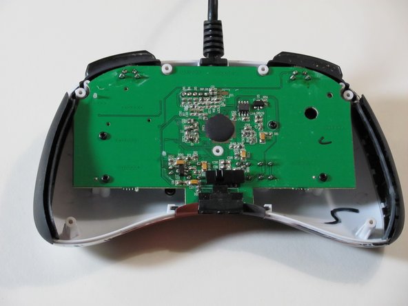

    • Use a plastic opening tool to separate the rear and front casing by inserting it in-between the two cases.
    • Use the plastic opening tool to pry the two cases apart.
  4. Mad Catz Street Fighter IV FightPad USB Cable Replacement: crwdns2935265:04crwdnd2935265:01crwdnd2935265:02crwdne2935265:0 Mad Catz Street Fighter IV FightPad USB Cable Replacement: crwdns2935265:04crwdnd2935265:02crwdnd2935265:02crwdne2935265:0
    • Remove the two rubber side grips.

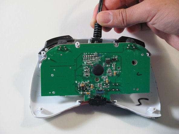

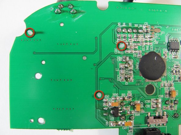

  6. Mad Catz Street Fighter IV FightPad USB Cable Replacement, Circuit Board: crwdns2935265:06crwdnd2935265:01crwdnd2935265:01crwdne2935265:0
    • Locate the four 8.3 mm Phillips screws on the circuit board and remove them.
  7. Mad Catz Street Fighter IV FightPad USB Cable Replacement: crwdns2935265:07crwdnd2935265:01crwdnd2935265:03crwdne2935265:0 Mad Catz Street Fighter IV FightPad USB Cable Replacement: crwdns2935265:07crwdnd2935265:02crwdnd2935265:03crwdne2935265:0 Mad Catz Street Fighter IV FightPad USB Cable Replacement: crwdns2935265:07crwdnd2935265:03crwdnd2935265:03crwdne2935265:0

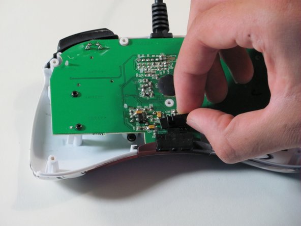

    • Hold the controller cable at the area just before it meets the controller and slowly lift upwards to slide it out of its plastic slot and remove the circuit board.
    • Be careful with the wires connected to the circuit board itself as they are thin and delicate.
    • When reassembling the controller, make sure that the bottom plastic piece is fully inserted into its slot before replacing the circuit board.

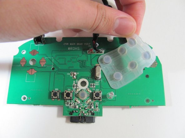

    • Orient the motherboard so that the side with the rubber buttons is facing up.
    • Remove the rubber buttons by pulling up on the on the rubber pad on the points where the rubber cylinders that poke through the motherboard are so that each cylinder slides out nicely.
    • Removing the rubber buttons is optional but recommended to do before soldering.
