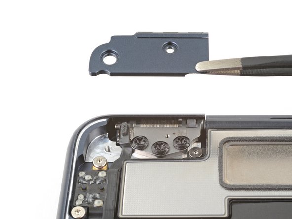

  29. Macbook Air M2 2022 Touch ID Sensor Replacement, Unfasten the left hinge cover: crwdns2935265:029crwdnd2935265:01crwdnd2935265:02crwdne2935265:0 Macbook Air M2 2022 Touch ID Sensor Replacement, Unfasten the left hinge cover: crwdns2935265:029crwdnd2935265:02crwdnd2935265:02crwdne2935265:0
    • Use a 3IP Torx Plus driver to remove the 2.6 mm screw securing the left hinge cover.

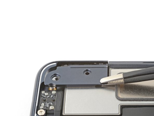

  30. Macbook Air M2 2022 Touch ID Sensor Replacement, Remove the left hinge cover: crwdns2935265:030crwdnd2935265:01crwdnd2935265:03crwdne2935265:0 Macbook Air M2 2022 Touch ID Sensor Replacement, Remove the left hinge cover: crwdns2935265:030crwdnd2935265:02crwdnd2935265:03crwdne2935265:0 Macbook Air M2 2022 Touch ID Sensor Replacement, Remove the left hinge cover: crwdns2935265:030crwdnd2935265:03crwdnd2935265:03crwdne2935265:0
    • Grip the left hinge cover with blunt nose tweezers.
    • Pull the cover toward the bottom of the laptop and upward to free it from its recess.
    • Pull up and remove the hinge cover.

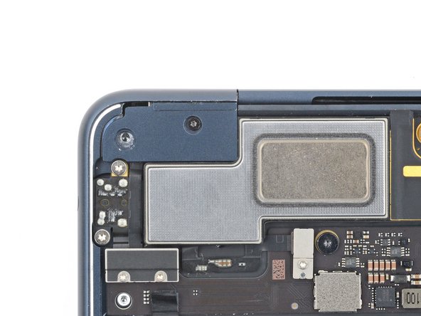

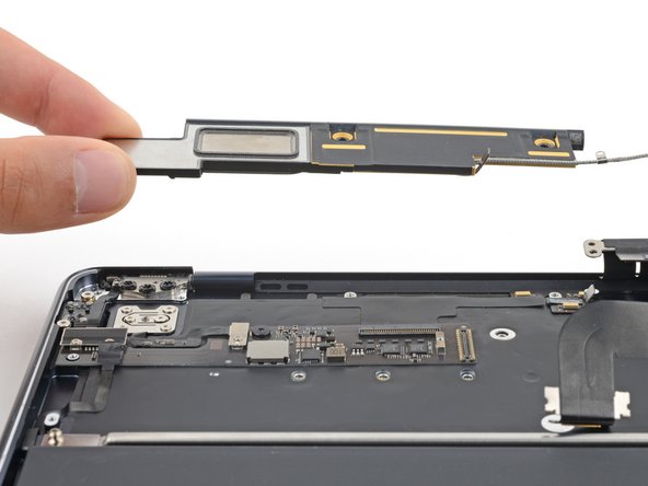

  31. Macbook Air M2 2022 Touch ID Sensor Replacement, Unfasten the right speaker: crwdns2935265:031crwdnd2935265:01crwdnd2935265:02crwdne2935265:0 Macbook Air M2 2022 Touch ID Sensor Replacement, Unfasten the right speaker: crwdns2935265:031crwdnd2935265:02crwdnd2935265:02crwdne2935265:0
    • The right speaker will be on your left-hand side when working on the MacBook, as it's laying upside down.
    • Remove the three screws securing the right speaker:
    • Two 5.6 mm 4IP Torx Plus screws
    • One 3.5 mm T5 Torx screw
  32. Macbook Air M2 2022 Touch ID Sensor Replacement, Remove the right speaker: crwdns2935265:032crwdnd2935265:01crwdnd2935265:02crwdne2935265:0 Macbook Air M2 2022 Touch ID Sensor Replacement, Remove the right speaker: crwdns2935265:032crwdnd2935265:02crwdnd2935265:02crwdne2935265:0
    • Lift the right speaker straight up and remove it.

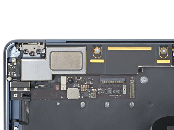

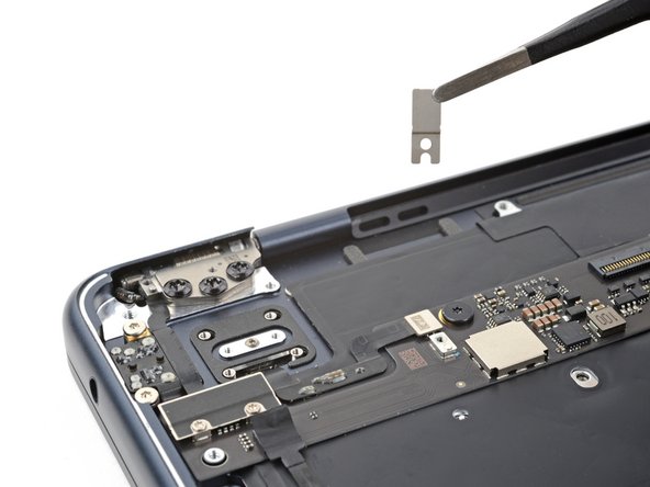

  33. Macbook Air M2 2022 Touch ID Sensor Replacement, Remove the covers: crwdns2935265:033crwdnd2935265:01crwdnd2935265:02crwdne2935265:0 Macbook Air M2 2022 Touch ID Sensor Replacement, Remove the covers: crwdns2935265:033crwdnd2935265:02crwdnd2935265:02crwdne2935265:0
    • Use a T3 Torx screwdriver to remove the 1.5 mm‑long screw securing the Touch ID sensor connector cover.
    • Remove the cover.
  34. Macbook Air M2 2022 Touch ID Sensor Replacement: crwdns2935265:034crwdnd2935265:01crwdnd2935265:01crwdne2935265:0
    • Use a T3 Torx screwdriver to remove the six screws securing the Touch ID sensor and its bracket:
    • Four 2.0 mm screws
    • Two 1.7 mm screws

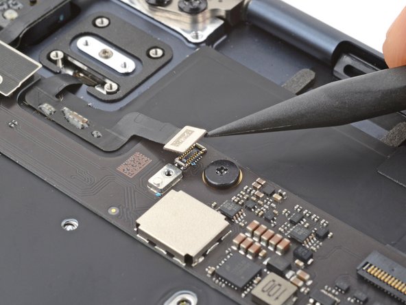

  36. Macbook Air M2 2022 Touch ID Sensor Replacement, Disconnect the Touch ID sensor: crwdns2935265:036crwdnd2935265:01crwdnd2935265:02crwdne2935265:0 Macbook Air M2 2022 Touch ID Sensor Replacement, Disconnect the Touch ID sensor: crwdns2935265:036crwdnd2935265:02crwdnd2935265:02crwdne2935265:0
    • Use a spudger to pry up and disconnect the Touch ID sensor press connector from the daughterboard.

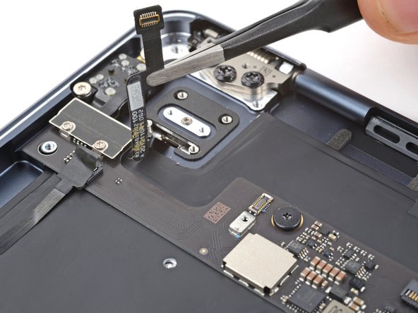

  37. Macbook Air M2 2022 Touch ID Sensor Replacement, Separate the cable adhesive: crwdns2935265:037crwdnd2935265:01crwdnd2935265:02crwdne2935265:0 Macbook Air M2 2022 Touch ID Sensor Replacement, Separate the cable adhesive: crwdns2935265:037crwdnd2935265:02crwdnd2935265:02crwdne2935265:0
    Tesa 61395 Tape
    $5.99
    • Light adhesive secures the Touch ID sensor cable to the frame.
    • Use tweezers or your fingers to peel the Touch ID sensor cable from the frame.
    • During reassembly:
    • If your new Touch ID sensor's cable comes with adhesive, remove the plastic liner and press the cable into place on the frame.
    • If the cable doesn't have adhesive, use a strip of double-sided tape such as Tesa Tape to secure it to the frame.

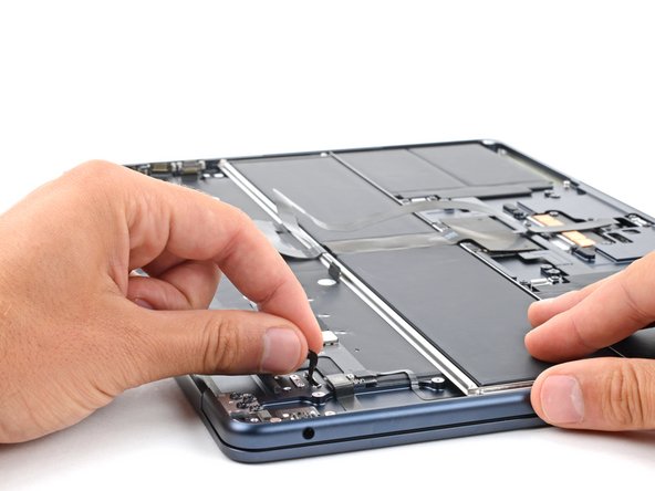

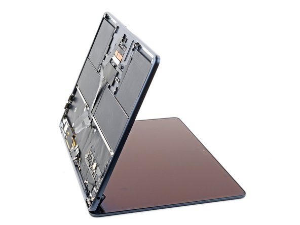

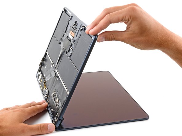

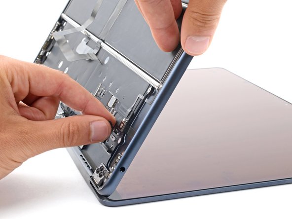

  38. Macbook Air M2 2022 Touch ID Sensor Replacement, Open your MacBook: crwdns2935265:038crwdnd2935265:01crwdnd2935265:03crwdne2935265:0 Macbook Air M2 2022 Touch ID Sensor Replacement, Open your MacBook: crwdns2935265:038crwdnd2935265:02crwdnd2935265:03crwdne2935265:0 Macbook Air M2 2022 Touch ID Sensor Replacement, Open your MacBook: crwdns2935265:038crwdnd2935265:03crwdnd2935265:03crwdne2935265:0
    • Open your MacBook until the main body stands up on its own.

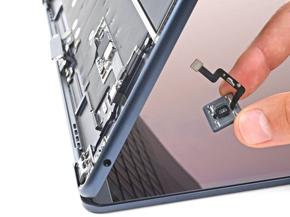

  39. Macbook Air M2 2022 Touch ID Sensor Replacement, Remove the Touch ID sensor: crwdns2935265:039crwdnd2935265:01crwdnd2935265:02crwdne2935265:0 Macbook Air M2 2022 Touch ID Sensor Replacement, Remove the Touch ID sensor: crwdns2935265:039crwdnd2935265:02crwdnd2935265:02crwdne2935265:0
    • Pull the Touch ID sensor away from the frame while guiding the cable through its slot.
    • Remove the sensor.
  40. Macbook Air M2 2022 Touch ID Sensor Replacement, Reassembly information: crwdns2935265:040crwdnd2935265:01crwdnd2935265:03crwdne2935265:0 Macbook Air M2 2022 Touch ID Sensor Replacement, Reassembly information: crwdns2935265:040crwdnd2935265:02crwdnd2935265:03crwdne2935265:0 Macbook Air M2 2022 Touch ID Sensor Replacement, Reassembly information: crwdns2935265:040crwdnd2935265:03crwdnd2935265:03crwdne2935265:0
    • Guide the new Touch ID sensor's cable through its slot in the fame.
    • Make sure the cable is properly oriented so the press connector lines up with its socket.
    • Hold the cable with one hand and use your other hand to align the new sensor in its recess.
    • Once the sensor is aligned, gently pull the cable away from the MacBook to secure the sensor against the frame.
    • Continue holding the sensor in place by its cable and slowly close the MacBook.
