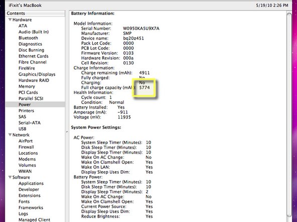

    • Lo and behold, the new battery works in the A1342!
    • Both of these screenshots were taken from the previous iteration, the MacBook Unibody A1342.
    • You can get an extra 350 mAh of juice if you're willing to add 7.5 grams to your "older" MacBook.

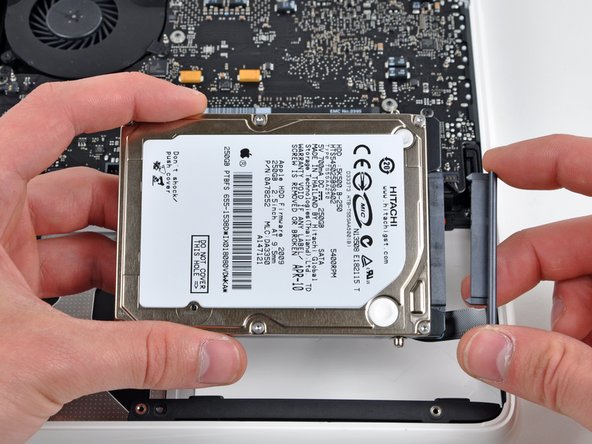

    • After removing two Phillips screws and the hard drive bracket, lift the drive out of the MacBook by its pull tab and disconnect the SATA connector.
    • If you're installing a new hard drive, you'll need a T6 Torx screwdriver to transfer the mounting screws to your new hard drive.

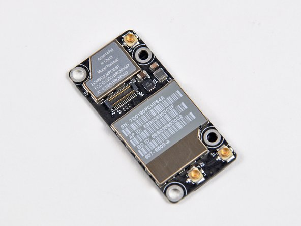

    • Removing the speaker assembly and AirPort/Bluetooth board requires a bit of work, but nothing we at iFixit can't handle.
    • Bluetooth model number is BCM943224PCIEBT.
    • This is the same card used in the previous model, the A1342.

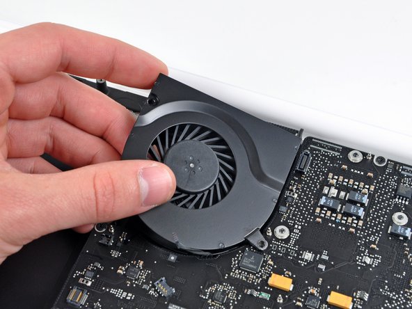

    • Removal of the fan was no biggie. It simply required a Phillips screwdriver and a spudger.
